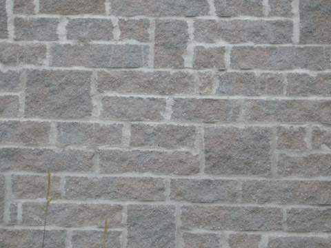

Heres a sort of third option.
When I wanted to start the brickwork on my house when I discovered that bricks are 6 months+ backlog around Toronto. My bricklayer suggested a product call Soltice Stone (spelling?) which is a brick material made of concrete. The 'bricks' are split so they look like stone blocks (really they do!). Because they are made of concrete they don't fall apart like bricks do.
However, they cost about 50% more /forums/images/graemlins/shocked.gif , even though delivery was 2 days after order.
However, because the average stone/brick is much bigger than a real brick, the labor cost was much lower. So the net cost to me for a premium product and a premium look was more or less the same as 'plain old brick'. /forums/images/graemlins/cool.gif
You might ask some brick layers about the total costs ...

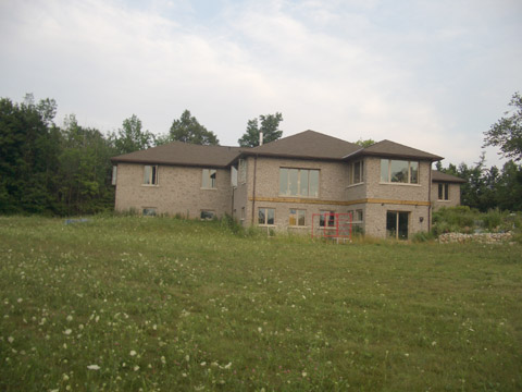

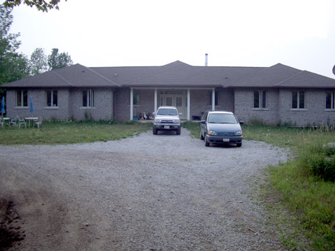

   / Brick vs Stacked Stone #14
Its a bit of a mess - its still a work in process.
I paid for the excavation, concrete work, and brickwork.
Everything else I did myself (usually alone)
From the front
   / Brick vs Stacked Stone #15
From the back
Scaffolds are there in prep for the deck I'm gonna start later this summer. (an excuse to get a drill ..)

Finally a closeup of the 'brickwork'
I've been taking it easy lately - the 'boss' ordered me to build a barn but I cheated and subbed out the construction. I did all the wiring, insulation, and walls myself, though.
Before I get to the deck I'm gonna try finish the master bathroom (talk about money ... /forums/images/graemlins/crazy.gif).
I'm amazed my wife put up with this. I still have about 1,500 sq feet unfinished flooring and most of the paint is still just primer.
