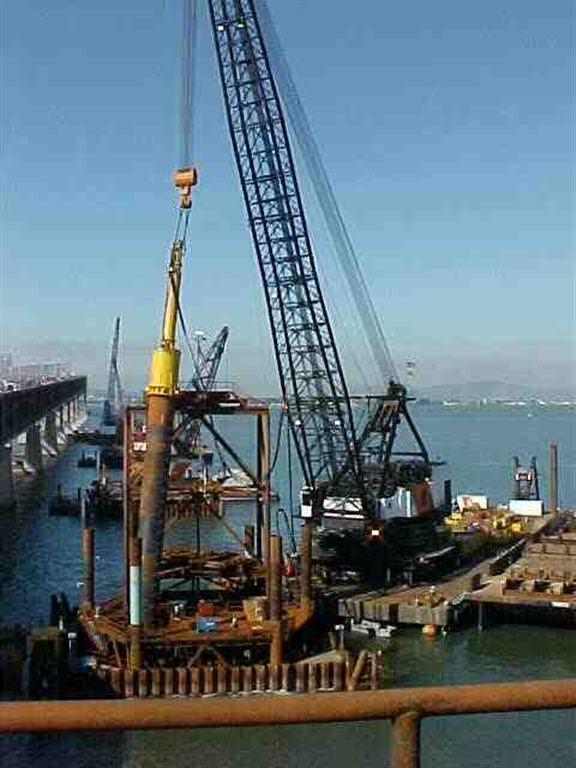

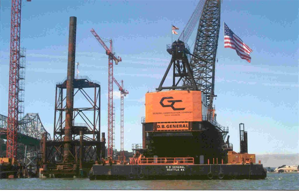

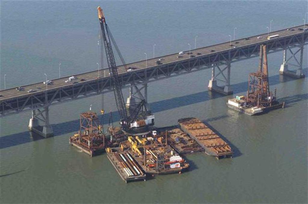

Oh those are toys:D. I worked with this derrick a lot. 1000-tons. The heel of the boom is 40-feet wide. The boom weighs 100-Tons.

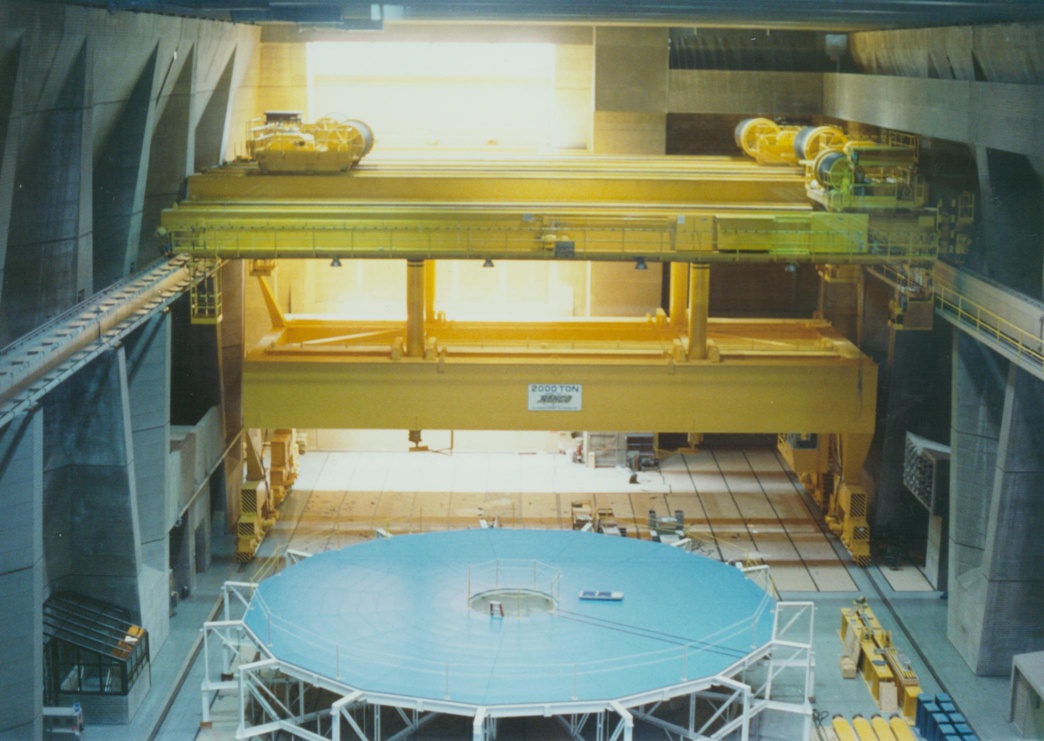

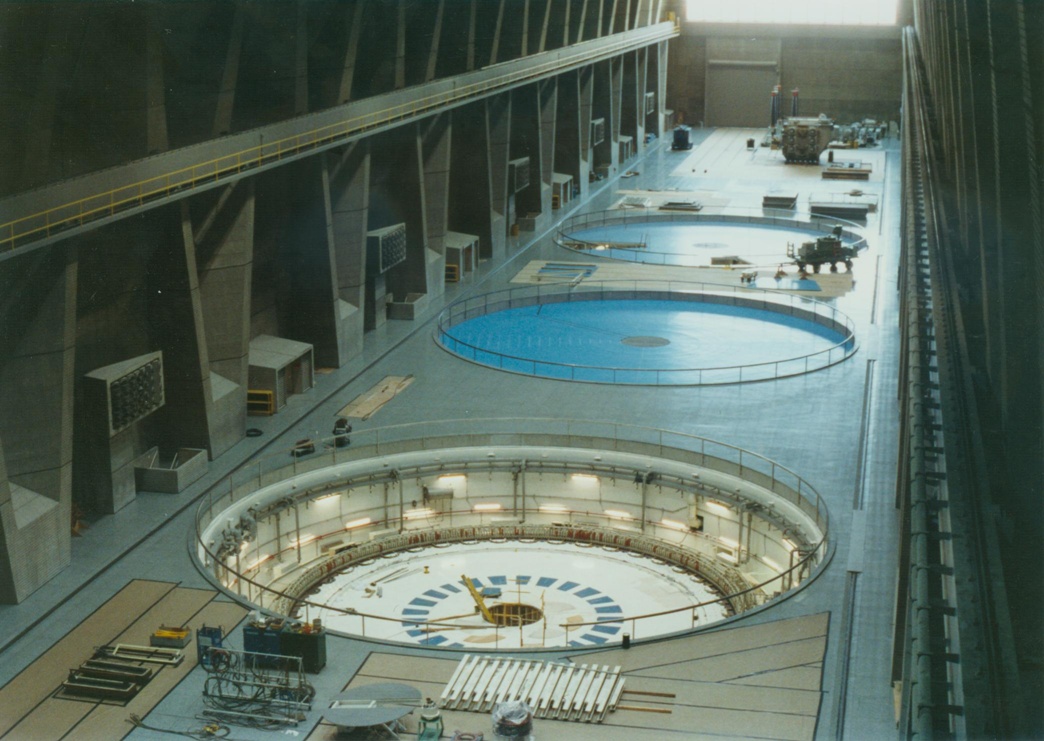

Just for fun, here's the 2000 ton crane at the third power house at Grand Coulee dam.

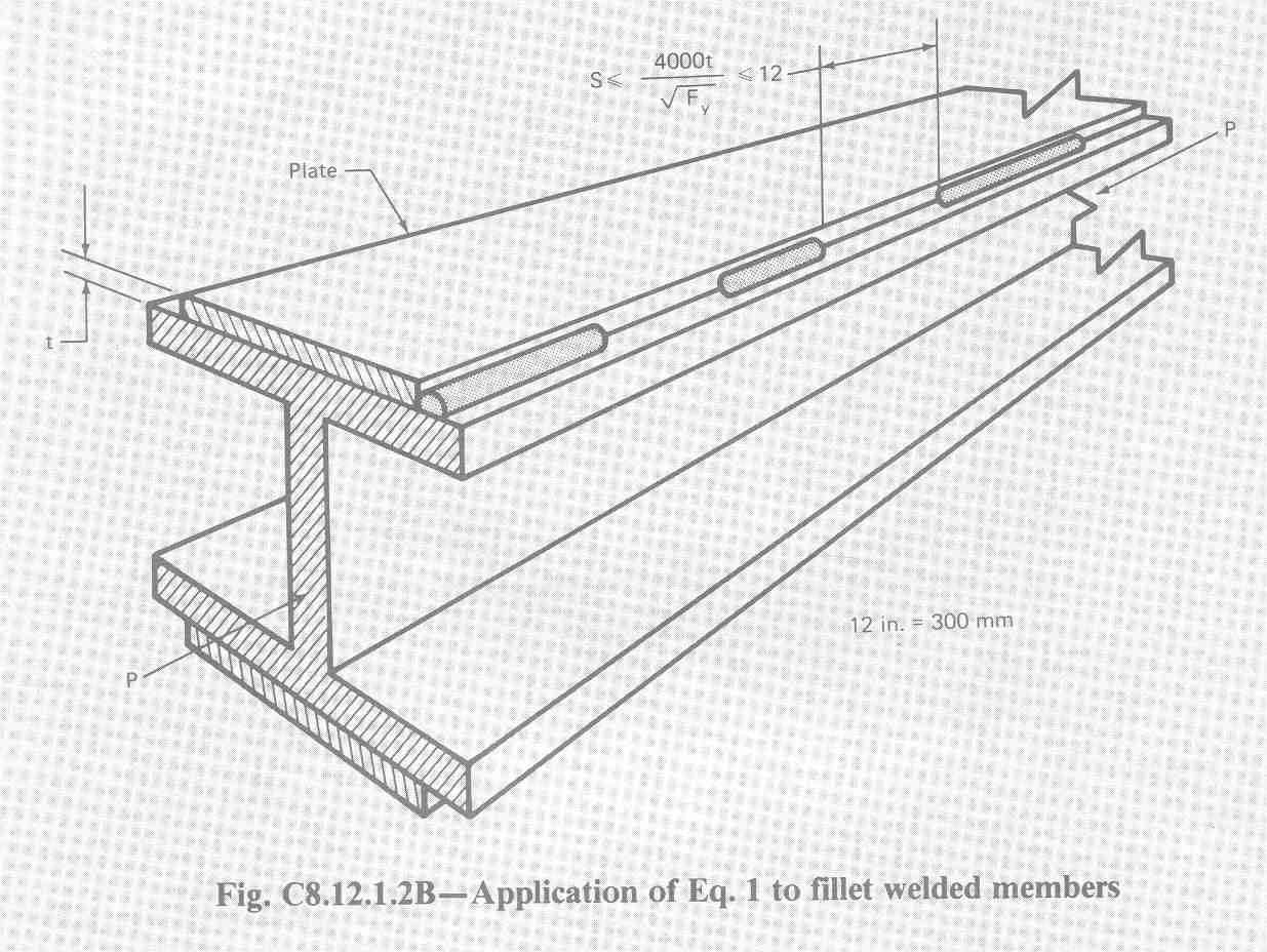

I had a 12" x 31.8# S-Shape from another bridge crane. I used it, and bought more for the rails for this bridge crane. The posts are 20-feet apart. Mike said those beams are the weak link. With the electric chain fall all the way to one end of the span beam, and with the span beam in the center of the posts I could only pick 1-Ton, with a 3/1 safety factor. With the span beam placed right at a post, and the chain fall in the center of the span beam I could pick 2-tons, with 3/1 safety factor.
No I never seen that done before. I don't see why it wouldnt work. All the big bridge cranes I've seen over the years had a horizontal truss for the span beam.

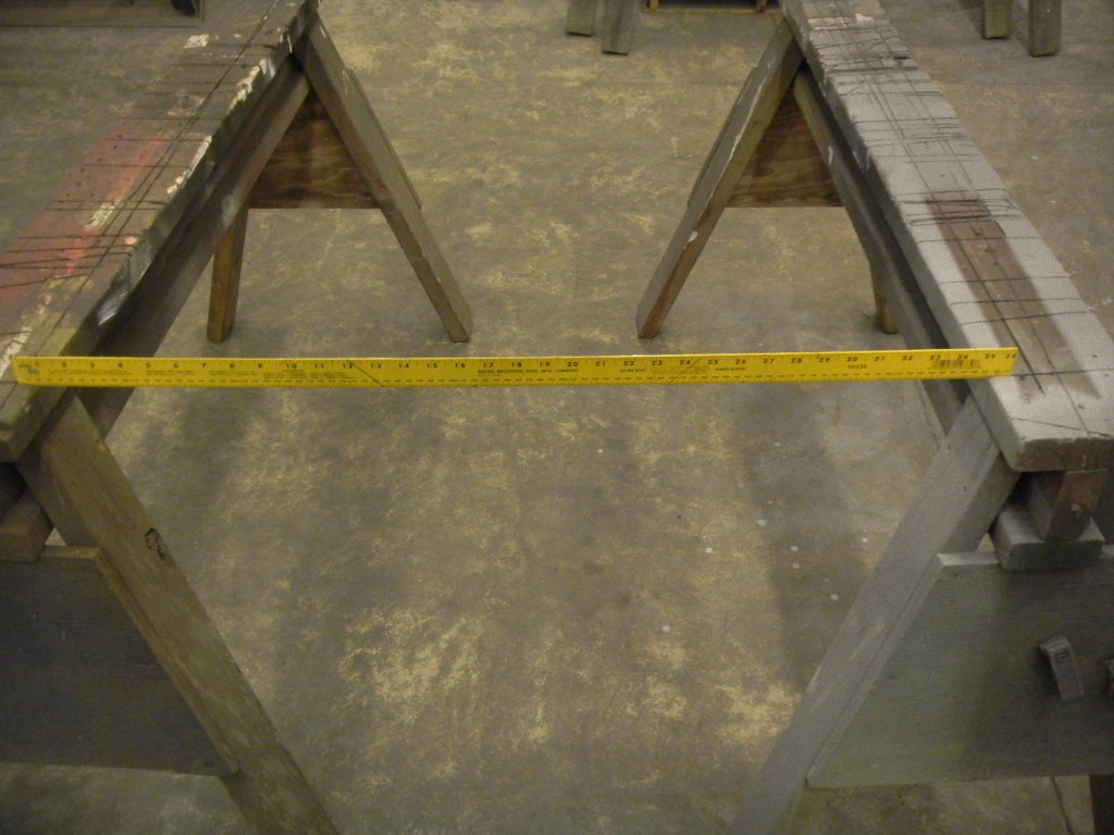

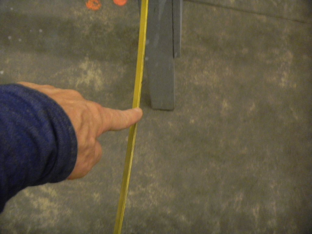

Remember when a beam fails, its the flange that buckles first. Thats why a Wide Flange is stronger than an S-shape.
Example: Push down on a yard stick, it bows to one side before buckling. Larger the flange less likely this will happen. You could always double up on the flanges of a beam to help it. Done this thousands of times.
This is lateral torsional buckling that I was talking about. If you put bracing along the yardstick it wouldn't do that.
