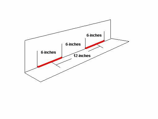

How would the two beam attach to each other? Bolted , continuous weld, intermittent weld
This would affect the strength
I would skip weld it. Most likely go with 6 on 12 weld, and back step it.

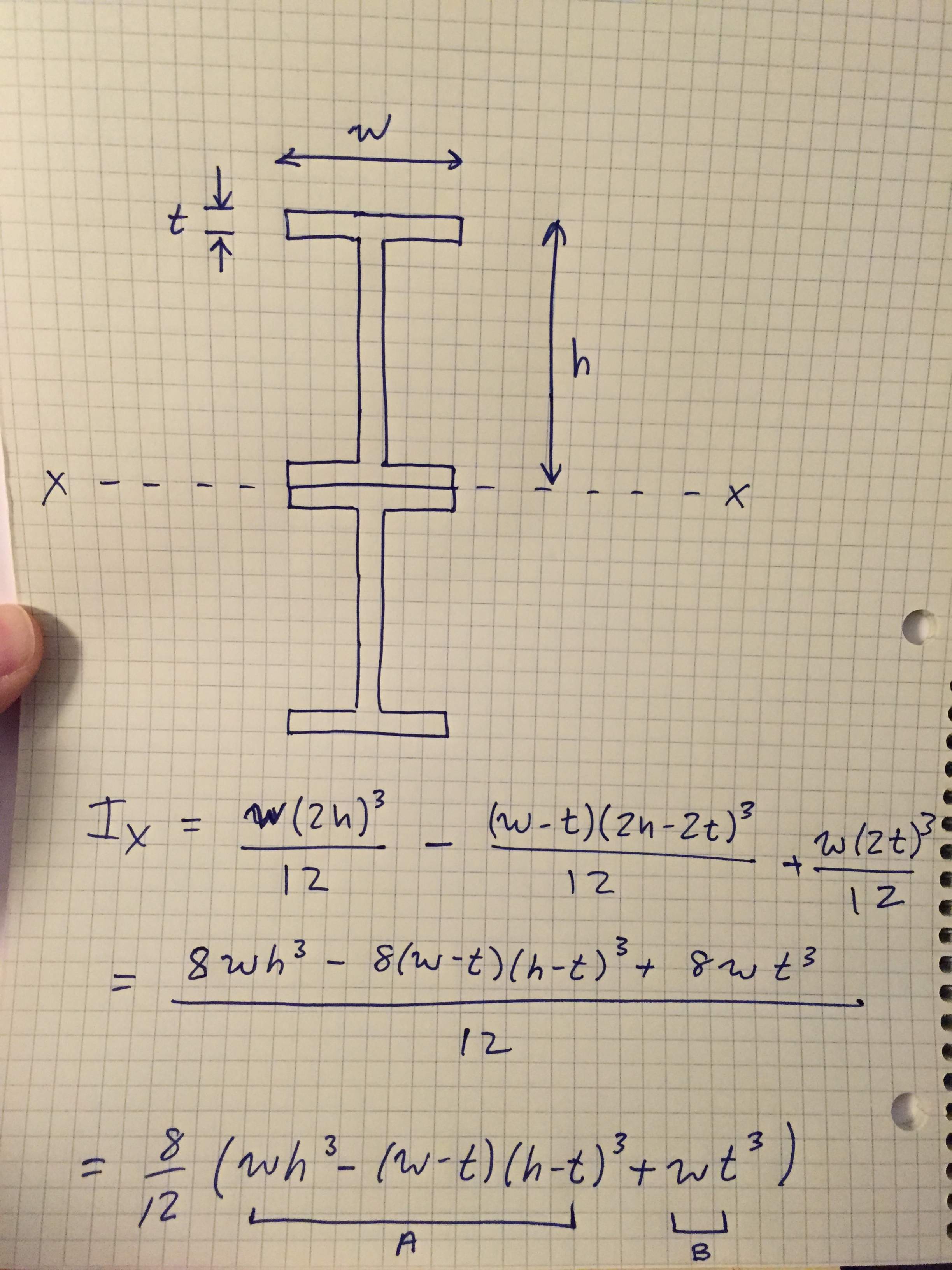

Well, if you guys want to make life easier on yourselves, it's just integration -- simple calculus. I don't bother remembering beam formulas (other than simple ones) knowing I can quickly derive them on the fly. My head doesn't have room for all the recipes in the cookbook, so I just remember how to cook from scratch.
Another way you can do complex shapes is to do a full area and then delete the air. So for example, you can compute for an i-beam by doing the full rectangle and then delete the air on each side of the web. For two stacked i-beams, do the full rectangle and then delete the 4 sections of air.
Take advantage of symmetry and just do half the beam (split vertically) and then double the answer.
Parallel axis theorem (google it) can be used to shift moment of inertia from one axis to another. So you can compute about the central axis of the simple shape parts and then transfer to the central axis of the complex shape to add in to the total.
For tallish i-beams where the flange spacing is much greater than the flange width, I bet two stacked beams (assumed to be joined perfectly) will only be fractionally better than a single i-beam of the same total height and web/flange thicknesses. Reason being is that the two joined flanges in the middle are too close to the central axis to have much of an area moment of inertia about that axis. The best way to get area moment of inertia is to have the area far from the central axis. Stuff close in doesn't contribute as much.
   / Bridge Crane designs and ideas...38' span #85
OK, here's an equation that will work for stacked w-beams of uniform web/flange thickness. Can be modified to an i-beam with a little work, or to accommodate different web/flange thickness.
To get this I did the full rectangle, minus the air if the middle flanges were ignored, and then added back in the middle flanges. That allows all moment calculations to refer to a single central axis and lets us do a comparison at the end.
In the final answer, terms "A" would be for a full w-beam of the same total height. The "B" term is the added area moment from the two flanges in the middle, so it gives the contribution of stacking the beams.
   / Bridge Crane designs and ideas...38' span #86
So as an example, with h=10", w=3", and t=0.25", the stacked beams give Ix=300.8 in^4. A single beam of the same total height as the stack (so same but no flanges in the middle) has Ix=300.7 in^4. Essentially no real difference.
Based on this, I think that for tallish i-beams or w-beams where the height is 3X the width or better, you may as well just assume that two stacked/joined beams are more or less the same in bending as a single beam of the same height as the stack. That ought to really simplify your calculations.
Again, this assumes the stacked beams are joined perfectly, or in such a way that the joint isn't an issue. You should be able to calculate what type of bolting or welding is required to meet that assumption. Along the central axis of the beam, all the loads are shear loads; there is no tension/compression.

Parallel axis theorem.....just the missing piece I was looking for.
Found this....nice video https://www.youtube.com/watch?v=WDdkdC1sFQQ
Working out the numbers for the following....
W12x65 beam
Wf = 12.000
Tf = .605
Tw = .390
Height = 12.1
I come up with Ix = 519 Pretty close. Beam is actually listed at 533 due to the radius I didnt account for. But proved to myself the formula works.
Adding a W6x12 beam underneath...
Wf = 4.00"
Tf = 0.280"
Tw = 0.230"
Height = 6.03"
Ix all by itself... 22.1
Stacking them I get Ix = 759. And in reality probably closer to 800 since I didnt account for the radius where web meets flange.
Dont really gain anything in the way of lifting capacity though.:thumbdown: If I use Bending stress as the ultimate limiting factor. Keeping it 5:1 for safety limits max stress to 7200psi. Adding height to the beam dont do any favors in that department since the beam height (or rather 1/2 the beam height c) is part of that equation.
But what it does do is decrease deflection by about 50%.
Results...single W12x65 beam, 38' span, 5k load in the middle....~6650psi stress, 0.634" deflection
Stacked beams same load and span.........................................~6800psi stress, 0.434" deflection
