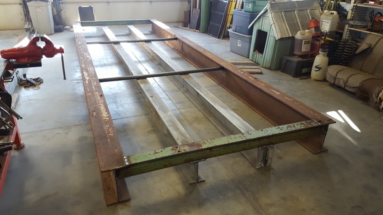

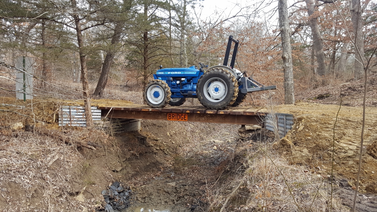

I've got two bridges in my timber.
The first is an ATV bridge that easily handles that task. I made it too narrow for a larger tractor or offroad buggy to get on. Purposely.
The second is wide enough to cross with any vehicle I own. For that reason I made it strong enough to handle any vehicle I own.
Over build once and have a long term bridge. Under build once and have a disaster.

Assuming that fabrication picture is of the bridge structure assembly shown upside down.
Nicely done!
What about the dog house?
When ya gonna fix that?

Hey Richard, what did you use for headers under each end of that very sharp bridge. Poured concrete, laid up stone, or what? I am in the thinking stages of a bridge like that for a summer project.
gg
/ Bridge question #19
gg
Gordon, I used slabs of concrete from sidewalks etc on one end, stacked. The other end had a solid vertical bank. There I used a large slab of limestone that I dragged in place.
/ Bridge question #20
Thanks ! I was hoping you would say something other than poured concrete. Mine will be down in the woods a ways and I would like to avoid that. Side walk slabs is a good idea !
