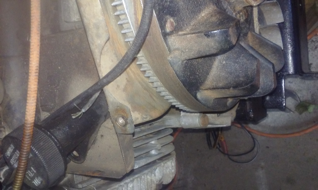

Got the fly wheel cleaned up. But there is a wire running up from the motor by the oil dipstick. Any ideas that that could cause the
problems??

Cleaning a rusty mag coil/magnet makes one feel good but a little rust on those components have no affect on magnetic flux. It is really helpful if you post engine model numbers. ASSUMING you may have a flathead opposed twin, 40 series engine, are you sure you installed the coil correctly? Plug wires exit coil heading towards the back of engine, double back in opposite direction coming out then on carb side of engine where plugs are.

Yes i do have that style. Sorry about not positing earlier
Can you explain what you mean a little more. I did the the shorter spark plug wire to the closer plug

That wire, if it runs under the flywheel is the generator wire with a diode in it. Sounds like your coil is grounding out. When I overhauled my Dad's 16 hp B&S twin in his Gilson, I ripped the coil out and put in electronic ignition.

Can you go into more detail about the wire and the coil grounding out

You should have a wire from under the flywheel to the coil. Find that wire and see if it is grounding out. If I remember right............that wire goes to the switch to kill the engine. Also, after watching this Youtube video here......https://www.youtube.com/watch?v=PfRP4QW2ppE I remember the air gap on the coil is important. Very important. Did you check your points and their gap. This link might help..........Replacing the ignition
If you got to remove the flywheel.............they can be stuborn. I bent/broke a couple of pulley pullers on it. I finally bought a B&S twin flywheel puller. Even then it took a lot of pounding on the edge of the flywheel.

Oh yeah...that wire should run from the coil to the condenser. When I was younger, my brother and I would sometimes pinch the wire with the cover to the condenser at the points on our mini bike engines.
Electronic ignition would do away with the points and condenser.

It's a electric sssooo I'm guessing that's just there for nothing then

Find where that wire goes. Check to see if it is grounded. If it is, that might be your problem. It would be grounding out the spark. It's really hard to trouble shoot something you can touch while a 1000 miles away.

I tried yup check but i can't find the end cause it goes behind the flywheel
