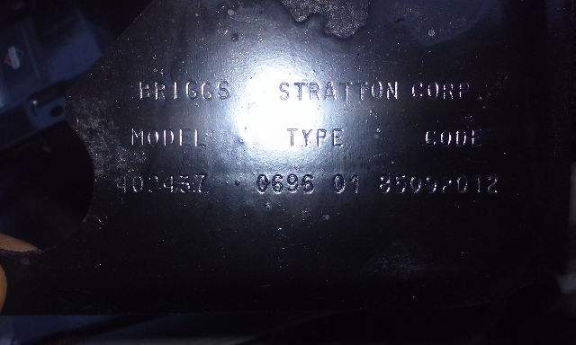

Folks we are getting all confused here. We need the model AND CODE number to know for sure what he has and what wires we are talking about. These engines after early 80s used solid state ignition, no points.
OP - - Assuming this engine is CDI equipped, the coil should be mounted in such a way that the plug wires come out of it heading AWAY from the side where the spark plugs are then they double back 180 degrees and come out the side where the spark plugs are. IF they do not do that, you have the coil on upside down. Still need those numbers.

I have posted once before but here it is again
I must have it upside down

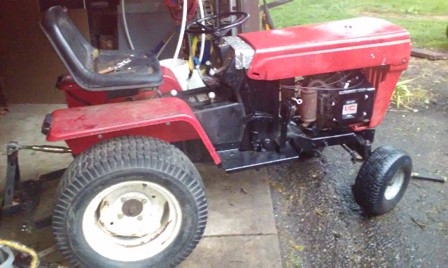

That's the tractor. Been running it with a back blade
