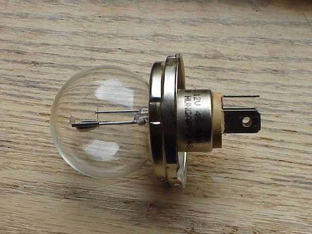

I removed a bulb from my tractor (BX22) and I have no idea if yours is the same, but I know that the traditional 1156 bulb is different than what I have in my tractor. This tractor bulb number is a GE1931 45/40 Watt bulb (see picture). I looked it up on the GE site and it is referred to as a R2 design bulb. The only replacement that I found for the 1931 was R2 Halogen part #52950

My BX23 had a Phillips 1156 bulb in it - the headlight design is somewhat different from the BX22 to BX23 - maybe they used a different bulb. The Autozone I went to had a whole selection of different bulbs - but it sounds like maybe the bulbs Kubota put in the BX22 were higher wattage in the first place than what they put in the BX23.
   / Brighter Headlights BX2200 #9
Didn't look at your picture before I responded - that is definitely not the same bulb that was in my BX23.
