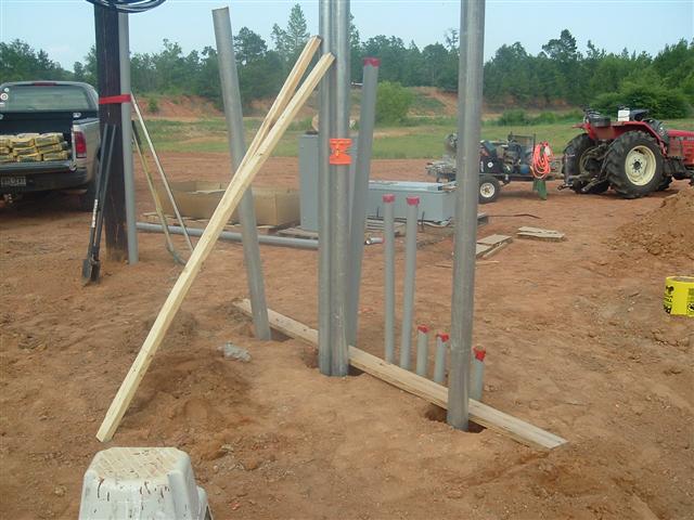

I picked up two sacks of readi mix to finish off the pad. I figured one was plenty, but I'm not taking any chances.
It only took half a sack.
This area will be covered by the disconnect box, which will sit on the pad. The 2 inch conduits will all be cut by the electricians when they install it. I just left them sticking out enough to keep them clear of the concrete.

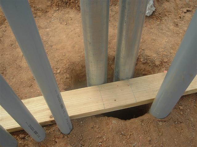

Setting two poles in the same hole was a little tricky. Once I had them level and plumb, I added concrete. This caused one of them to shift. With a full sack in the the hole and two pipes, on correct, the other not, I had to fix it quickly.
This is how it ended up. Not right, but fixable.

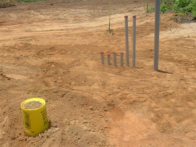

I cut the pipe with my sawzall and put the caps on. Drilled the half inch holes to mount the boxes and removed the forms. Now I'm ready to go.
Now I'm in a waiting game for the electricians to do their part.

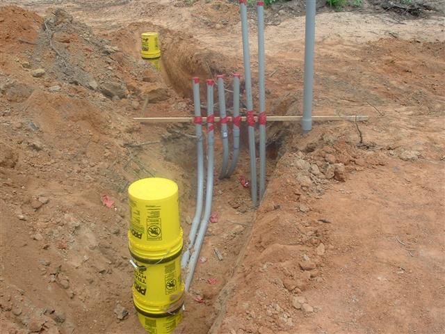

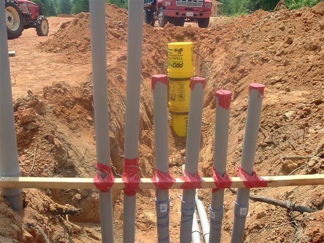

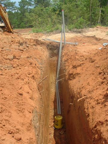

Today is one of those days that could have gone better then it did. I called the electric company and told them I was about ready for them to hook up the line to the meter box and to come inspect the work.
I'd made some changes to the original plan which is my downfall. I know better, but for the long term, a few days of misery will be worth it.
The power company said they'd be out in a few hours to make sure everything is done correctly.
Then about an hour later I get a call from them asking me to explain again the distance and depth of the electrical run, along with the amount of power I'll be pullng.
Here is where it gets interesting. Seems that wire pulling 1,200 amps tends to heat up some and what would have been fine for arial, isn't even close for underground.
The solution is to run three conduits. One each for each wire. Still three inches with 36 inch sweeping 90's.
At first I was a littel upset. Taken back, and at a loss. What to do??? After a few minutes of shut down, my mind turned back on and I came up with a plan.
First step was to cut the concrete to get two more three inch conduits through there.

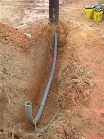

/ Bringing Power In
#52
Then I dug a hole to expose the conduit I'd already buried. I'd hoped to never see this line again. Oh well.
Then a little tunneling under the pad. Then I have to break out the piece of concrete I cut loose. My saw blade is only 7 inches, and the pad is close to 4 inches at the edge.
