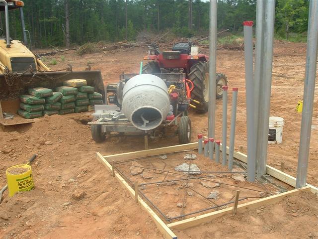

#73
Setting the pipes was simple enough. I need two runs, so that means two pipes.
It's not as ugly as I'd feared, in fact it might be better looking then three pipes coming down hte power pole, then back up into the meter box.
Eddie
