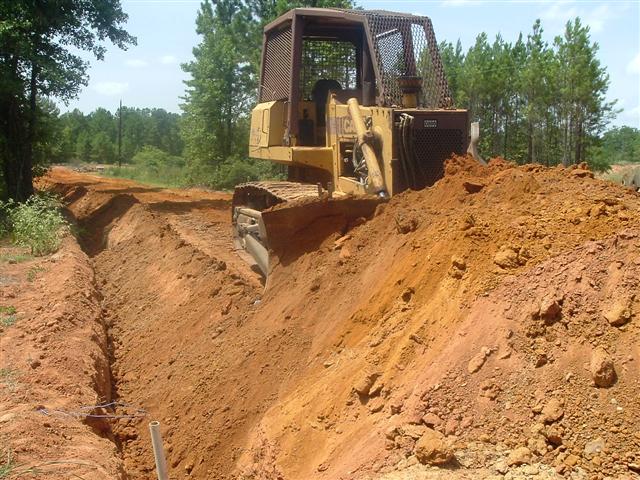

Now I can fill in the trench. FINALLY!!!!
Fortunately I have this handy little tool for doing this. It works really slick, unlike anything else I've ever tried.

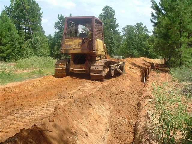

#62
Here's my handy trench filler from the other side. Notice how smoothly it slides the material into the hole. It really is allot of fun to see it happen!! /forums/images/graemlins/grin.gif /forums/images/graemlins/grin.gif /forums/images/graemlins/grin.gif

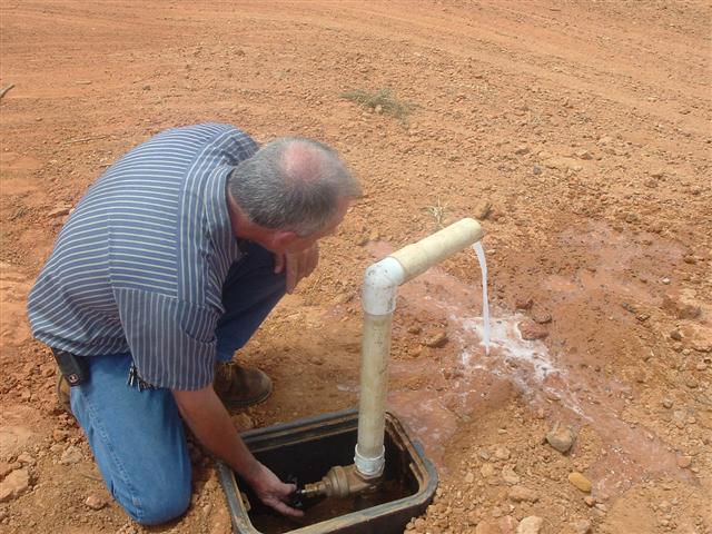

They came out today and preasurized the pipe. It was only turned on a little so to get the air out, then fill with water. It took half an hour until water came out. This is a major step forward!!!
Now I have to let it set for a few days to allow the chlorine granules that I put into every fifth pipe to disenfect the impurities in the pipes.
Monday or Tuesday they will flush the lines and take a sample to the health department for analysis. If it's safe to drink, I'm ready for the next step. If not, then the water department will add more chlorine to the line until it does pass.
Not sure how they do that, but they have there ways. I'm not sweating it since I put so much in there.
