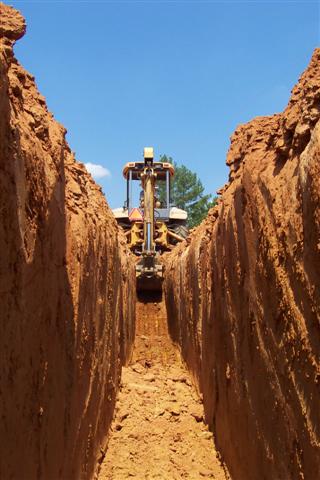

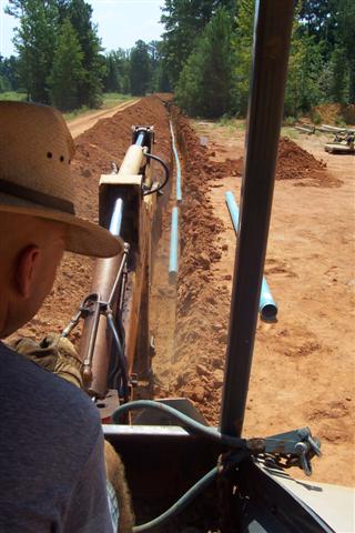

#51
This is the view from the backhoe.

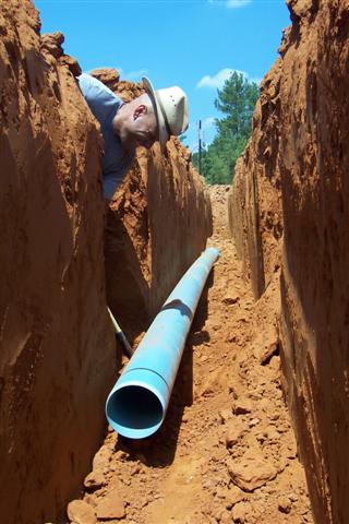

#52
And this is the view from the pipe.

   / Bringing Water to the Park #55
Eddie-
A couple of questions: You mentioned a hydrant in your last post. Are you required to supply your own water via a hydrant? Where is the closest hydrant to your place?
Also, with regard to the trench for the water line- how accurate do you have to be with respect to the bottom of the trench being level? How are you making the trench bottom level?

Bone,
The fire hydrant is a bonus. No requirement to have it, but since I can, I will. The whole idea of it came around from the water department explaining that I'd need a flush valve on the line. That much water will go stale over time and need to be flushed. Basically opening it up and letting several thousand gallons out. The valve set-up is several hundred dollars with the hydrant around a grand.
There are lots of advantages to having a fire hydrant on my land. It will be centralized to the layout of the RV Park if there's a fire. My insurance rates will be lower because of it. And for some personal reason, I just like the thought of having a fire hydrant.
The bottom of the trench just needs to be smooth and flat. There is no requirement for it to be level. I could have used a trencher and followed the contour of the surface which is how the water department does most of their lines. I have a backhoe, so that's what I used.
The water department determined the depth of the trench when they brought the line into my land. I put my bucket down and marked the depth with the bucket open. I just dig most of the dirt away, then drag my bucket teeth over the bottom watching my mark to maintain my depth.
There were a few little bumps that I need to smooth out, but that was loose soil that cleared with my boots.

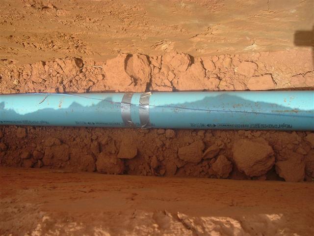

#59
Before I could cover up the pipe, I had to have it inspected so they would know that I slid the joints all the way together and included the tracer wire. I also had to make sure there was dirt all along the bottom of the pipe. No air gaps.
Of course almost as soon as I started, a baby cotton mouth came out from under the pipe. It was only a foot long, if that, so quick work with the shovel. Not a good start to four hours of work. Oh well, at least there was only the one snake.

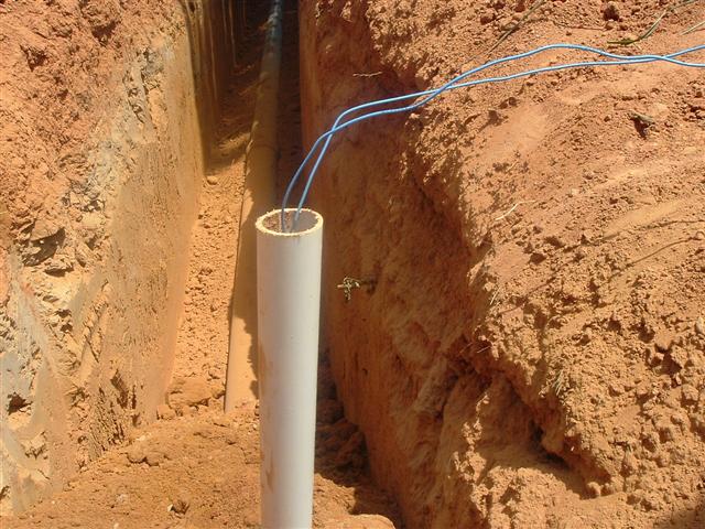

#60
The tracer wire is only so long. This is where it ends and begins again. The water department said to put it inside a 2 inch piece of pipe and cap it near ground level.
