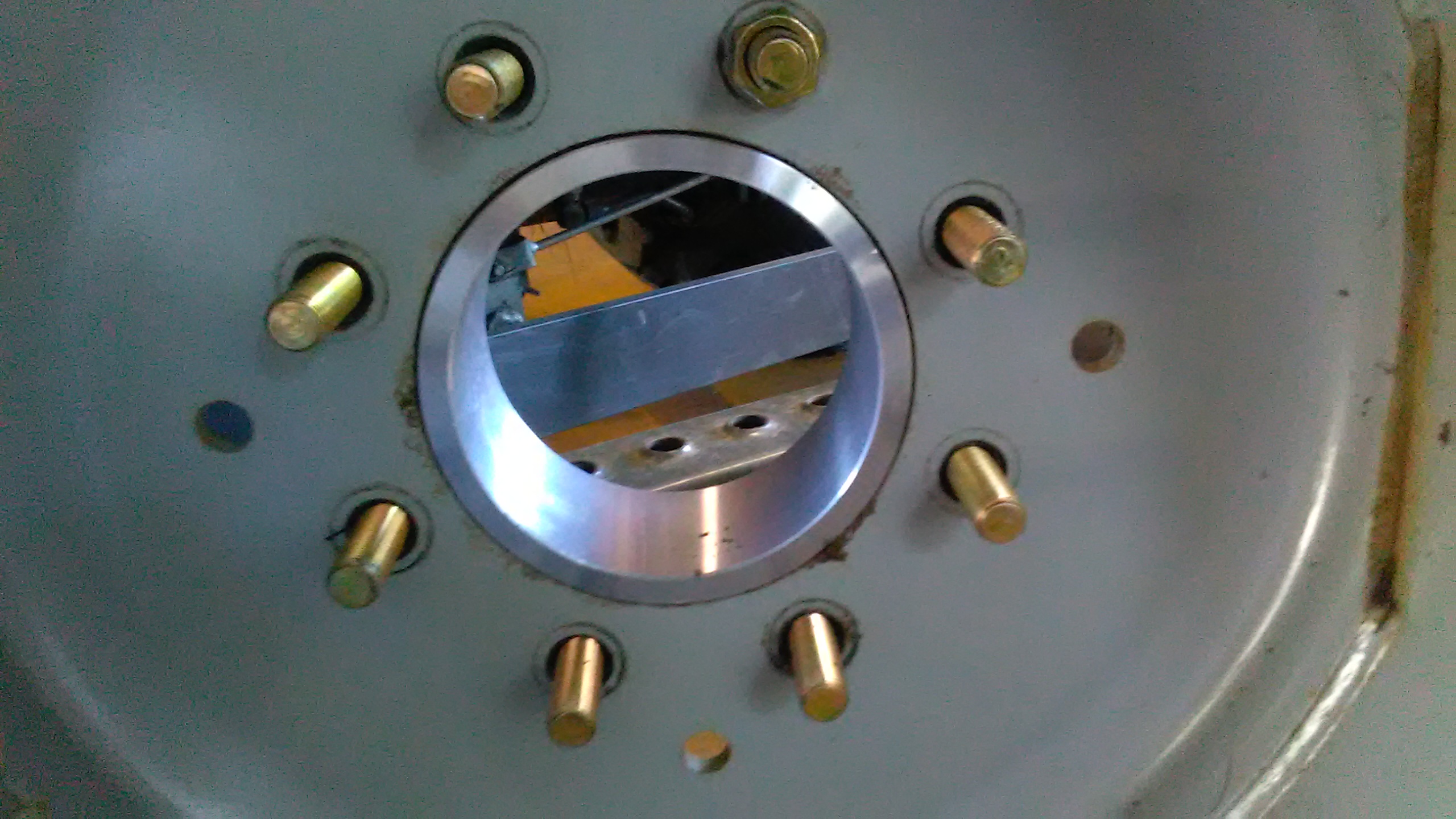

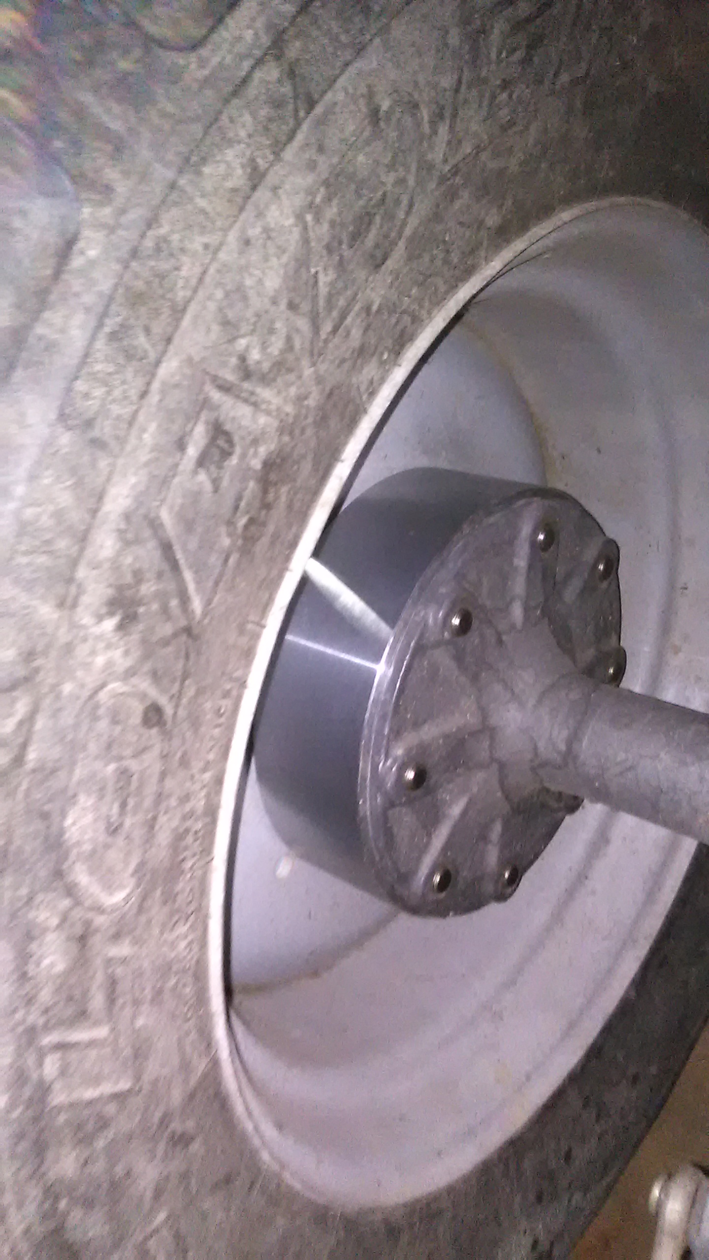

I was think about those yamaha spacers,but the machine work is a PITA, so without removing my rear tire,I wanted to ask ya'll if the lug nuts are a tapered concetric design, this would elimnate the need for a machining a concentric raise portion for the rim seat.

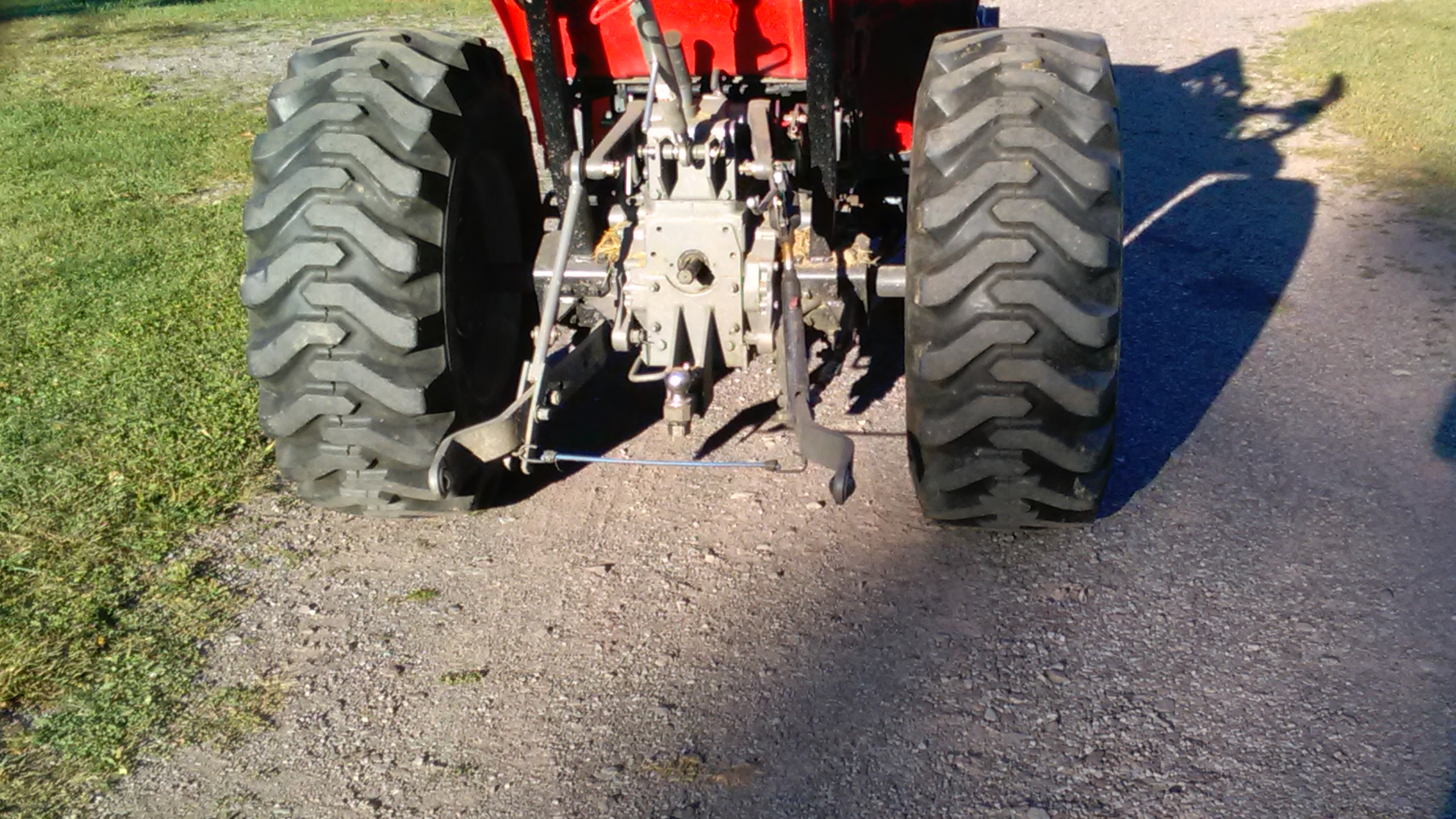

Put the bro-tek 2" spacers on and put the tractor through its paces. Much better feel on my hilly terrain. Thank you Richard!

Just find a machine shop
Just find a machine shop and give them some iron barbells and a wheel pattern B.C. sketch.
Remove old studs and replace with longer ones, they are available. By doing so, you only have 4 or 6 holes to drill.

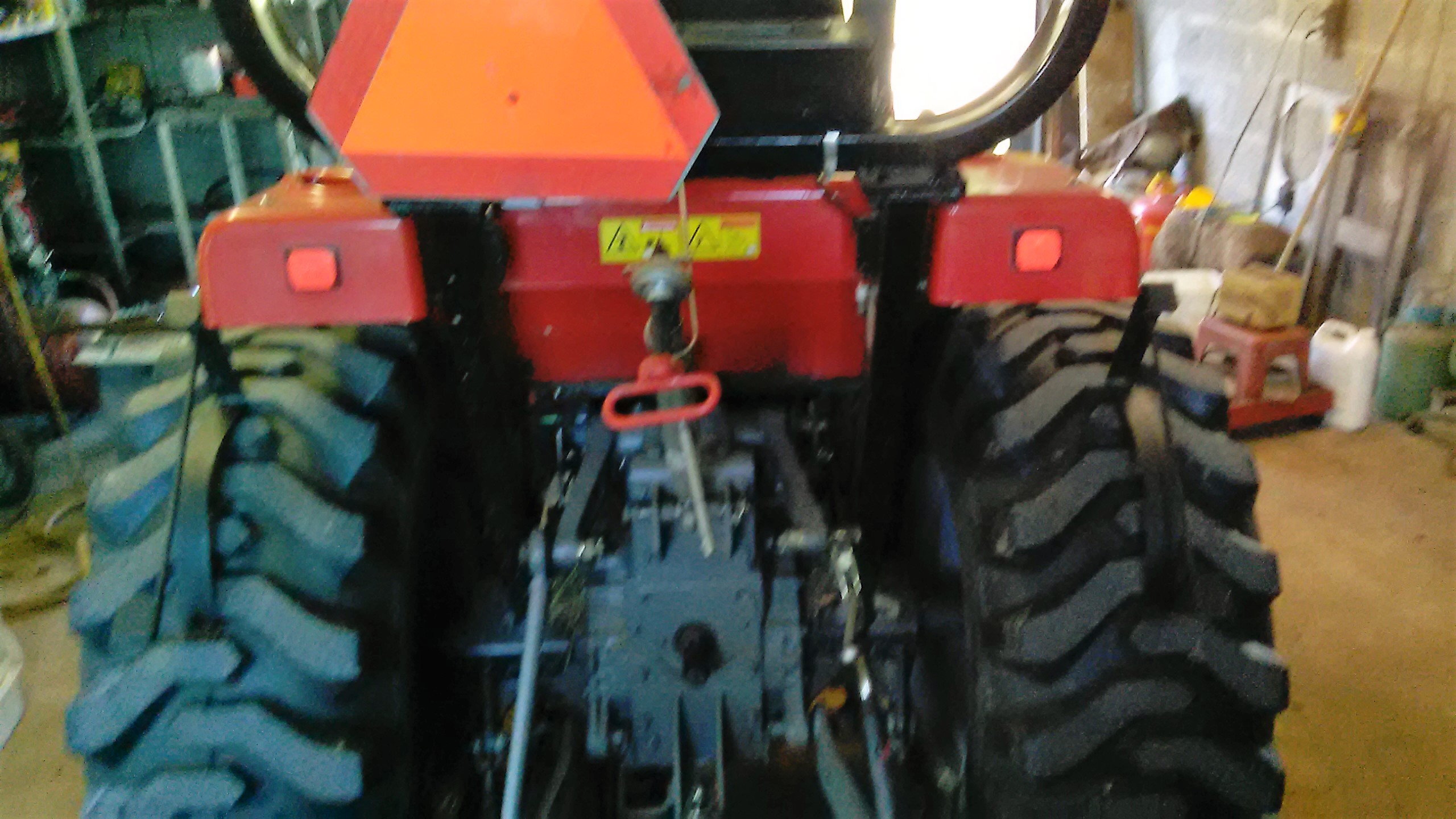

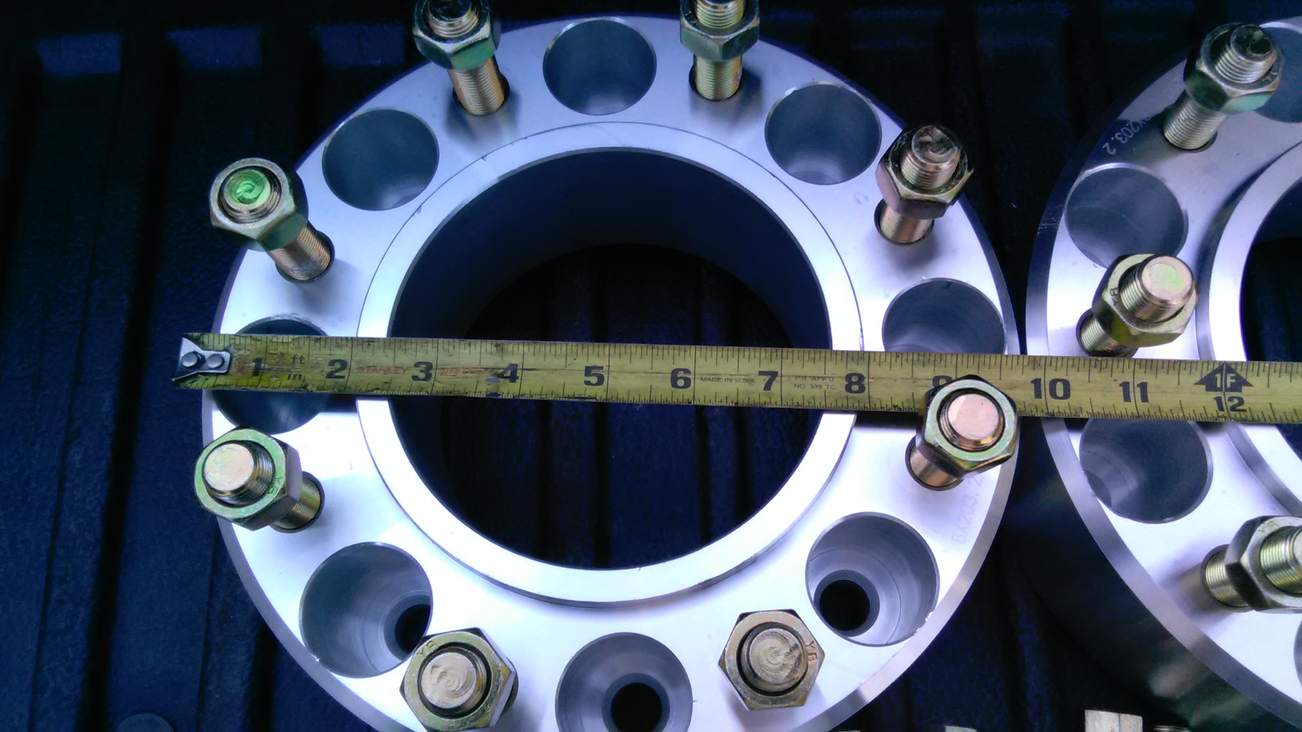

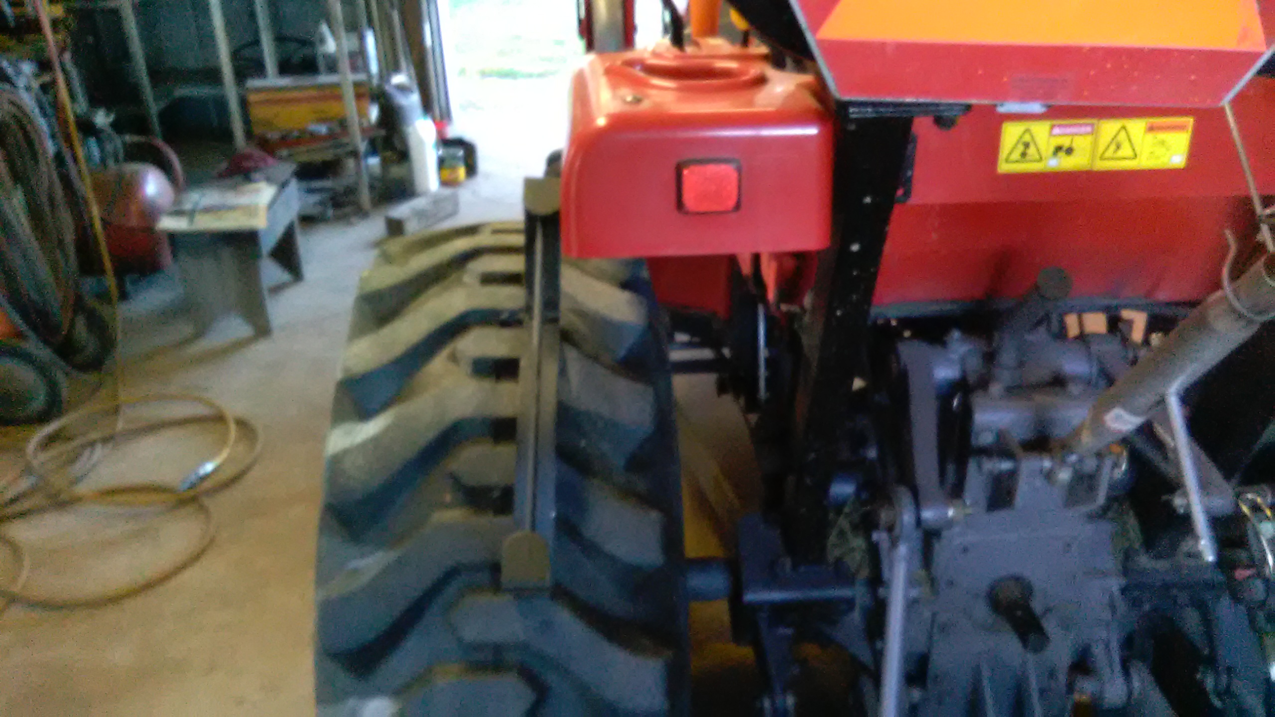

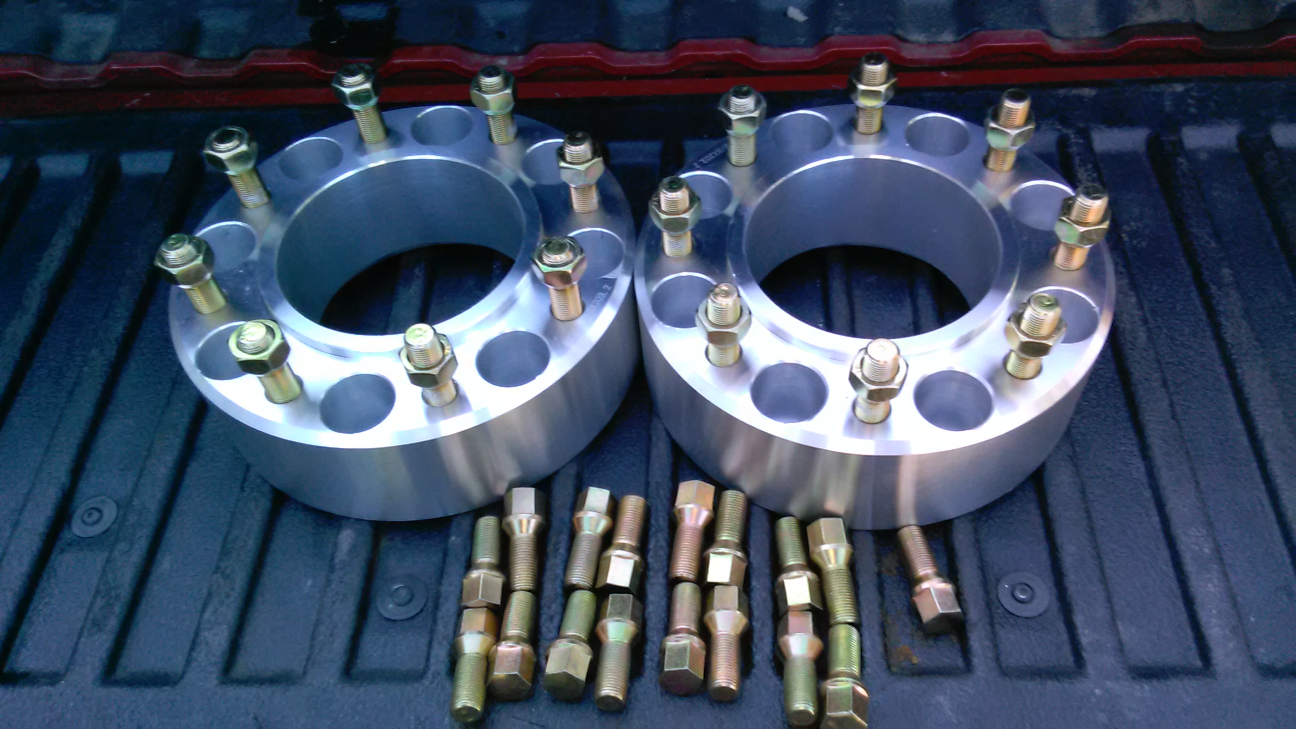

Re: Bro-Tek wheel spacers for M/F 1529
I received my Bro-Tek , 3" wheel spacers, today. They were very nicely machined and fit perfectly, on my M/F 1529. These spacers were probably larger than most, with 8 X 8, 16 mm lugs ... total diameter of about 10". I never felt uncomfortable on my old NAA, but the 1529 was about 6" narrower. ... plus, it has a FEL. I haven't put any time on it, but I'm sure it won't feel like "It's going to fall over", as frequently.
wheel9.jpg wheel10.jpg wheel11.jpg wheel12.jpg wheel13.jpg wheel14.jpg wheel15.jpg wheel16.jpg wheel17.jpg
