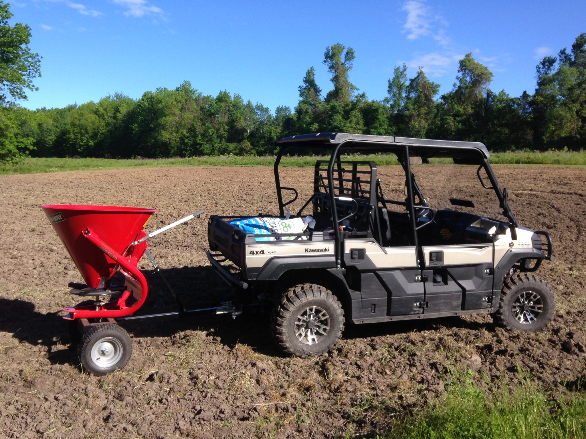

Why are you against a 3 point broadcaster? I have one and used it behind my BX for a couple of years and now behind a JD 2025. I like that you can throttle up or down to control how far you broadcast. They cover a lot of ground in a hurry. Mine looks a lot like the pic above behind the utv but is 3 point.
