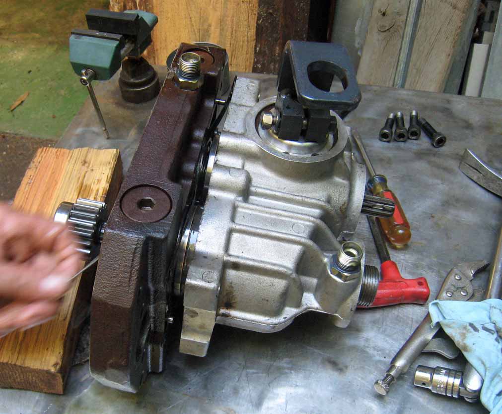

Good photos of a failed GST unit, MHE.
Back when I repaired my Kubota B21, purchased with a bad transmission, I was able to get a quotation
for the HST pump or motor separately. But components of each were not sold separately; the pistons
were all "matched" to the cylinder blocks. I do think that any bad pistons with slippers should have
been replaceable separately, as long as the bores were in spec. Even in a case like yours, as you say.
I did end up buying the charge pump separately cuz the rotor and block showed some wear. In that
HST, the charge pump is on the front of the HST. Other HSTs have it separate.

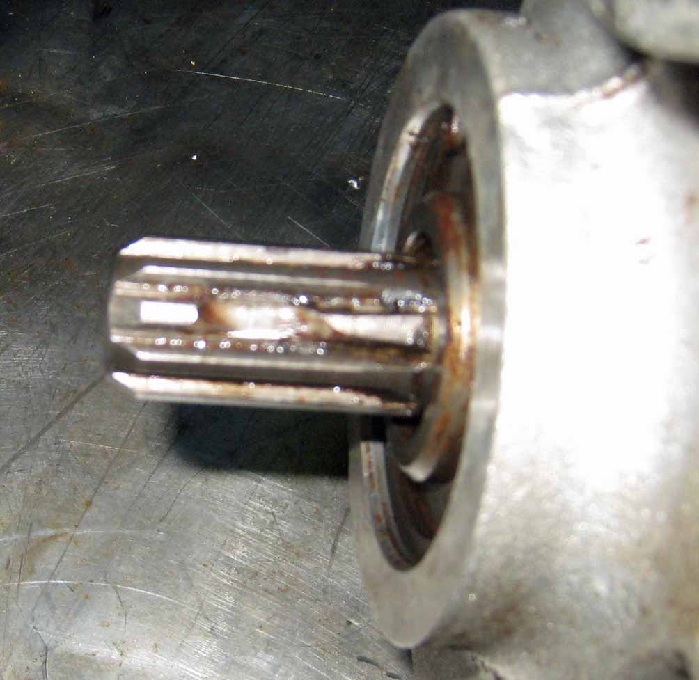

OP here. I'm back home after a really beautiful drive down and back on the coast highway from northwest Washington to just south of Big Sur. Just wow!
The visit with Dkrug was very satisfying indeed. I am sure he is right in his analysis (it was fascinating to watch that analysis develope through the postmortem).
It is now my responsibility to use the knowledge gained here to change my methods/habits so that there is no repetition for me and perhaps avoid such failures for others who read this.
The way I see it, the cavitation was caused over time by oil thinned by excess heat. The likely culprits and remedies are :
The rear remote detent lever. It is almost certain that the tractor ran for extended times with the lever pushed over into full detent position, deadheading the oil flow and creating heat. This process is particularly diabolical because it would have to happen as I climb onto the tractor, sometimes brushing the lever over into detent - then starting the tractor and not noticing the slight lowering of RPM and slight straining of the motor. No relief valve sound to my ear.
So I can't be sure how often or for how long this happened.
Anyway, it won't happen again. I will devise a way of locking it into neutral position and if I have any doubt at all of its effectiveness, I will have a quick connect hose made as described by others.
I will be more conscientious about cleaning the oil cooler.
I will install a temp guage. I'm not sure how yet, but I'll learn.
I will fix the front grill. It won't be pretty.
I will pay more attention to RPMs in future, using more when there is more work to do.
I will lean towards using low gear more often.
I will not use cold weather oil.
Please feel free to add to or modify anything on this list.
I must say it is humbling to find so many errors in my procedures, but if you look at my Original Post, that is just what I was asking for.
I never dreamed that I could get so much specific help, or that it could be so much fun in the process.
I thank you all.

Here are a couple of photos that Susanne took. One is a better look at the broken
spline on one of the shafts.
