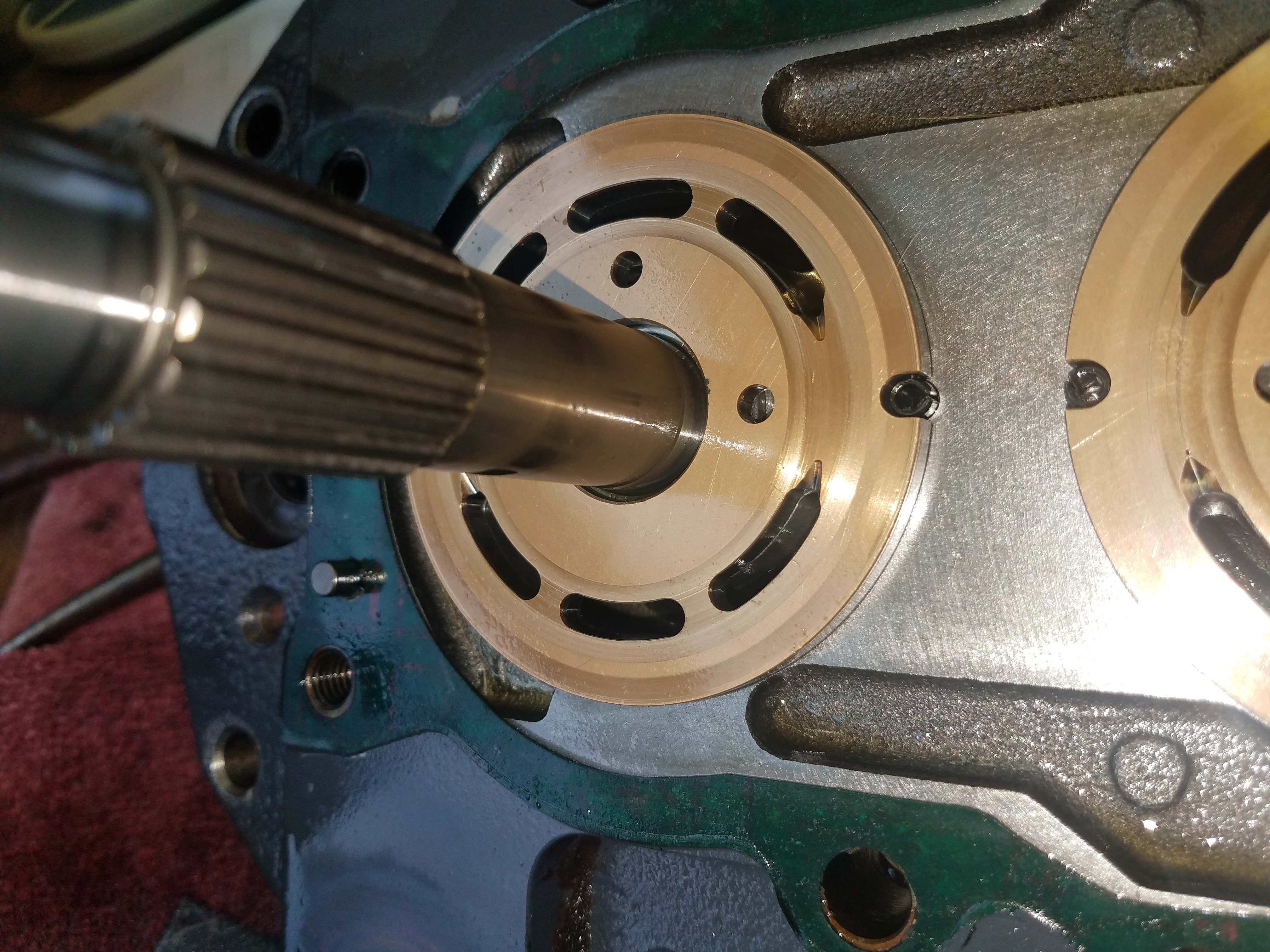

Interesting thread even 2 years after the fact. As others have pointed out, I agree the manual is incorrect. Transmission neutral at full HST pedal is useful to check charge pressure since you would have the additional fluid loss introduced by the motor rotating instead of just the pump. Then put it in gear and stall the HST to check the forward and reverse high side pressures.
As far as the postmortem photos, I'd attempt fixing it. What is the depth of the erosion? If it's not all the way through the brass/copper colored coating, my father an I have resurfaced those plates by wet lapping by hand starting around 150-200 grit emery cloth and slowly working up to 2000 grit crocus cloth until smooth again. Need a very flat surface and even pressure, but aside from a few dollars for emery/crocus cloth the only investment is time. My 4400 was done that way 2 years ago and my grandfather's 400 garden tractor about 20 years ago. I've got about 75 hours on my tractor, his had several hundred last I checked, both running fine.

Hi all... this is a great post. I recently bought one of these tractors, thinking it was a drive shaft problem, it turns out that it's doing the same thing as Bob's tractor did and ,after hours of surfing the internet i found this article and its a good one!! I've gone as far as tearing it down as y'all did and it turns out that mine has the valve plate that is worn like Bob's unit did, so my next question is can that valve plate be ordered some somewhere or be made a made in a shop? The dealer in Michigan tells me that they are a non serviceable pumps is this true? Does anybody know ? I just don't want to buy a $3100 pump if that valve plate is all thats wrong with mine. Thanks in advance!!
   / Broke Hydrostat twice? Why? #177
If you can determine who made the transmission for Kubota and get the correct model number then you can maybe buy the valve plate. Otherwise these are probably considered throw away items in most cases.
I would suspect loss of charge pressure was one of the causes of failure. My BX 1850 had a priority flow control that was supposed to ensure that there was charge flow at all times. If this valve fails or a steering hose breaks you loose charge flow which would start the pump on the path of self destruction.
   / Broke Hydrostat twice? Why? #178
As I mentioned a few posts up, if the plate isn't too bad, lap it and reinstall. Post some pictures, would help to determine how bad it is.
