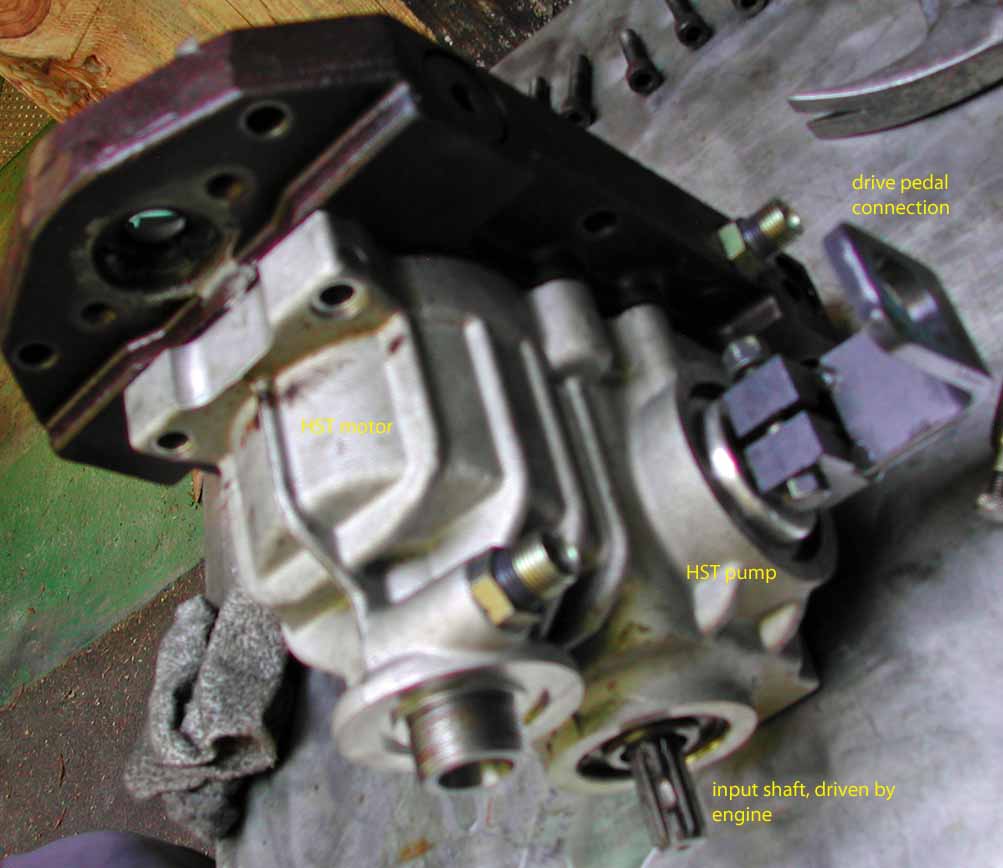

Well, Bob and Susanne stopped by yesterday, and we looked at the innards of his HST.
I will post this weekend on the results.
We had a very nice visit.

At first examination, this unit is similar in size to HSTs on my B21 and JD955s. There
is no integral charge pump, and the swash plate speed pump control is mechanically
linked to the go-pedal.

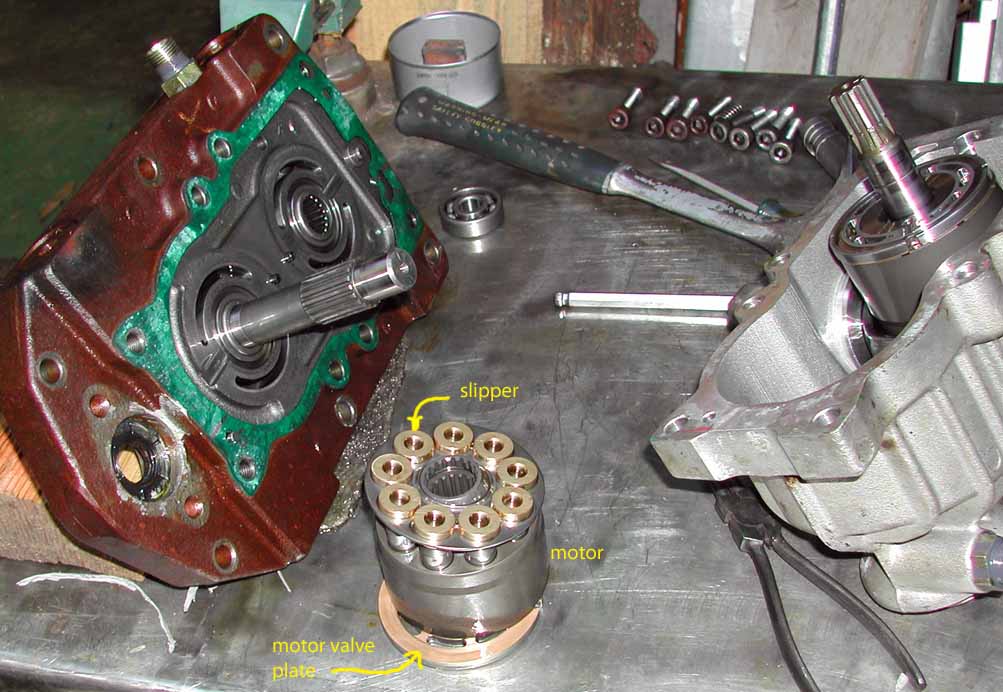

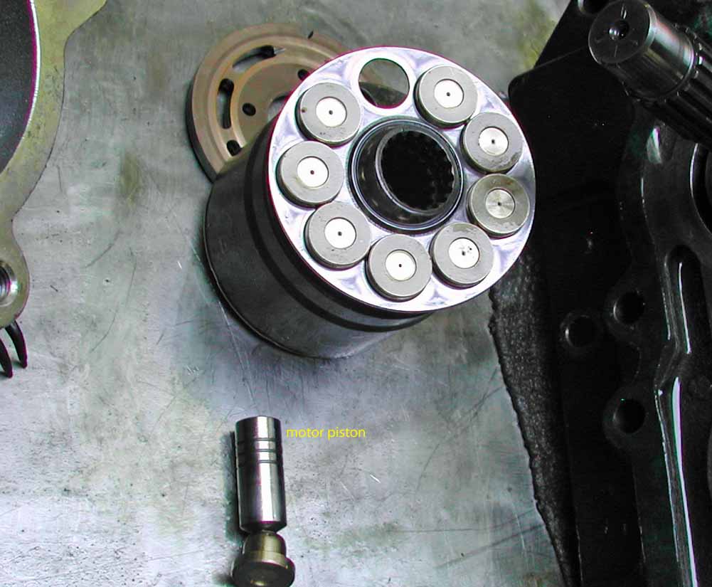

After splitting the case, I first removed the motor (1st, 2nd photos). On first inspection, it
looked OK. The slippers looked smoother than I am used to seeing. Other HSTs
have pre-cut scratches in the slippers to help retain an oil film. I will check the
thickness with a micrometer later, after getting the spec from the manual. All
pistons moved easily in their bores, without any noticable excess clearance.
The fixed swash plate was smooth and completely free of scratches. The valve
plate was slightly scored, failing the fingernail test. Hard to see in our photos.
Not our "smoking gun", however.

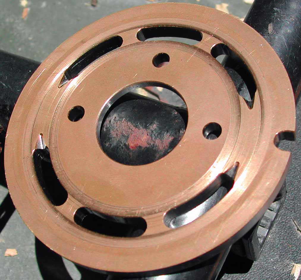

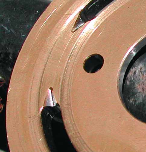

Here are some close-ups of the motor valve plate. It is clearly scored, and that is
not good, but it still worked in reverse.
