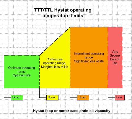

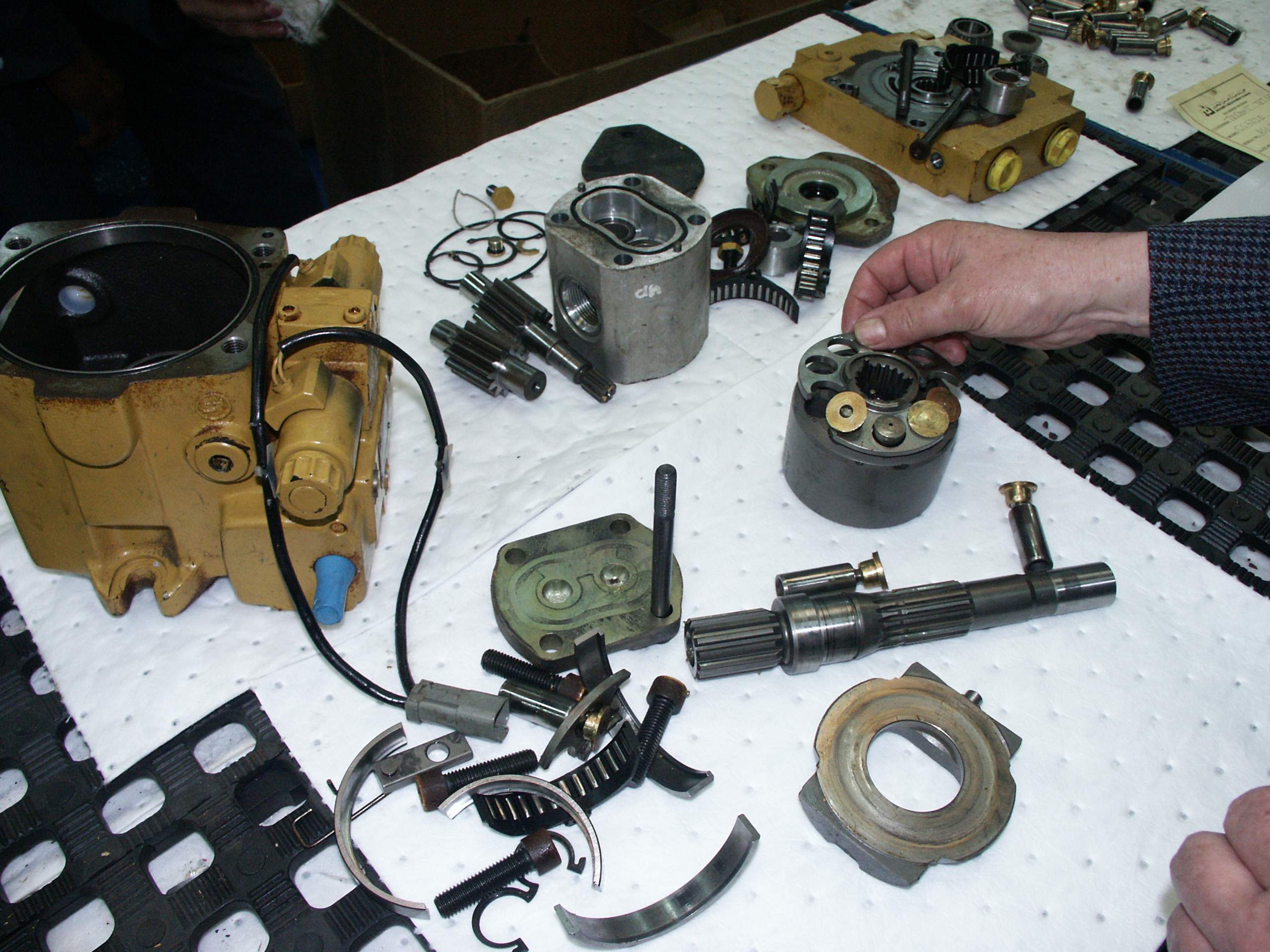

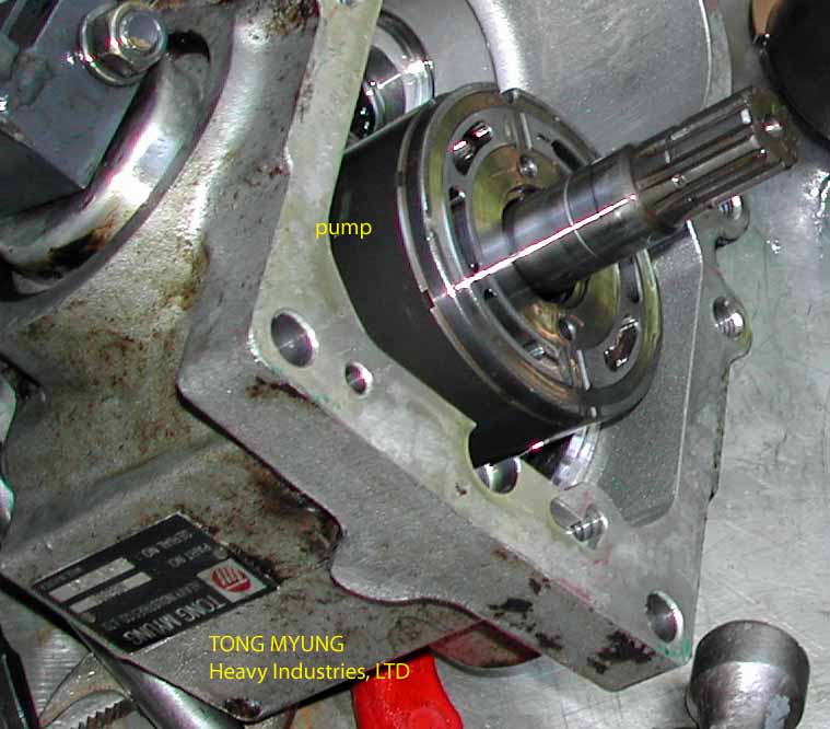

Here are 3 files related to overheating. Thin oil is the most frequent cause of overheating failure. The chart gives you an idea what heat does. Green is the sweet spot, the oil viscosity at which the hydro thrives. Oil selection is to try and keep the oil temperature in the hydro in the green or yellow range under all operating conditions. Oils give viscosity at 100ーC and 40ーC. This chart was made from information collected from the 2 largest hydrostatic transmission builders in the world and may not correlate well with lower cost suppliers but it is a good indicator of what heat does - increased heat = lower operating viscosity = reduced life.
The pictures are of one of 3 hydros from a machine operating in the Persian Gulf in temperatures exceeding 50ーC (122ーF). I had this machine instrumented with 24 thermocouples monitoring oil and air temperatures everywhere. Highest temperature was, as expected, from the case drains. This is the hot oil after it has done all its work. Our system is set to bleed off 2.5 gpm of hot oil from each motor to allow cool oil to enter the main loop from the charge pump. At the temperatures I measured, oil at this point was 4 cSt because it was well beyond 100ーC (I have a chart that extends to the flash point of the oil).
The pictures show what happens to a pump subjected to heat. Note the major problem is the rotating grop. The large picture shows all of the parts we disassembled including the steer pump. Everything was in perfect condition except the pistons, slippers and swash plate. The rotating group moved smoothly. All of the pistons could be easily removed from the cylinder housing. The bronze slippers melted from metal to metal contact. Then the round ends of the steel pistons started riding on the swash plate and dug the groove seen in the overall picture.
Except for me having removed components for further inspection, this pump could have been reassembled with new pistons and a new swash plate and it would have continued to run. Heat had no other detrimental effect.
Not saying heat isn't your problem, but illustrating the most common overheat problem in a hydro transmission.
We place our temperature sensor in the hydraulic reservoir. The reason is reservoir oil is the source for oil entering the hydrostatic system. If we keep that oil below 85ーC, its not going to exceed 100ーC in the system (based on collecting thousands of hours of data in conditions from -30ーC to +50ーC).
Operating your machine at a higher duty cycle than that for which it is intended should result first in weaker operation - excessive leakage so it won't go as fast, lower peak pressures so it won't pull as much, etc.

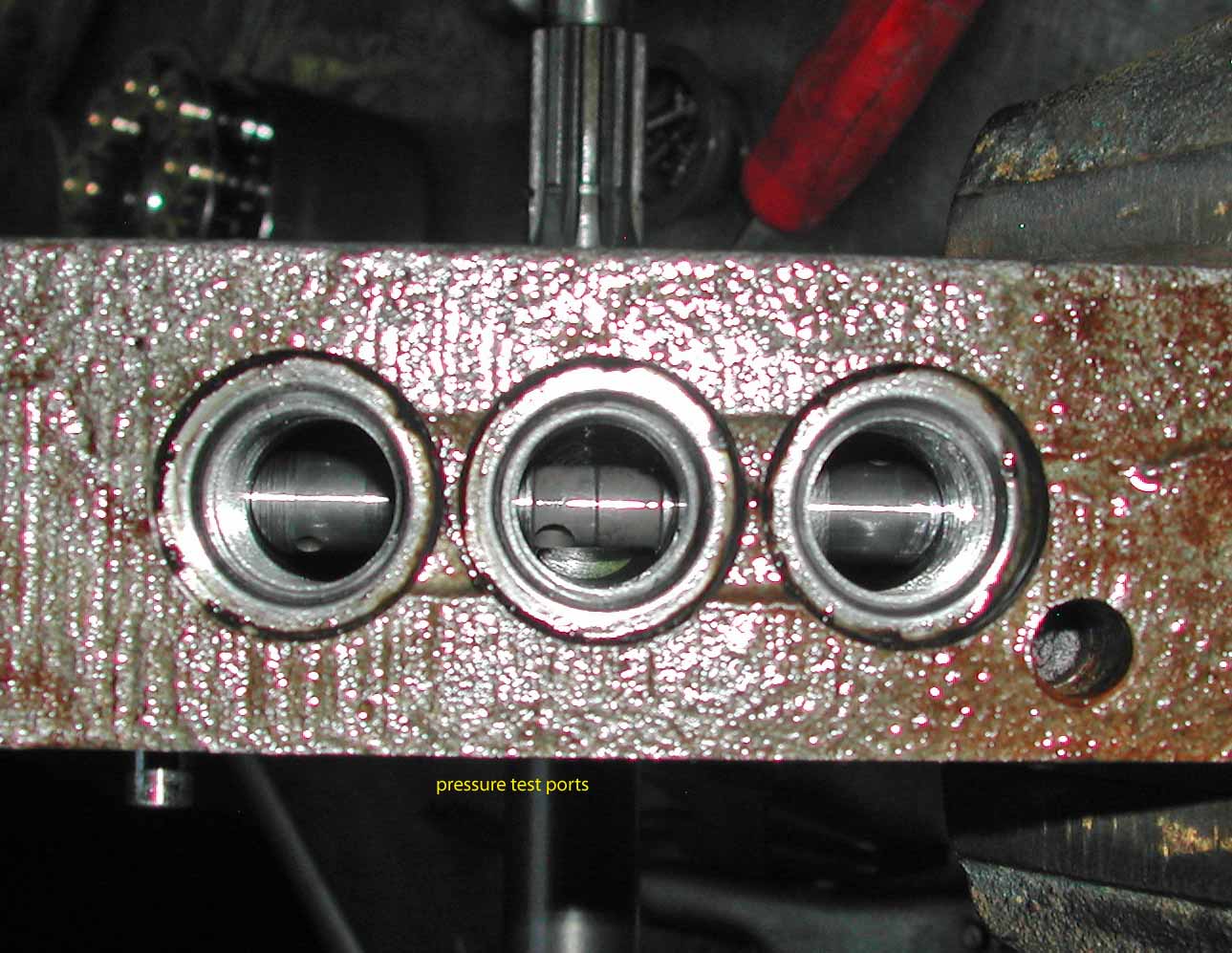

Testing pressure in neutral does not make sense. There must be something missing. On all the hydro machines for which I have been responsible the test procedure has been to shift into the highest range, then with the engine at full speed, slowly advance the propel lever to the stop (brakes set of course or other means to prevent the machine from moving).
