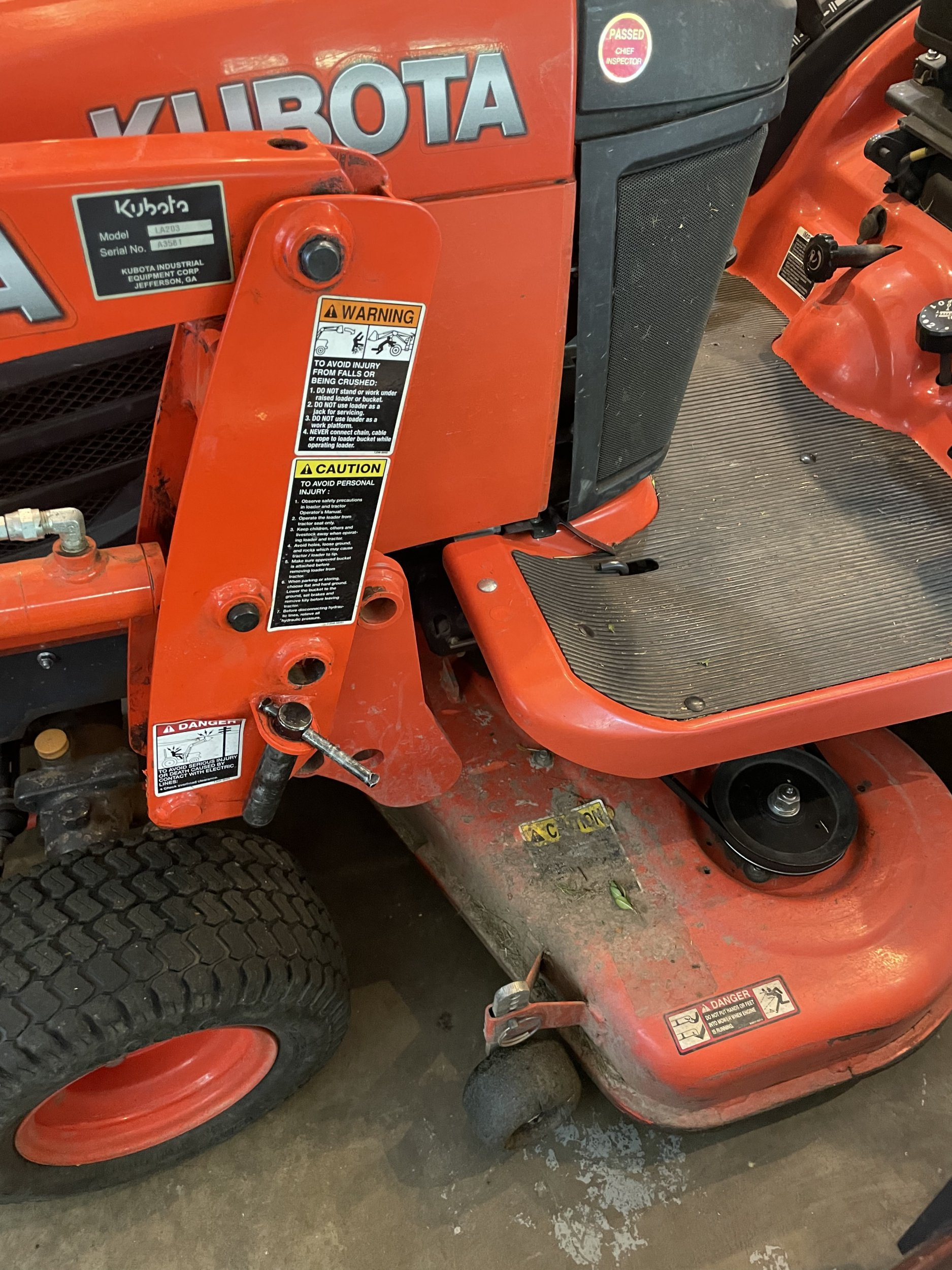

I can connect all 4 hoses.
good advice on taking the loader in with the tractor. It all fits on my trailer.
in the photo, the lever is in the detent position, and is unlocked. The lever releases from the detent position as usual and moves as it should, although pushing it forward, it feels a little mushy. Might be my imagination.
the lower arms remain at an angle that prevents the FEL from seating in the cradle. It feels like the lever doesn’t have enough travel to move the arms back.
I have mounted/unmounted the FEL a few hundred times since I bought it…
yes, except the rear arms don’t operate properly. I don’t think the lift cylinders are extending all the way.View attachment 763326
if the market wasn’t so wacky, I’d trade the thing in and get the next size up.
The last time I removed my loader I screwed up, it had been awhile and I was doing things out of order. I know you say you've done it a few hundred times and I'm not saying you're doing anything wrong but it can happen.
I know if I don't have my bucket curled just right I can't get the rear mounts to drop in place. It also hangs up on the brackets sometimes.

Judging from the pic that lever looks a lot more than "slightly bent", my guess is there is more damage than you may think to the linkage under the plastic cover. good luck

Looks to me like all you need to do is pull the lever back like you're lifting the loader to get the arms in position. It looks like they are fully retracted in the picture. Note that they can move independently of each other as the side with the least resistance will move first. You can push or pull one side to equalize them.
If the lever got pushed hard enough in the incident you may have damaged the linkage under the plastic cover.

KWentling may be on to something here --
1) I assume since you, the OP, have had the loader on and off many times you know that the vertical parts of the loader frame should/will move forwards and backwards easily by hand from the vertical angle? The one you show of the left side of the tractor appears to not be vertical and thus the pin can't be put in. As KW said, I'll reword it, those two loader frame near-vertical frame parts are on cylinders on the same hydraulic line -- so if you push one forward the other one moves backward rather easily. Can you not push/pull them until both are close to vertical allowing the pins to go in? You should be able to do that without the hyd lines to the tractor even connected. It is just normally a big help to use the active hydraulics to move the cylinders and curl, etc. assist without a bunch of lifting. So hard to picture the problem without being there! ... and ...
2) Have you lifted the boot/cover at the base of the joystick to inspect the loader valve controls/connections? You might have knocked something out of joint in the base of the joystick.

I'd like to see a picture showing the loader from a distance allowing us to see the condition of the "kickstand" and bucket. It does seem the side frames of the loader are pretty low, but I think it could still be mounted. Maybe the kickstands are bent?

I'll bet one of the control rods(item 110) between handle & control valve is bowed. I suggest to remove cover for a visual inspection.

It appears from the picture that the handle is bent so far forward that it is hitting something (maybe the plastic cover) and not allowing it to move enough to allow the valve to pass oil.
I would try removing the cover and see if there may be an interference.

It seems to me that if the control lever moves both sets of cylinders both in and out, the problem is not in the lever. That control lever has no idea where the cylinders are in their stroke. As long as all 4 cylinders extend and retract at least a couple inches, there is nothing wrong with the "bent" lever.
If you had the loader off, my money is on one of the quick couplers not seated fully.

Viewing the picture in post #19, it appears that all you need to do is pull back on the lever to let the lift cylinders extend a few inches to align the holes for the pin. I assume, judging from all the comments above, that there is more to the problem, however.
