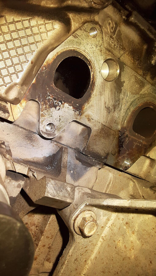

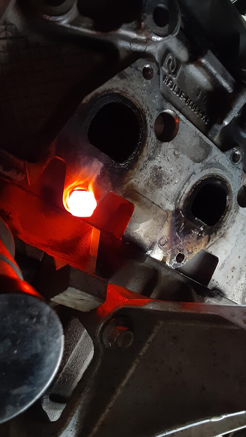

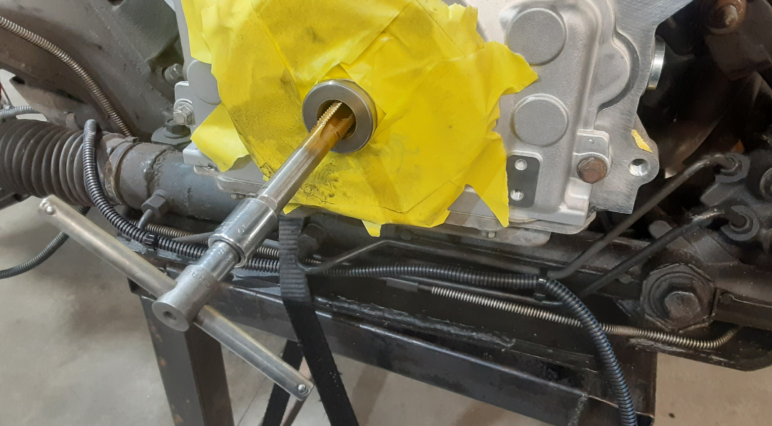

I have removed hundreds of broken and stripped fasteners over the years but never took step by step photos and thought some welders here might pick up another “trick”. Also have used a number of methods like EZ out’s of different styles, left handed drill bits, machining and metal disintegration but my go to is a TIG welder and a nut, if they are a weldable material and not too deep.
I have successfully removed down to #2 screws and down to a #5 set screw with the method.
#1 rule of removing any fastener is to not do anything to make things worse than they already are. Very important, you drill an off center hole, then break an ez out off and I’d tell you, you should have come seen me earlier.
In this case an exhaust stud broke off in the head, a successful removal means the engine or head doesn’t need to be removed and as luck would have it the area was tight enough the fellow couldn’t get in there with a drill to mess anything up. It did however break off below flush.

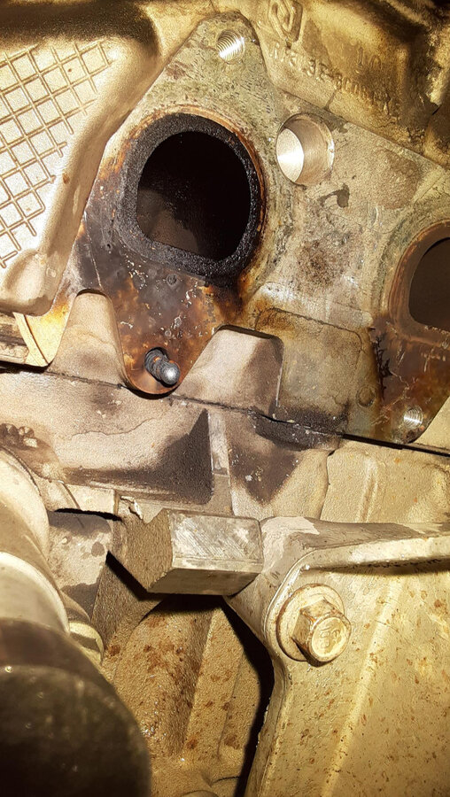

Used ER70s filler to weld to the stud and bring the puddle out side of the head, to the point I can set a nut on it and creat a “bolt”.

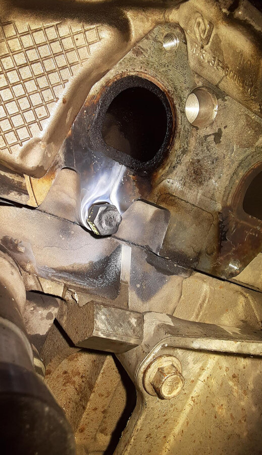

Then weld a nut to it and put a lot of heat into it. This expands what is stuck in the part as much as possible.
As it cools I put some tension on it, not much but looking for the point it moves as it cools, then work back and forth, penetrating oil is helpful once it starts moving.

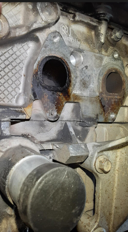

Once out, your ready to go back together.

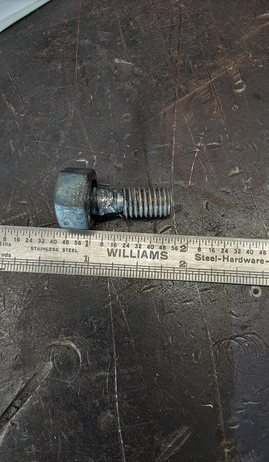

You can see the depth of the broken stud, once removed because that’s how much weld bead vs threads there are.

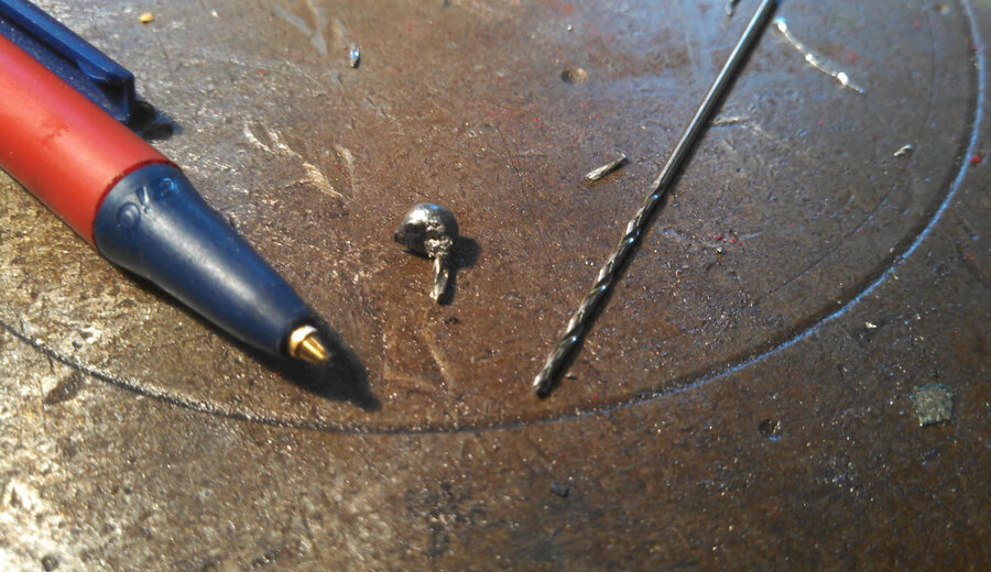

Dissimilar metals make things a lot easier but with care steel on steel isn’t that difficult. It’s also useful for things that are not fasteners like the tip of this small drill bit that broke off in a part and successfully removed.

I don't understand how you weld your "false" stud to the broken AND BELOW the surface stud?
The deeper the hole, the more you will have to extend the tungsten out from the torch. Shielding gas works fine because you are inside a blind hole.
If the fasteners are large enough MIG and Stick will work too, you can’t sink in as much heat with them though. You can throttle back a TIG and just keep it glowing vs melt away.

When you weld to the stud how are you able to keep the weld off the threads of the hole? I see picture 2 and you did it.

The head is aluminum

When the broken stud is recessed, as in this one, I've had success by building up small beads, layer by layer, until it protrudes above the surface of the block/cylinder/whatever. Think momentary puddle with a tad of filler rod. Build it up bit by bit. TIG/Pedal control. Once enough layers have built up and it above the surrounding surface add a on short bolt or a nut as appropriate. There's a good video of a fellow in Australia removing a deep automotive stud this way. If I can find it I'll post a link.
Dissimilar metals. Aluminum and cast iron are easy as your steel filler rod wants to go to the steel fastener and not the material it broke off into. It takes more precise control on something like that tiny drill bit broken off in steel. Generally start the arc then make sure it is arching off the part you want to remove vs the parent material before you throttle up the current enough to melt anything.

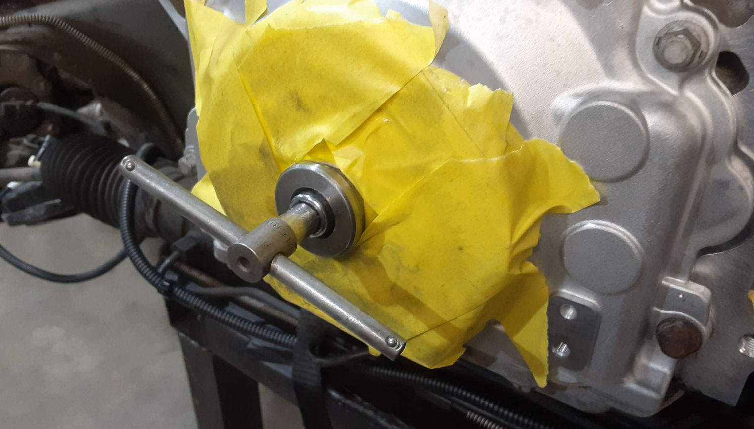

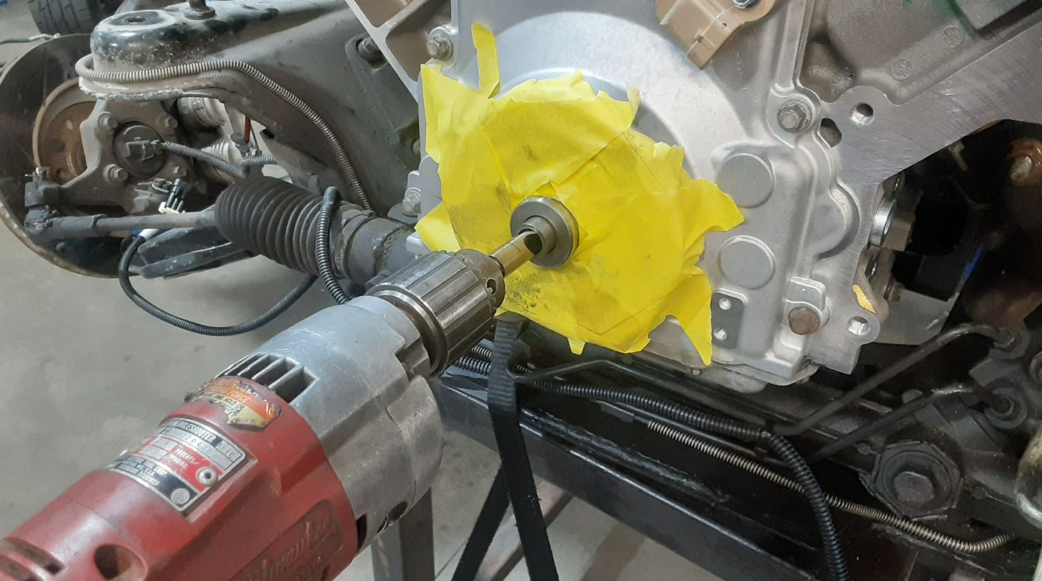

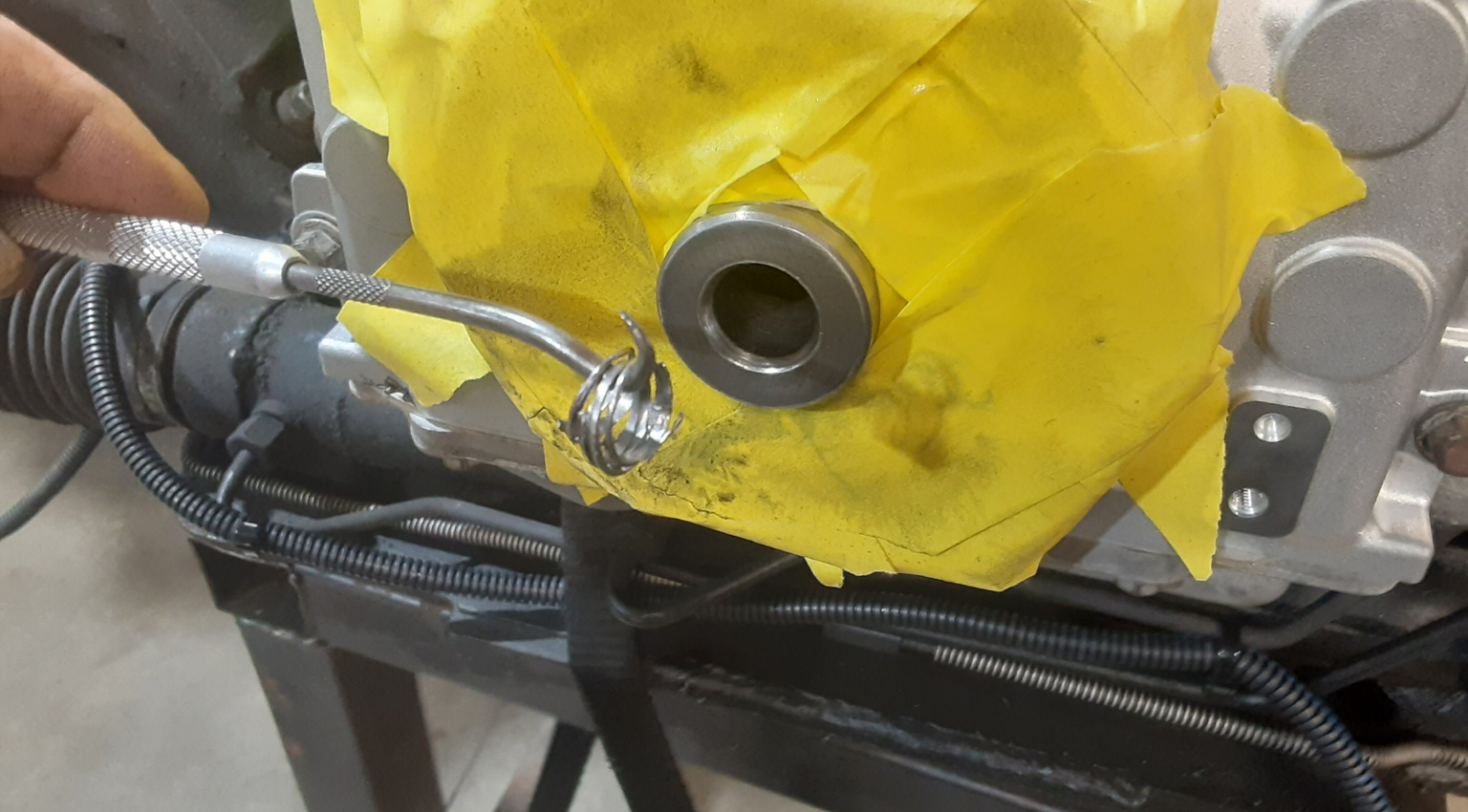

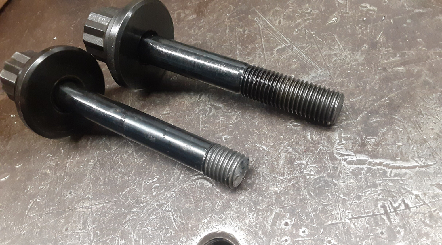

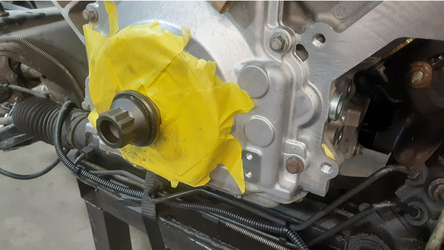

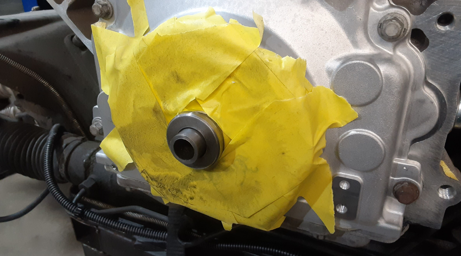

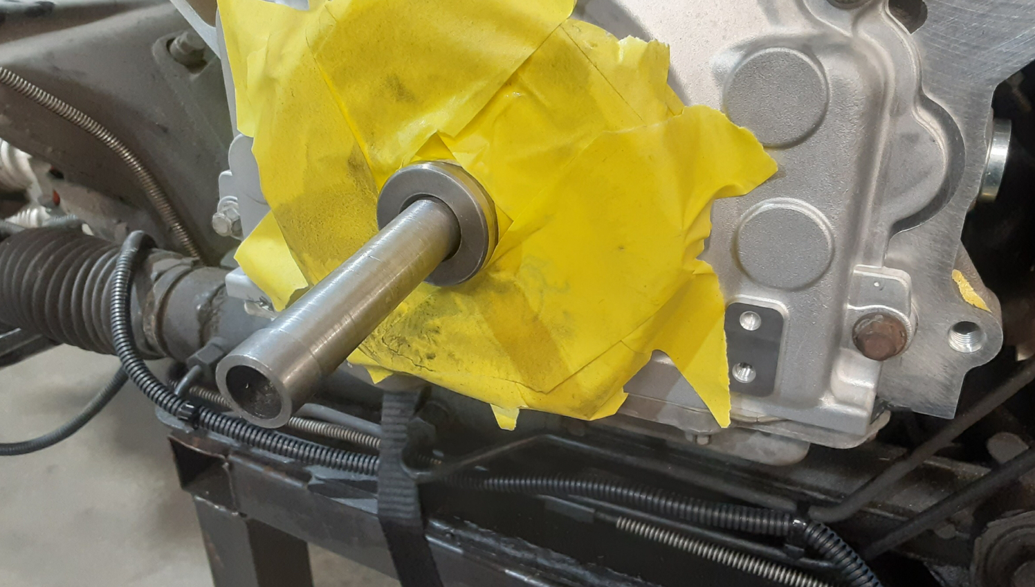

This is my least favorite method because it is quite time consuming; however, it does seem to always work, when you can’t use other methods.
This one is an 8740 chromemoly fastener that broke off in a crankshaft and the threads are several inches deep in the crankshaft before they start. Welding is out and the chances of a decent drilling are slim, without some help.
This help comes from a piece of 3/4” cold rolled that is turned to fit the ID of the bore on the crank shaft. It runs all the way down to the edge of the broken bolt.
I started out with just a 1/4” hole in the sleeve because the center of bolts is generally softer than the edges. Then drill out the sleeve with the next size drill bit in a lathe, then go back and open up the broken bolt and repeat.
I generally like to use left hand twist drills because if it’s not galled like this one was, they often will come out while going up in hole size. If they don’t just keep going up to the correct drill size to tap the hole. This was a 16mm-2, and the correct drill size is 14mm.
Once the core is drilled out of the broken bolt, what is left are just the threads that you can pick out like a mangled helicoil, leaving the original internal threads untouched.
This makes it easy to see why absolutely perfect alignment is necessary for this to be an effective technique.
After that I run a tap in to clean up the galled spot where the fastener seized.
Then it’s ready for the new bolt.

#18
It was a brand new engine intended to go into a vehicle. I was confident enough on success work carried on getting it ready and made my life easier because of work height.
Some vehicles the engine/transmission and front subframes are faster to drop than pulling just the engine. Such is the case with this car too, I imagine.
