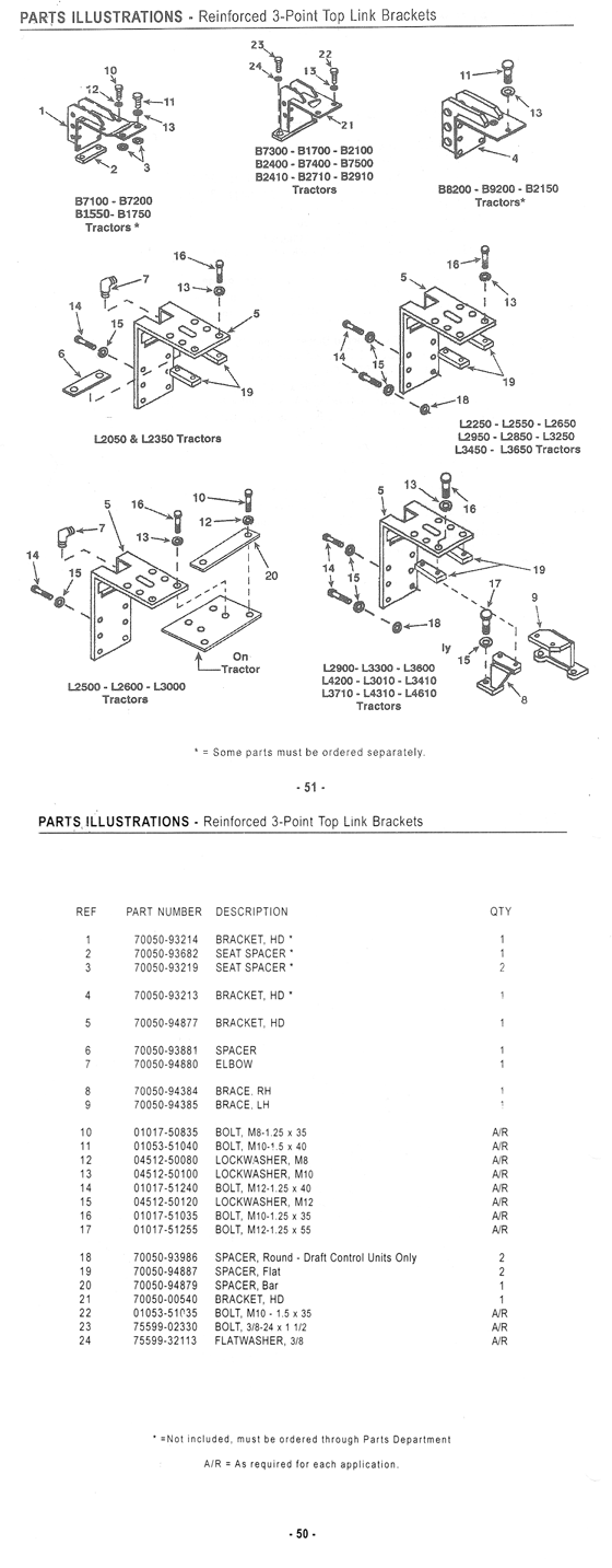

Considering the original case break and stud repair, I would beef up the toplink mount by making a bracket that ties into the 4flats on either side of the PTO, drill, tap and bolt it there. The aluminum housing isn’t strong enough. I know you said you replaced the 3PT post hole digger in favor of a skid steer type, but thats just my 2 cents
   / Broken hydraulic Cylinder Case #23
Im not sure drilling and tapping those spots would provide much more strength.
And whats aluminum? I though this was cast iron??
At one time, kubota actually offered a bracket to beef up the toplink connections on some of their older models. It was recommended for 3PH backhoes. And it tied the toplink brackets (which only have horizontal bolts bolting it to the rear case) to the bolt holes on top where the seat mounts.
IF you can make/weld something that ties in some of the bolts on top of the casting it will help alot.
This was kubotas optional toplink mounting bracket

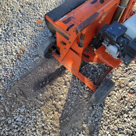

Just rebuilt a Little Beaver EZ Kwik trencher. Runs better than most of my gas-powered machines (many).
