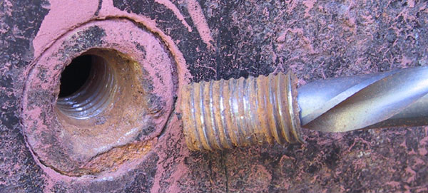

I don't agree with you on this. Usually a bolt that breaks is a little distorted at the break. It's far easier to take it out the way it went in. Now your bolt might be an exception.
That is a good point. There probably will be a bulge where the bolt broke. As I posted above, I have a high torque, low RPM drill which should be better than what I've used in the past. I installed a larger axle on a camper a year or so ago, which required relocating the springs and drilling through a lot of 3/8" inch steel. That drill made it tolerable. Didn't even know I needed it until then. Should be perfect for this job. Let me be sure I understand you. You think the left-hand drill bit will catch in the bolt and pull it out the same way an easy out would? I assume that's it, since a hole drilled with either twist is just that - a hole...

yes left hand bit will sometimes back one out, can also take small punch and turn it out if its not stuck bad

I hate to appear dense, but why on earth use a slick punch or drift when an easy out is basically just a punch with left hand flutes which have been sharpened to bite in the drilled hole in the bolt. IMO, this bolt is stuck thoroughly enough that a left hand drill is going to give me the same thing a standard bit will - a smooth hole. There's no way a left hand HS bit is going to "stick" in the hole and back out the bolt by itself, just not enough leverage and bearing area. I think we may as well close this one down...

With the drift punch you dont have to drill a hole. Attacking with the punch at an angle and off center, once you develop a divit, you would be surprised at the torque imparted by each blow. The torque and shock to the bolt often cause a little turn. Then youve got it.

I actually have done that before with larger bolts. I'm just not sure there's enough room to work with - it's an 8mm bolt. However, I do have a couple of pretty small prick punches, so I may give it a try. I just don't want to booger the threads and make the problem worse. That really has a lot better chance than a left hand drill bit...

TIDE HSV just to answer your question. Yes when a left hand drill bit catches an edge on a broken bolt it's usually enough to spin the bolt remains right out. I usually try to drill about 1/4 of an inch deep and then slowly move the drill to one side to help the bit catch on the bolt. Just be careful you don't break the bit off in the hole as then there is a worse problem. I should have explained the procedure a bit better.

I've broken off bits before and it's game over, since the bit itself is hardened steel. There are several other methods mentioned above, all of which I'm familiar with. I think I'll pass on the left twist HS drill bits...

A left hand bit can remove a broken bolt. :thumbsup:
But not always. :(
   / Broken Wheel Bolt #34
A couple of reasons that a left-hand twist drill bit is preferable to an Easy-out:
- LH bit cutting flutes put quite a bit of torque on the broken bolt in the direction needed to remove it, often enough that it will back out.
- LH bit generates a good bit of heat right in the insides of the broken bolt which helps with loosening.
- If you are going to drill a hole for an Easy-out anyway, why NOT try a LH bit?
- It is common (in my experience) that the taper of an Easy-out will swell a stuck bolt and make it even that much more stuck.
- It is common (in my experience) that the hardened Easy-out will snap off leaving you with a much worse problem.

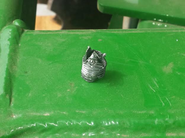

For some reason, I stopped getting email notices of replies and it rained every day last week, making it impossible to work on it, since it's under a tarp in the open. I finally got the bolt out with a drilled hole and an easy out. I actually have several and the one I used was one which has a shoulder like a HS bit. If it works, it works with a much smaller, shallower hole than a pointier easy-out. It was still about 1.5 hours work, because, if the bolt weren't hardened, it certainly behaved like it. It was tough! When I get the chance, I'll post the pix...
