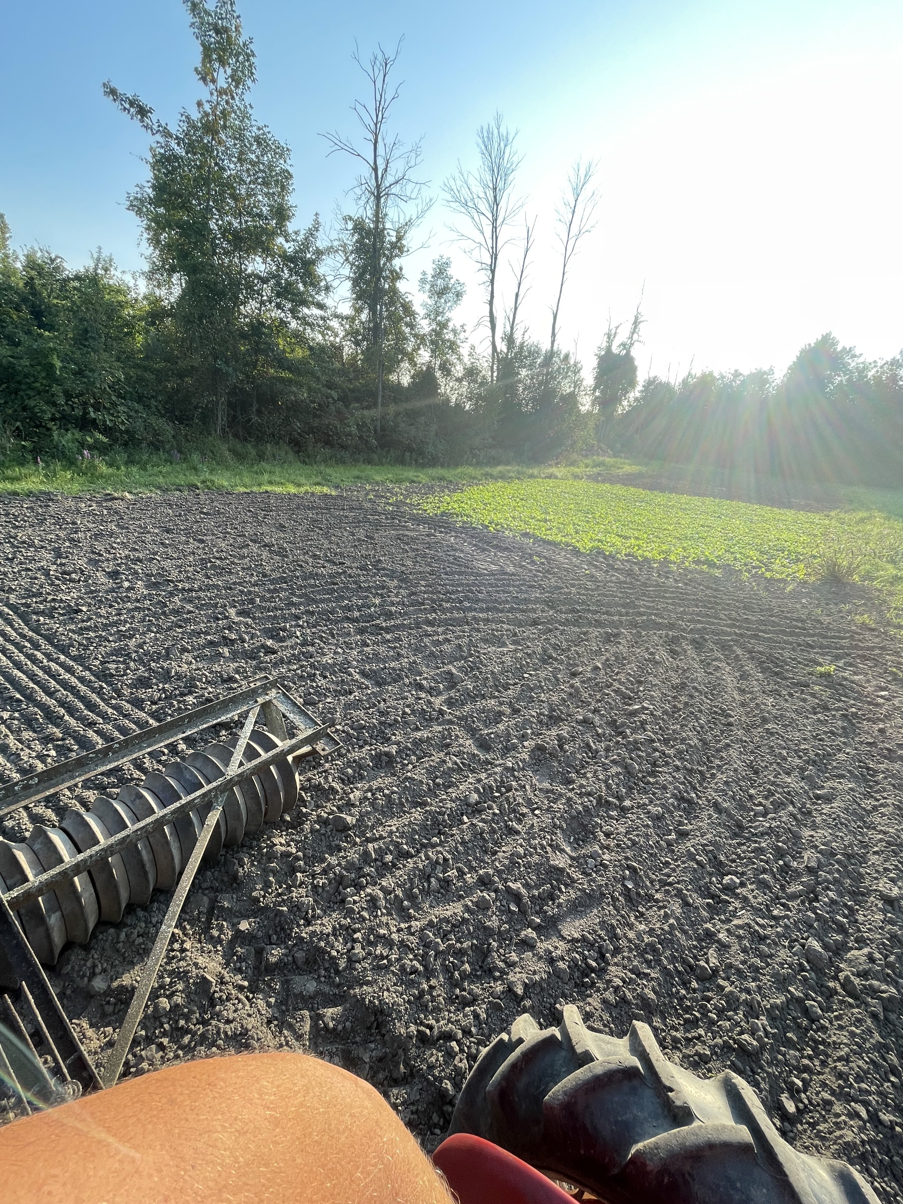

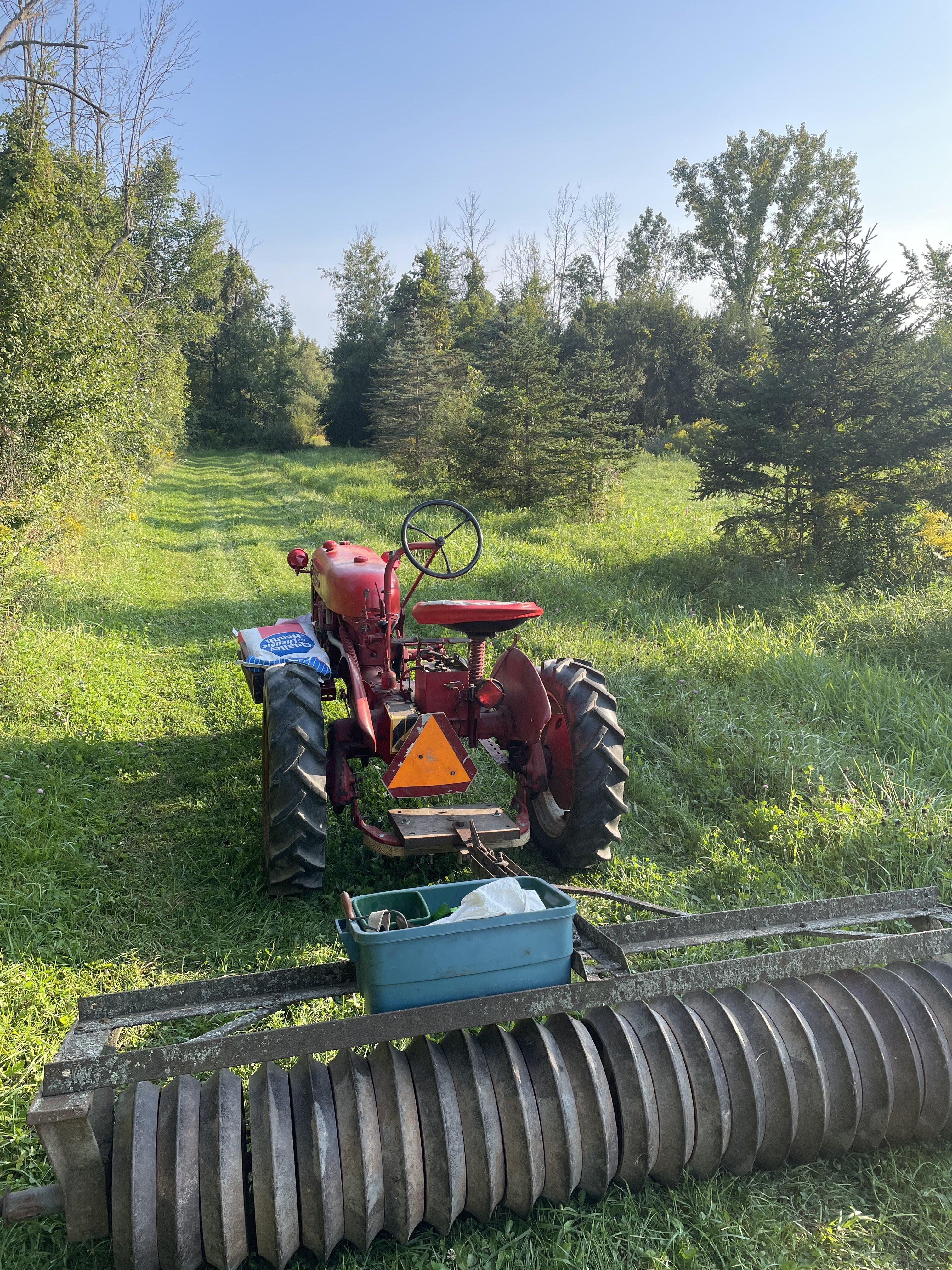

The Cub got a couple hours on it tonight, cultipacking a few acres of wheat and clover that I had just sown. The oil leak repair held up good. The lights worked well also. Good thing because I needed them to finish up 1/2 hour past sunset.

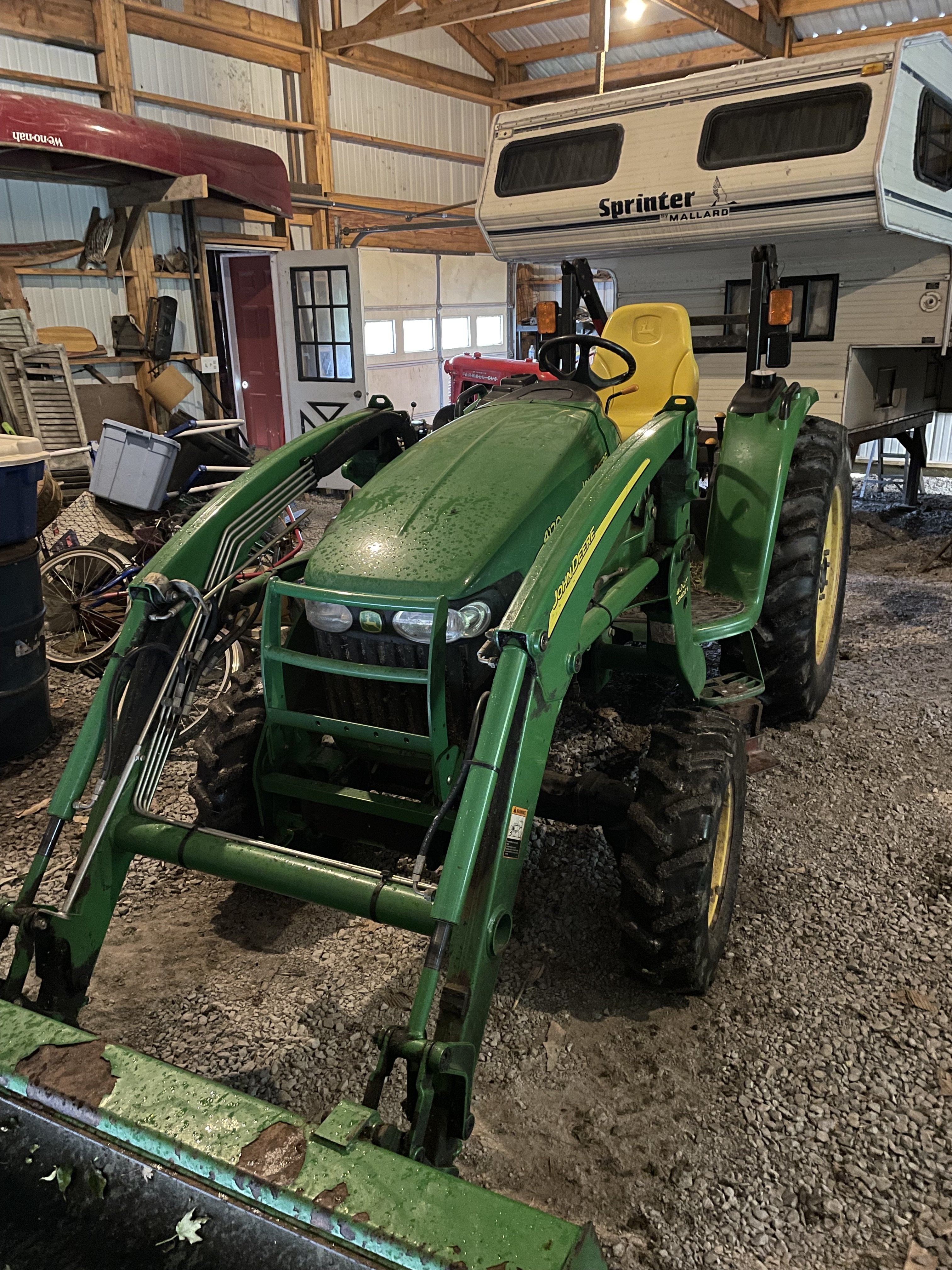

Now that the leaking oil filter and backwards wired battery are repaired, the Cub is ready for leaf and light snow duty. I put the snowplow back on it this afternoon. I use that to push the leaves into a pile after I dump a bunch of sweeper loads in the rough area behind our lawn.
I leave the big leaf pile back there thru the winter, then haul it out into the fields out back with my loader tractor, in the spring. We’ve got quite a few big maples in the yard that dump a ton of leaves and I’m all ready for them now:
Step 1:
Step 2:
Step 3:
I used to use a back facing 3-point terracing blade on the loader tractor for pushing the leaf pile but the Cub front snowplow with pvc pipe on the cutting edge works way better.

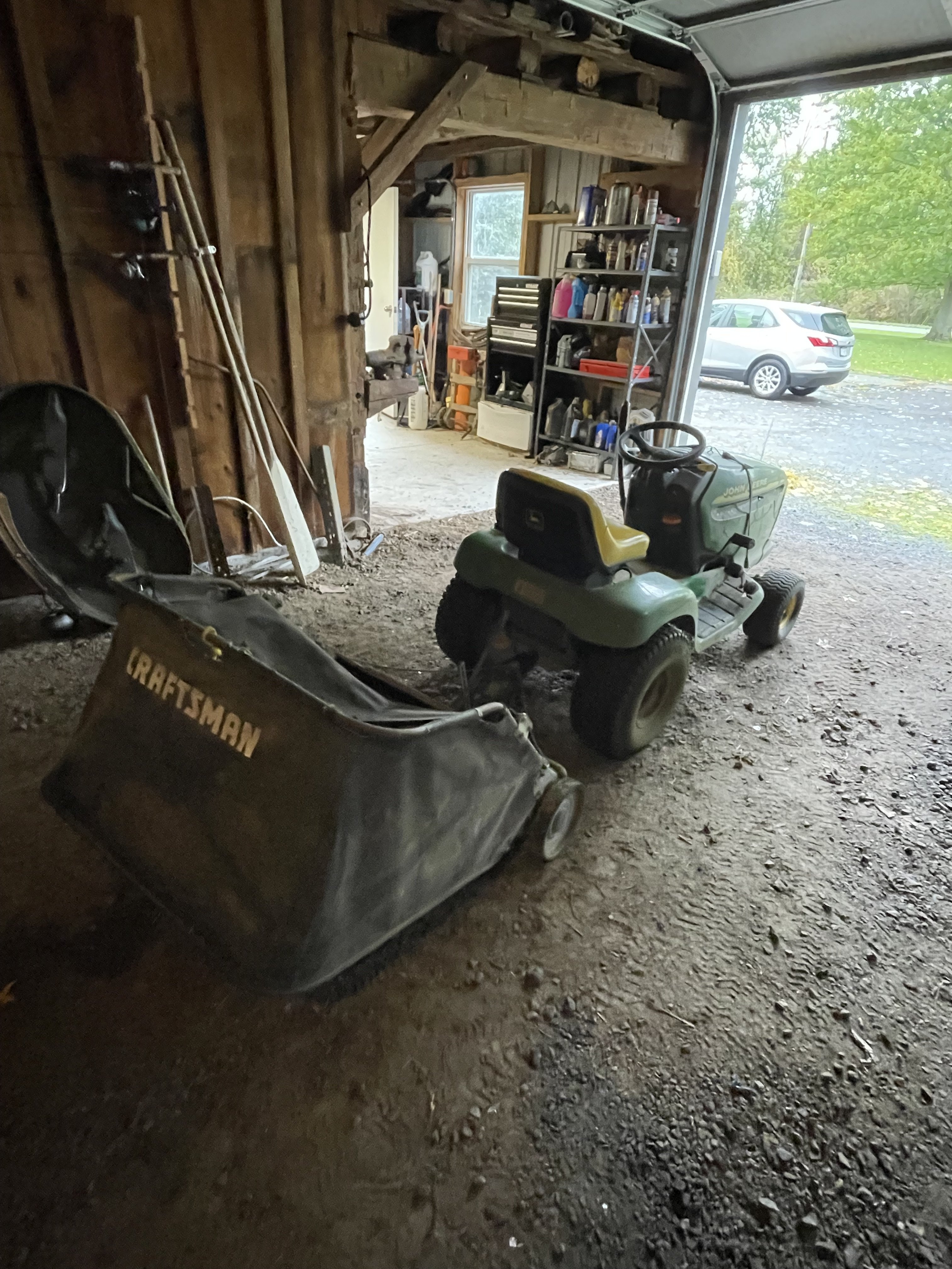

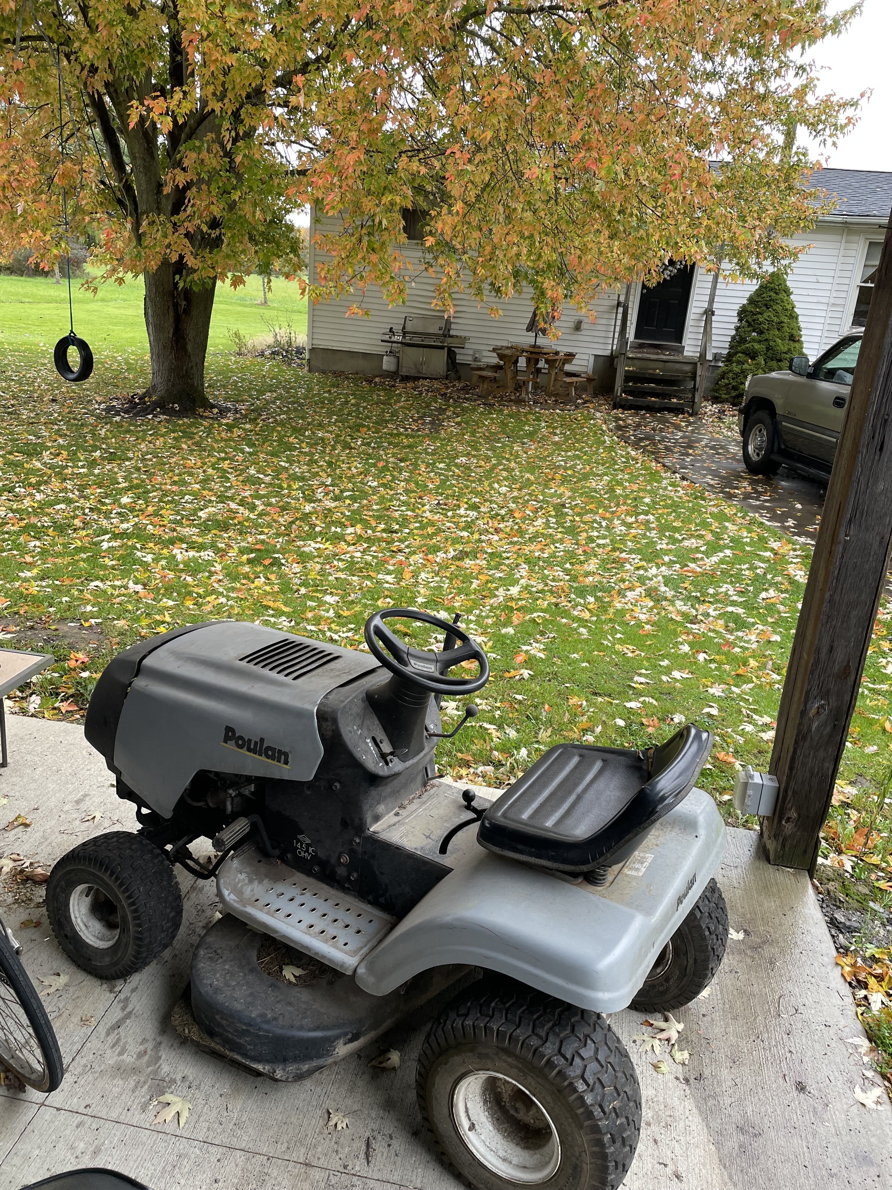

This is my cheap backup lawnmower that I use in the late fall after I remove the deck from my good one (It works much better on the sweeper with the mower deck removed). You can see one of the big maples in the back, still holding most of its leaves but almost ready to drop them. I can’t wait. With the right equipment, clearing leaves is almost as fun as plowing snow.

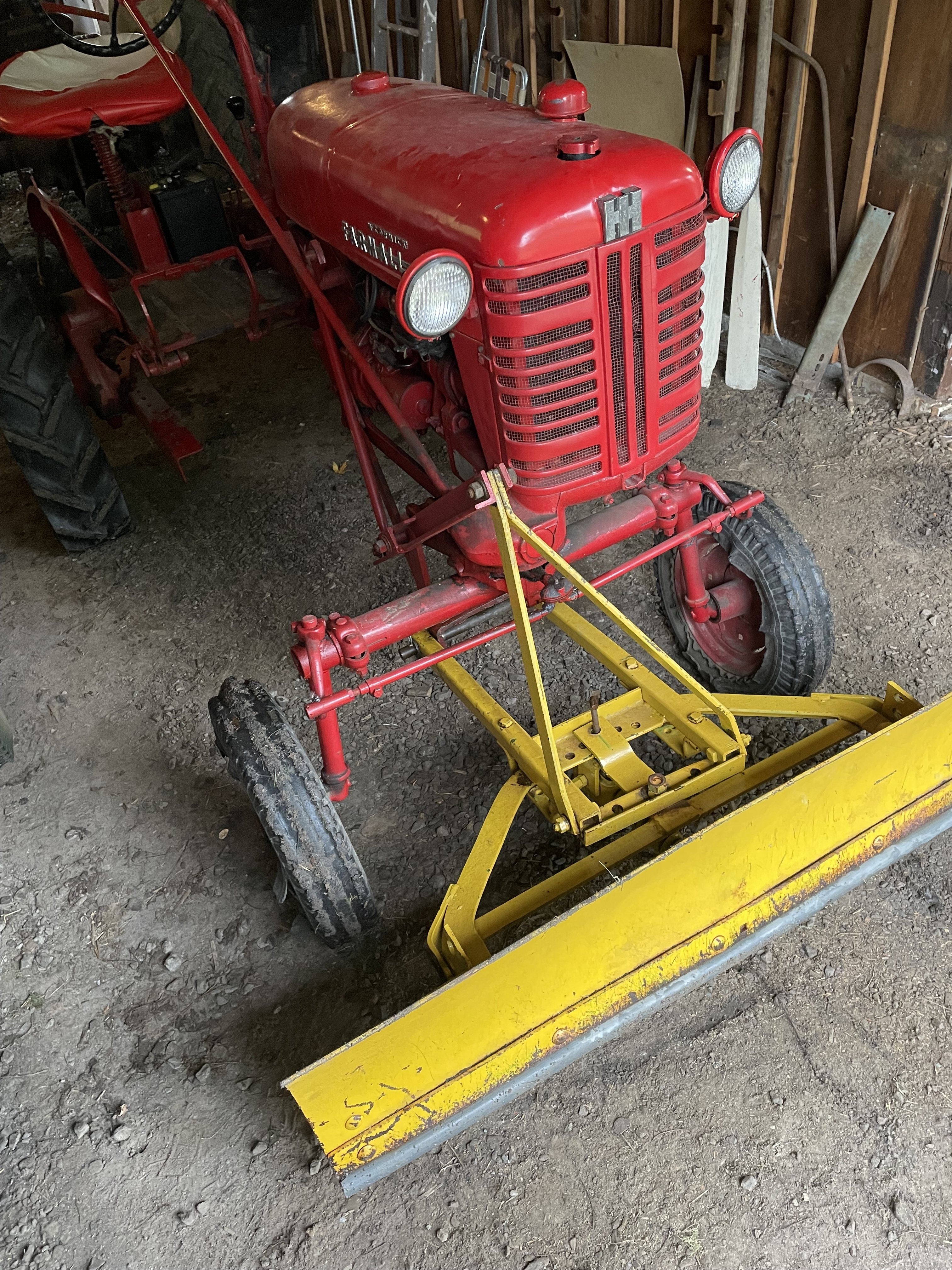

I had to remove the pvc pipe from the plow blade cutting edge to make it work better on the leaves. It kept rolling over them with it on but worked great with it off.
The leaves are all down and in two big piles now, so I got to hammer that pvc pipe back on to get the Cub ready for the snow. The pvc pipe on the edge does a wonderful job of keeping the driveway stones out of the lawn before everything freezes up good.
