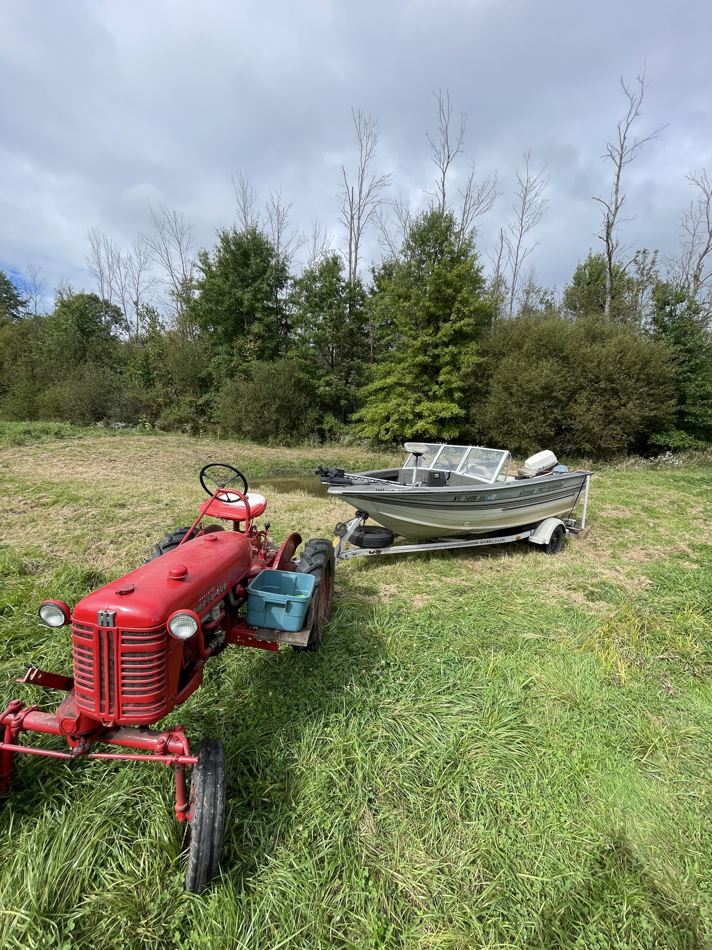

The Cub did real good on leaf duty, after I removed the pvc “stone guard” from the bottom of the blade. It just rolled over the leafs with that on. After I finished pushing the leaves, I put the pvc back on to get it ready for snow. There is none of that in our forecast yet, but it’s nice to be ready for it before it hits.

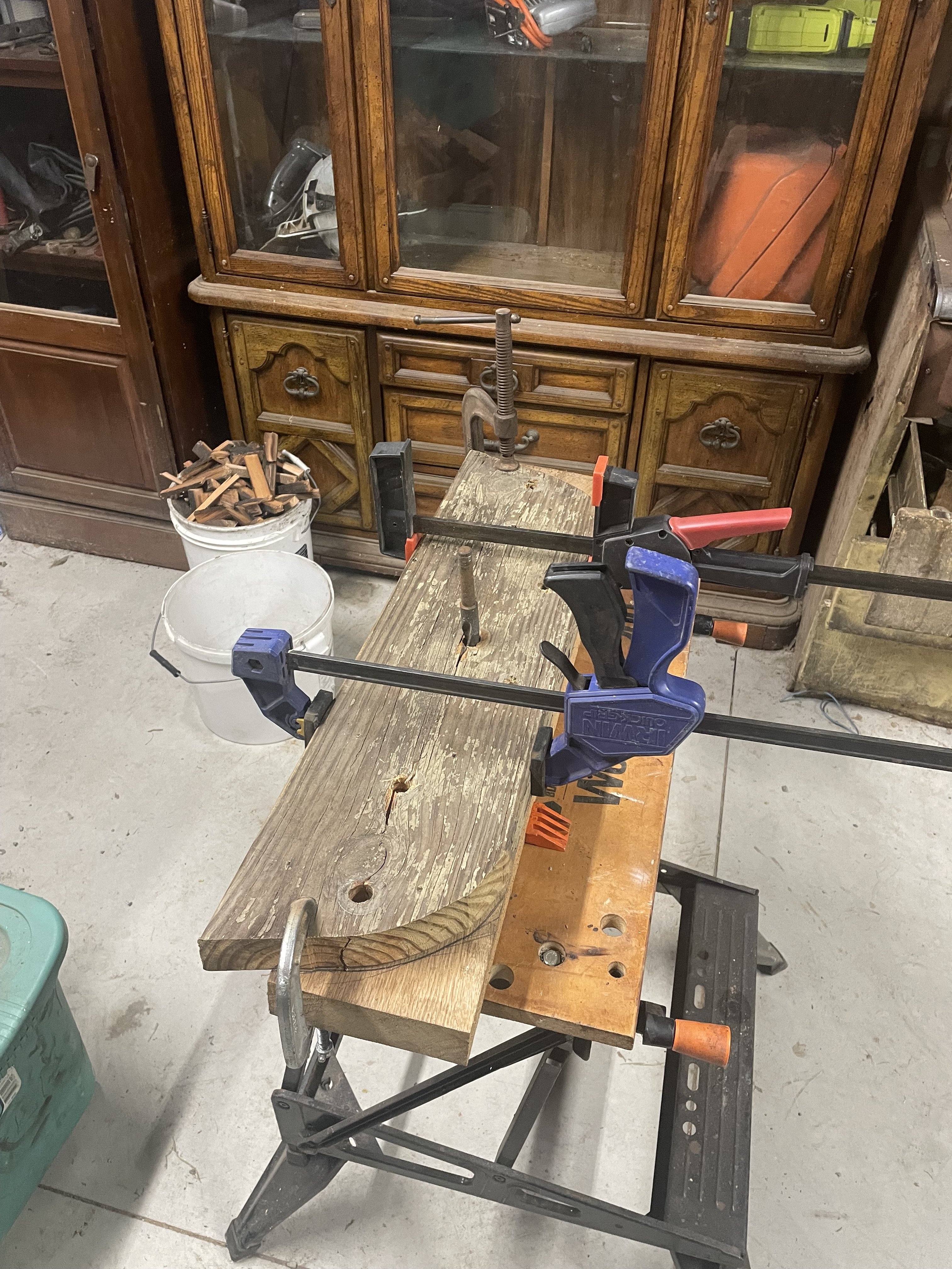

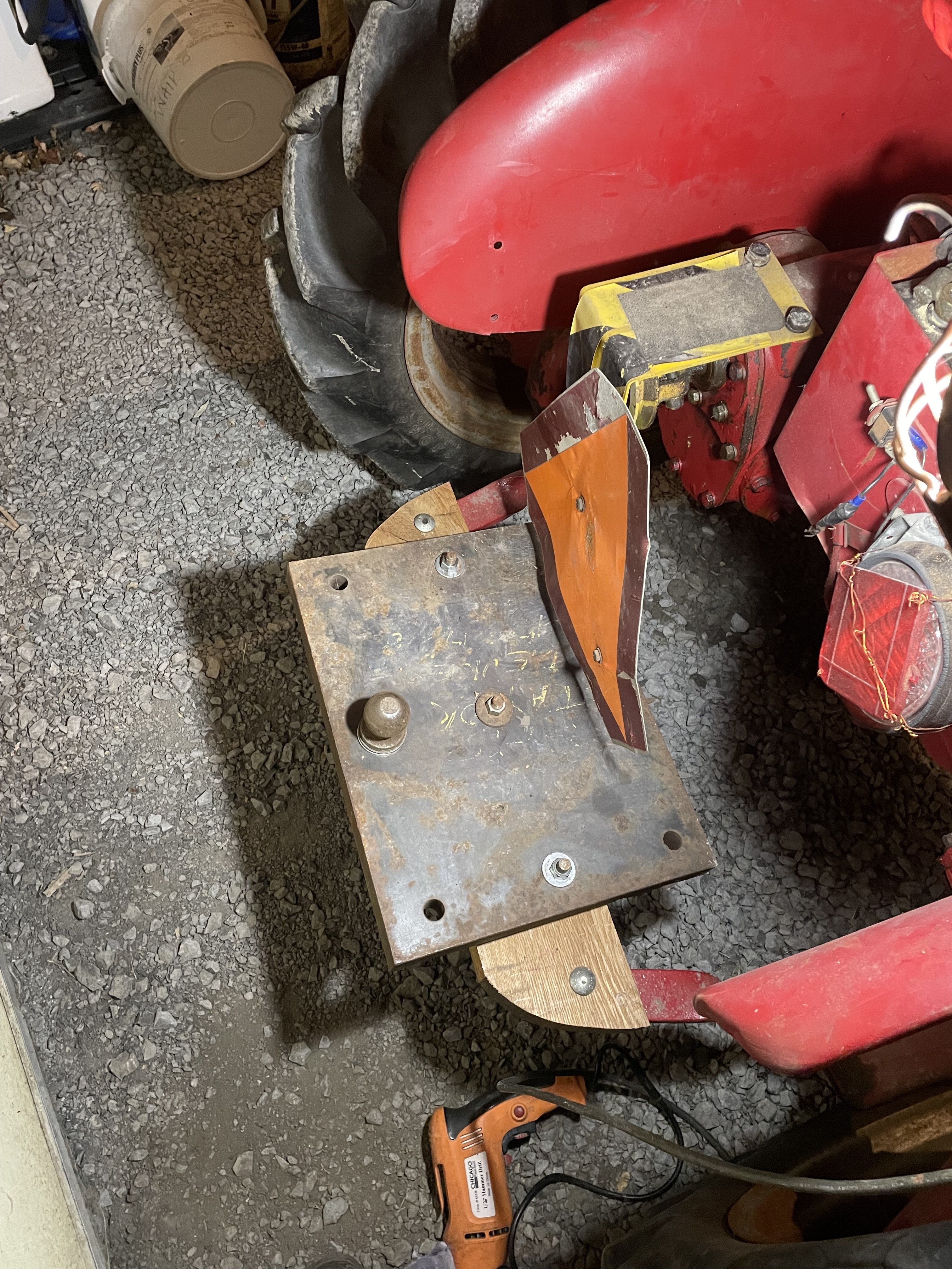

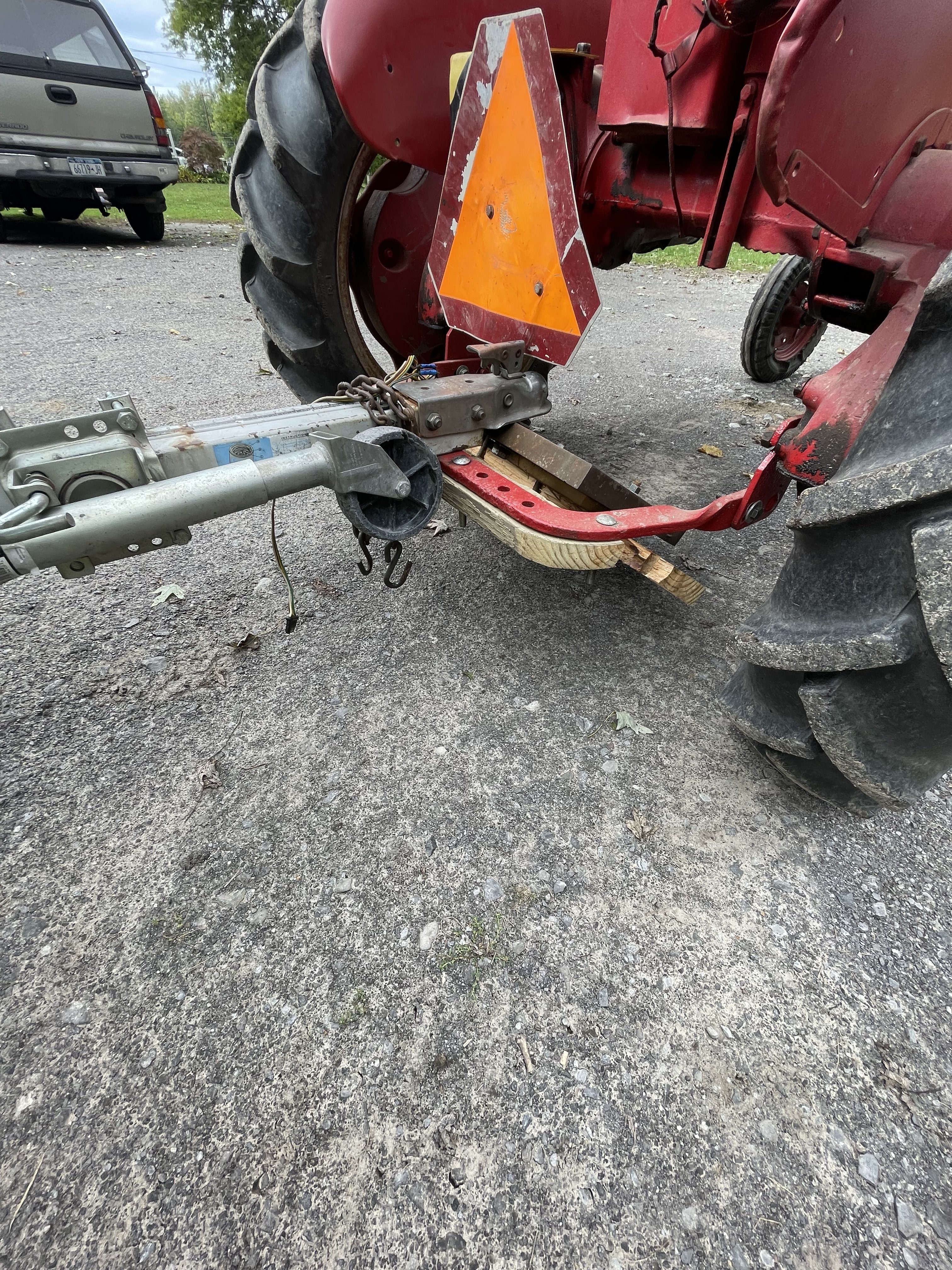

I also had another little issue to the care of, after I broke the pressure treated pine board adapter that held a heavy steel rear ballast weight on the rigid drawbar. Just a little too much tongue weight on my boat, the same cause of damage to the plow frame, when I tried using that for a “hydraulic lift” front hitch.
There is a place for pressure treated pine but this clearly wasn’t it. I replaced the broken pine board (made a nice drill pattern anyhow), with a big hunk of white oak. I don’t think my boat is heavy enough to snap that.

I could be wrong, and don't like knocking someone else's work, but I think you'll have the same problem at some point. Looks to me the way that is built you've created a fulcrum. With tongue weight on the ball you're putting upward pressure on the front pivoting on the drawbar itself. All the bolts are pretty much in a straight line and may be pretty close to the same line of grain in the wood and may very well split too.
With the ball at the back and bolts holding it that far forward that creates a good bit of leverage, plus what weight of that plate is between the bolts and ball adds to it multiplying your tongue weight somewhat.
I'm seeing two options using with what you already have made. A similar piece cut to fit underneath using the same bolt holes, but you'll need a spacer to equal the thickness of the drawbar. I'm guessing around 5/8" and cut to fit inside the drawbar, basically sandwiching the drawbar on the outside edges which would increase strength.

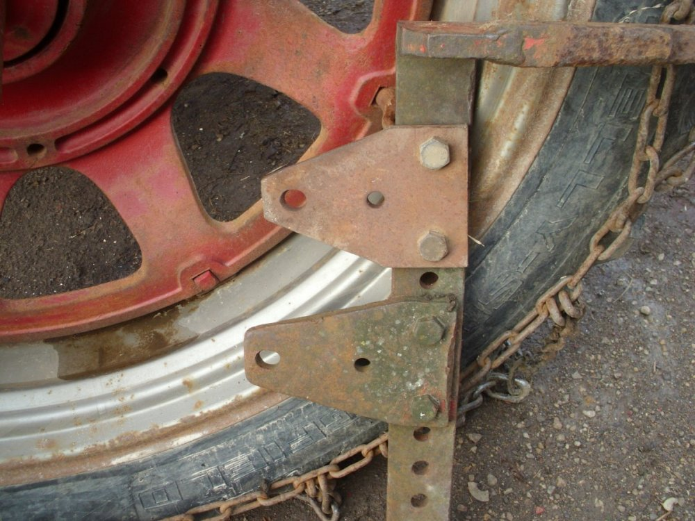

The other option is getting a drawbar extension like pictured below and bolt it directly to the drawbar. It'd just have to be long enough to clear your plate. It could be mounted either on top, or underneath. Underneath you'd only have to make a relief in your plank for the bolt heads with say a Forstner bit. On top the relief would have to be made for the extension and bolt heads. You could use a router to cut the relief deep enough to clear all, or just deep enough for the extension, and Forstner bit for the bolt heads.
Personally, I'd go with the drawbar extension. They can be bought at about any salvage yard for around $35.00. If you have a weld shop around that may have a piece of 5/8" plate you may get them to cut it to a custom size and either you, or them drill holes to match your drawbar.
Again, don't want to knock anyone's work, but don't want to see anyone get hurt, or something damaged. Just throwing in my 2 cents worth.

Looks like the old plank split along the grain, with the grain on top under tension, treating the bottom edge as a fulcrum. If you could bore thru the plank and insert some fasteners going fore/aft, it’d increase the strength of the replacement dramatically. If that’s too difficult, plowing matching dado’s in two planks and epoxying them together gives you effective bores for inserting long carriage bolts or all-thread thru the whole thing, and the doubled thickness also halves the tension on the top face.
But your new design already looks pretty strong, in that your fasteners are all in a row. That was a good move, as it mostly eliminates any torsion across the grain.

Regarding the broken pt pine board, I didn’t have any trouble with it, until I loaded a bunch of extra stuff into the front of the boat, greatly increasing the tongue load. I’m thinking that the shear strength of the white oak should be much greater (2X or more) than the pine, so I doubt it will break angain, under similar usage.
The cross section at the break is also more now than it was, because the oak is 2” thick, while the pine was 1-1/2”.
I used the old pt pine setup 6-7 times through the summer and fall, most of the time with front livewell tank on the boat full of water, so there was a pretty good load on it. One of the best things about the gravel floor in my pole barn, is that I can drain the livewell right into it.

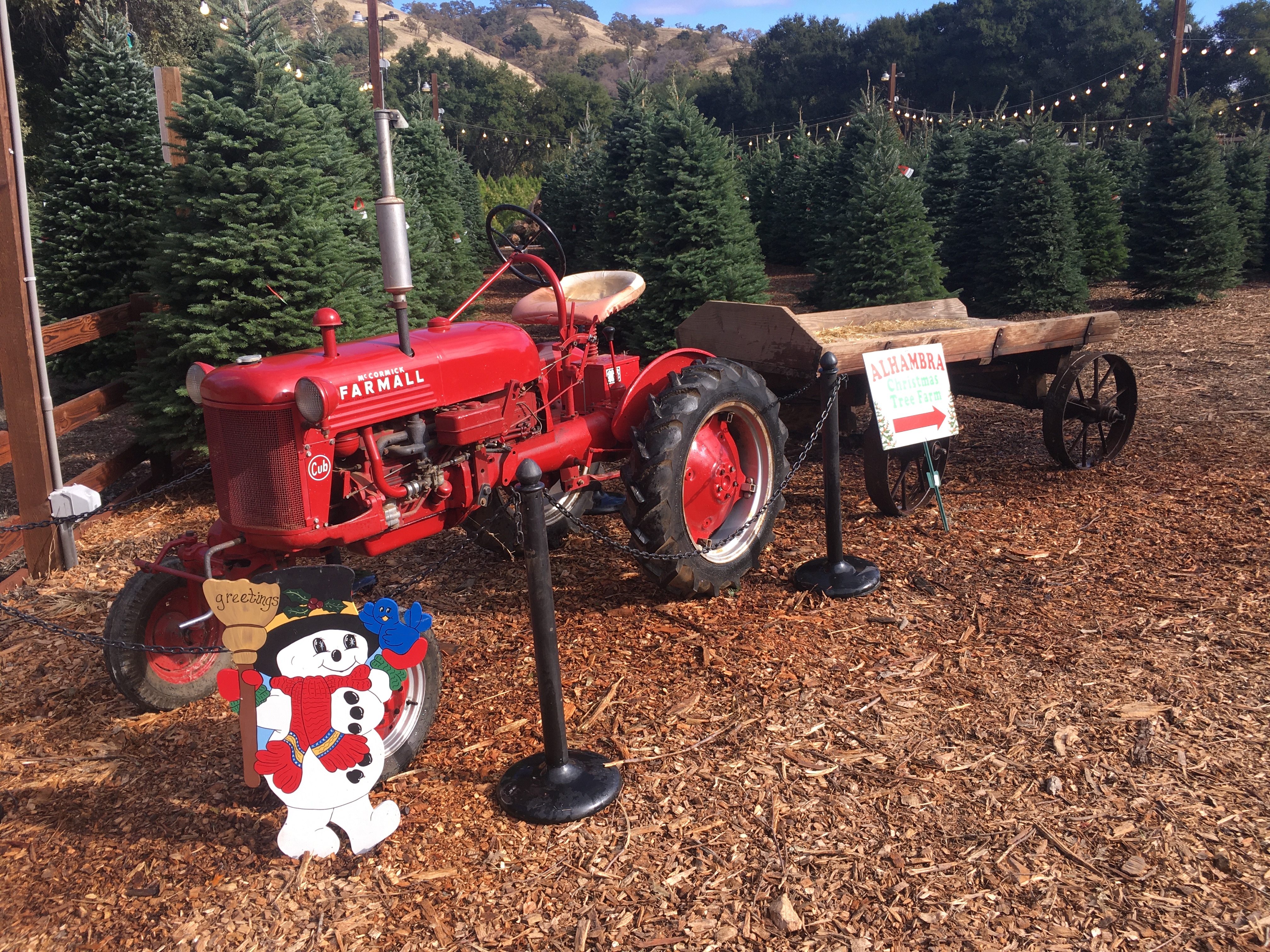

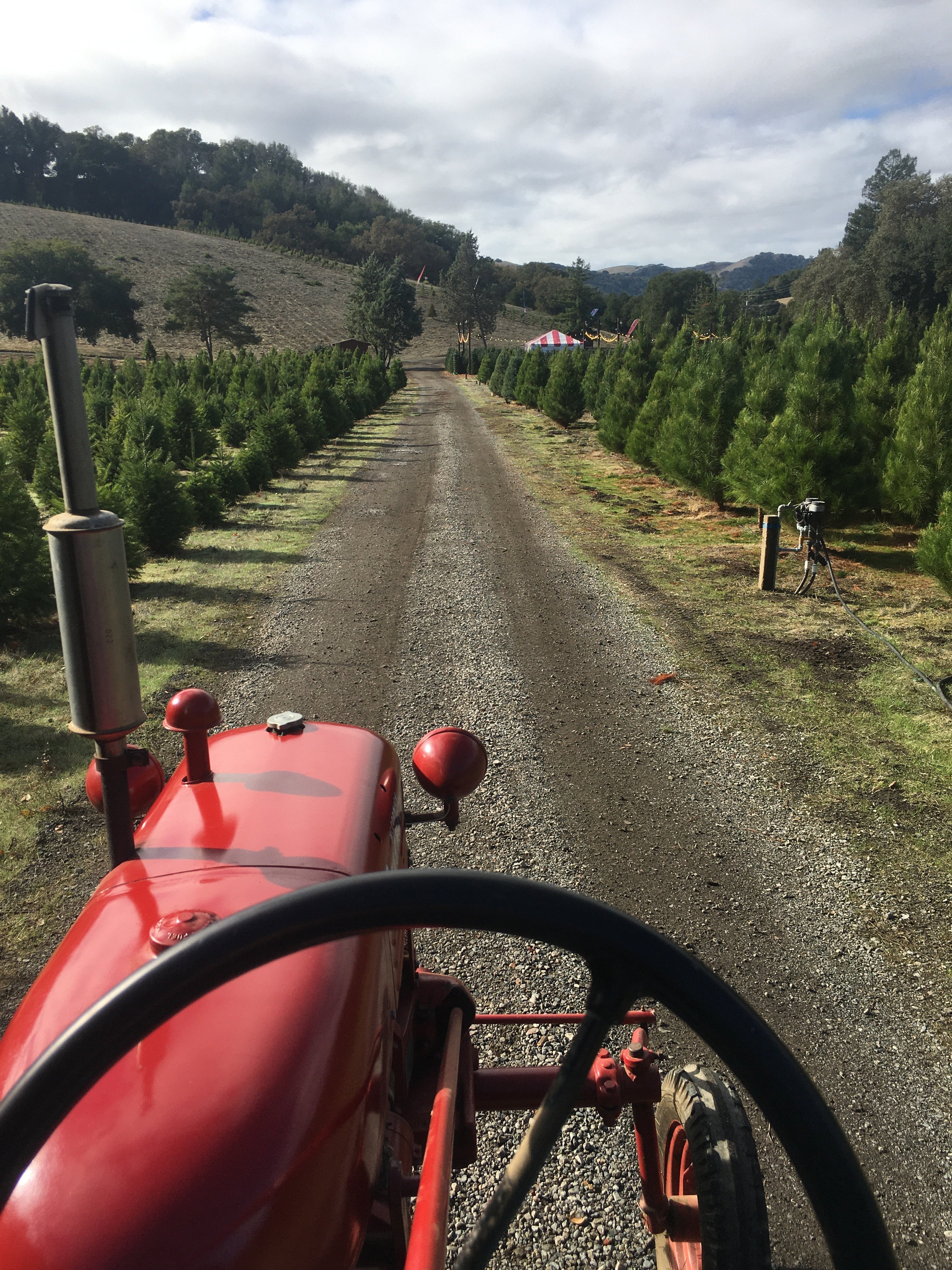

Brought the 48 cub out for the Christmas Tree farm today.
My brother was not able to get it to run and it normally fires on the first or second crank pull.
Checked the carb and blocked with corrosion.
Used compressed air and a stiff wire for a quick and dirty fix while I had it apart and it worked.
It’s a shame one needs to be a carb mechanic now when you have old equipment on California pump gas… no pure fuel stations surround here.

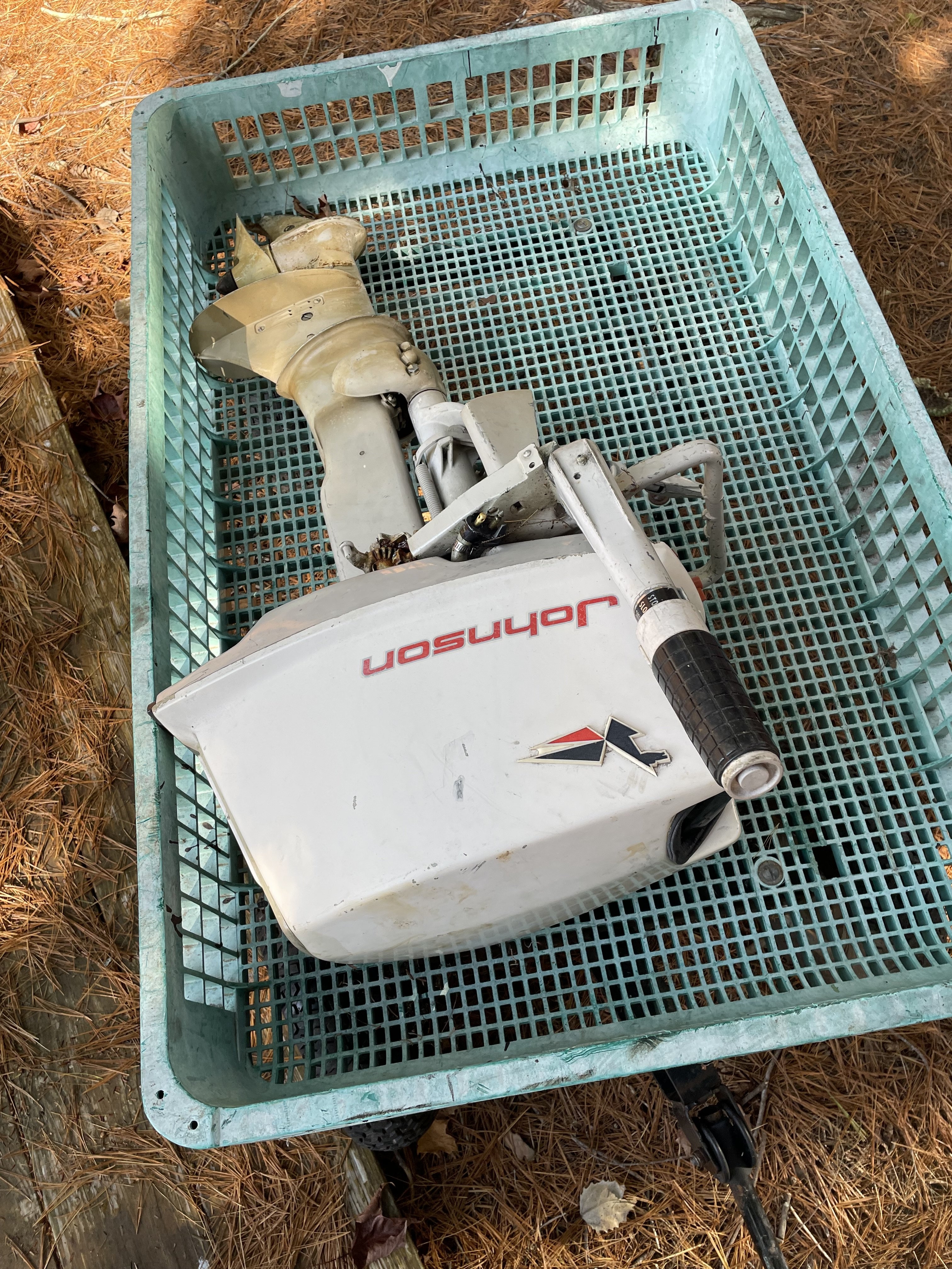

Too bad you can’t get ethanol free gas. That’s all I’ve run in my seldom used engines and I’ve had no carb issues with any of them (around a dozen total). I did sieze up a little boat motor running a 16:1 gas oil mix this fall, but I think that was because the water pump wasn’t working. I’ve got to add that leftover gas mix to the Cub over the winter, to use it up.
I’ve got about 2 gallons of it left in the boat motor tank. I’ll add a quart or so with every couple gallons of plain ethanol free gas to the Cub, until it’s gone. The little bit of 2-stroke oil will give a little added valve lubrication.
That Cub looks nice with the Christmas trees. It don’t get much more Christmas like than a red Farmall Cub and a Green John Deere M.
