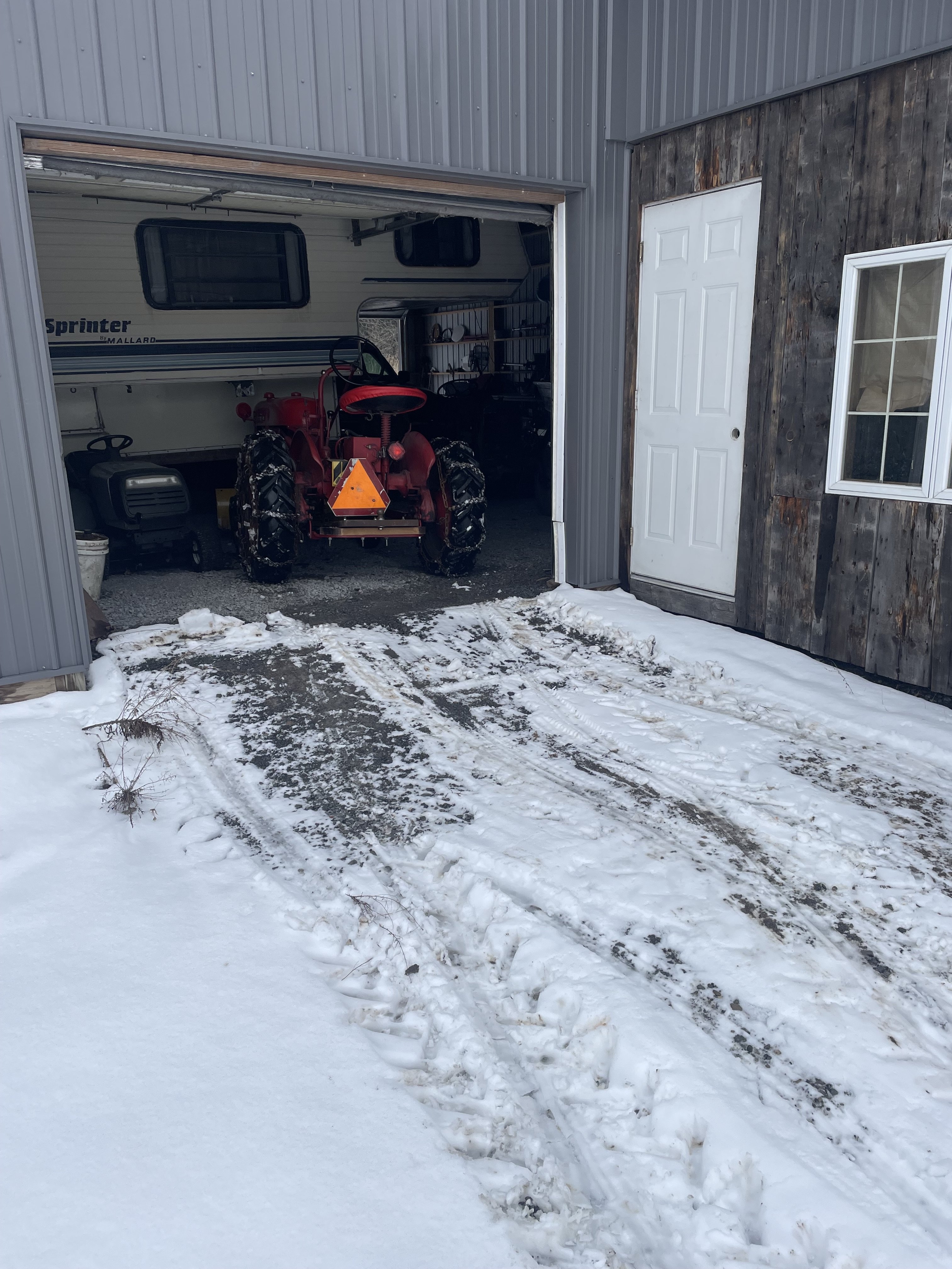

What a glorious Christmas Eve it was today. I woke up to a fresh 4” blanket of snow, that had Farmall Cub written all over it. It fired right up and made short work out of clearing our driveways. That was maybe the most fun I’ve had in the snow, since I sold my last snowmobile, over 10 years ago.

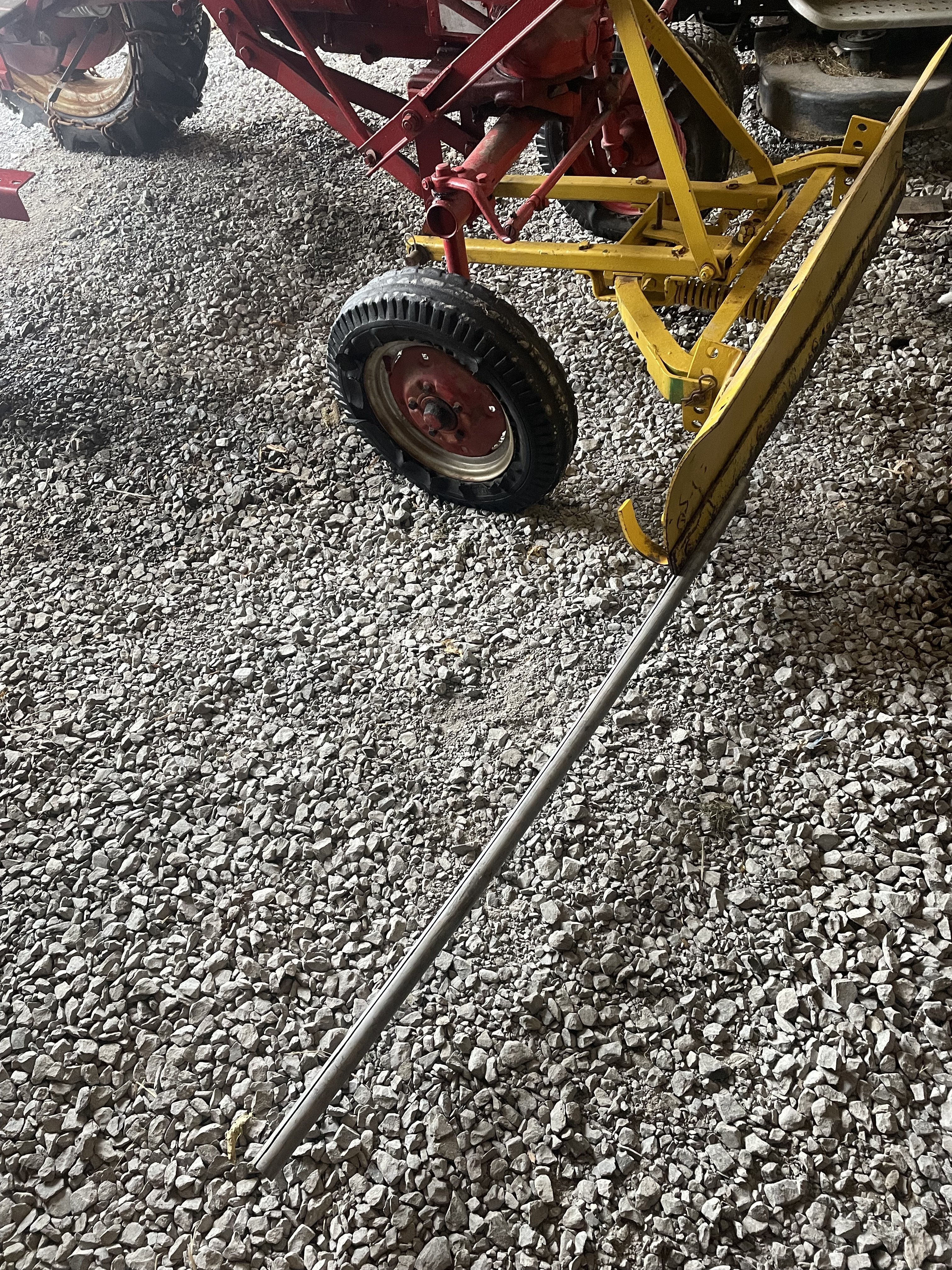

We had another 4-5” snow last week. I finished up our stone driveway, by the barn, then did the blacktop driveway by the house garage. The PVC pipe edge broke off of the plow blade, just as I started on that. I think it had gotten me thru 4-5 plowings of our two driveways and my aunts next door.
Her driveway is also blacktop so I didn’t have any trouble on that our ours, without the pvc pipe. That’s only needed to keep stones out of the grass when plowing stone driveways before the ground is frozen.
We are getting a thaw and rain now, which is supposed to be turning to snow tonight. “Just in case”, I cut and slit another plow blade’s length of shd 80 PVC, and hammered that onto the blade.

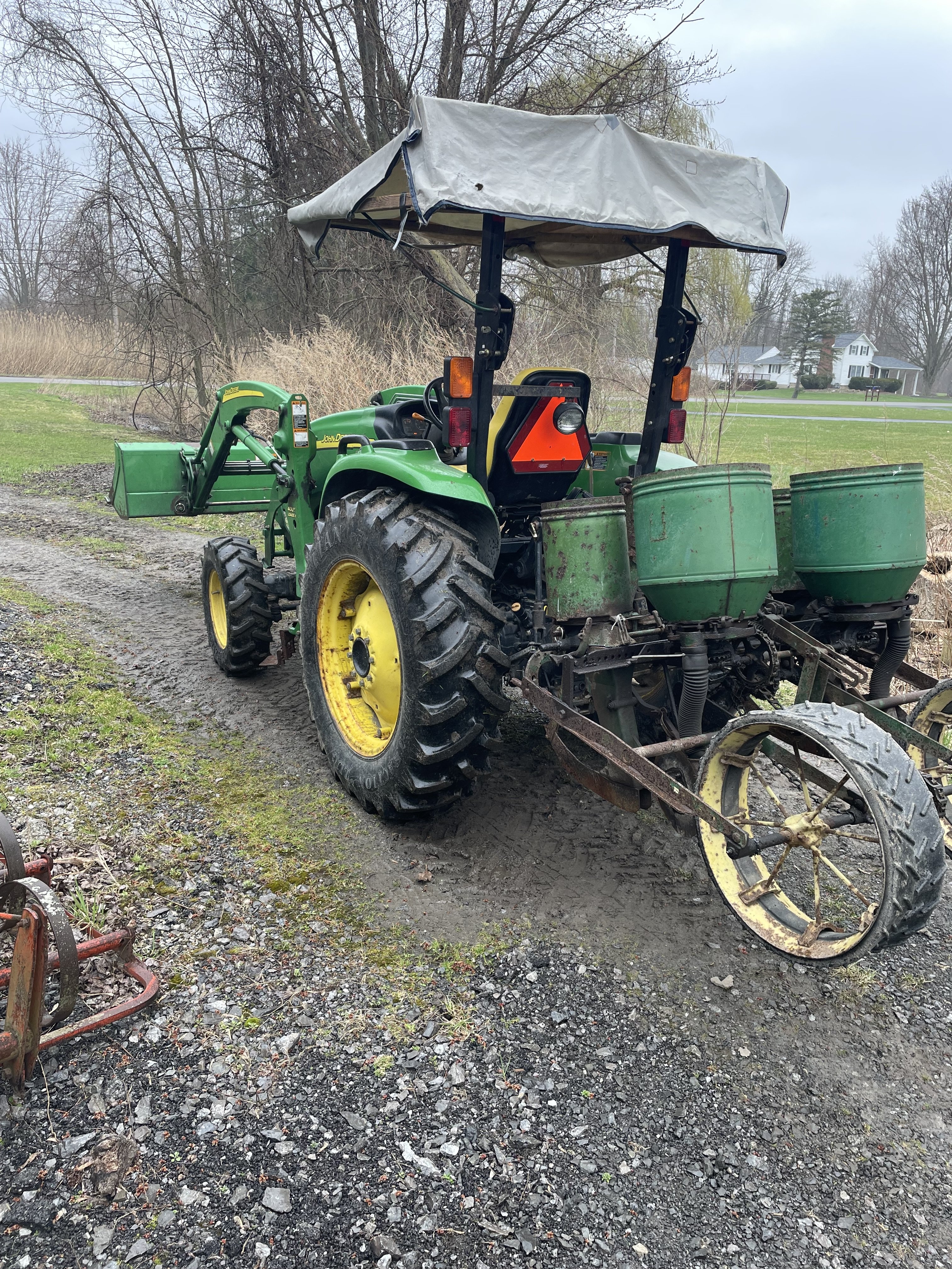

The only thing I’ll really miss the Ford for, is planting corn with my 2-row planter. There is no other make/model tractor that does a better job on that tool, than the Ford 8n. It works ok on my JD 4120, but the louder diesel engine on that makes it tougher to hear if there’s an issue with the planter, and the loader control and lack of steps prevents boarding the operators platform from the right side.

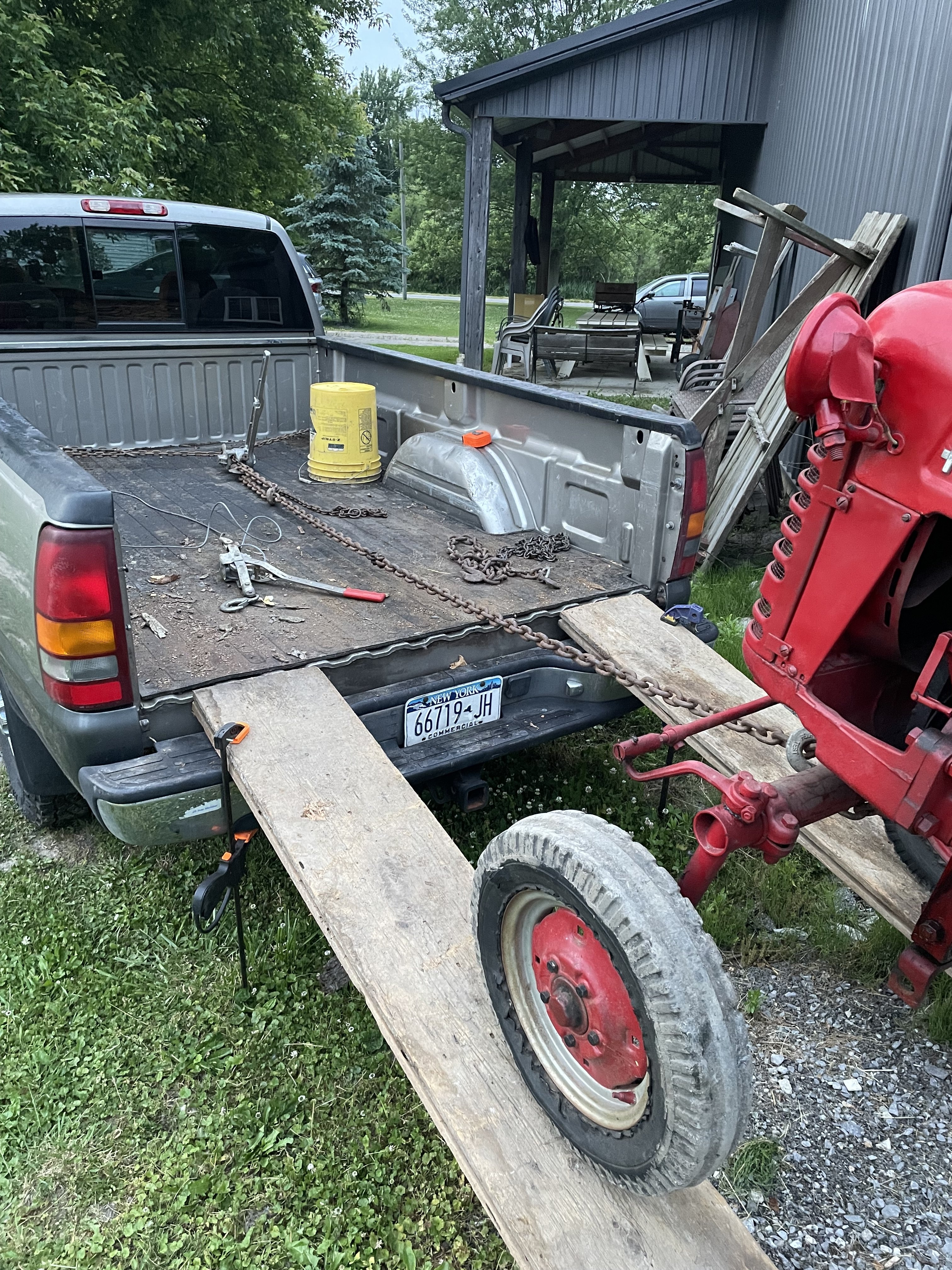

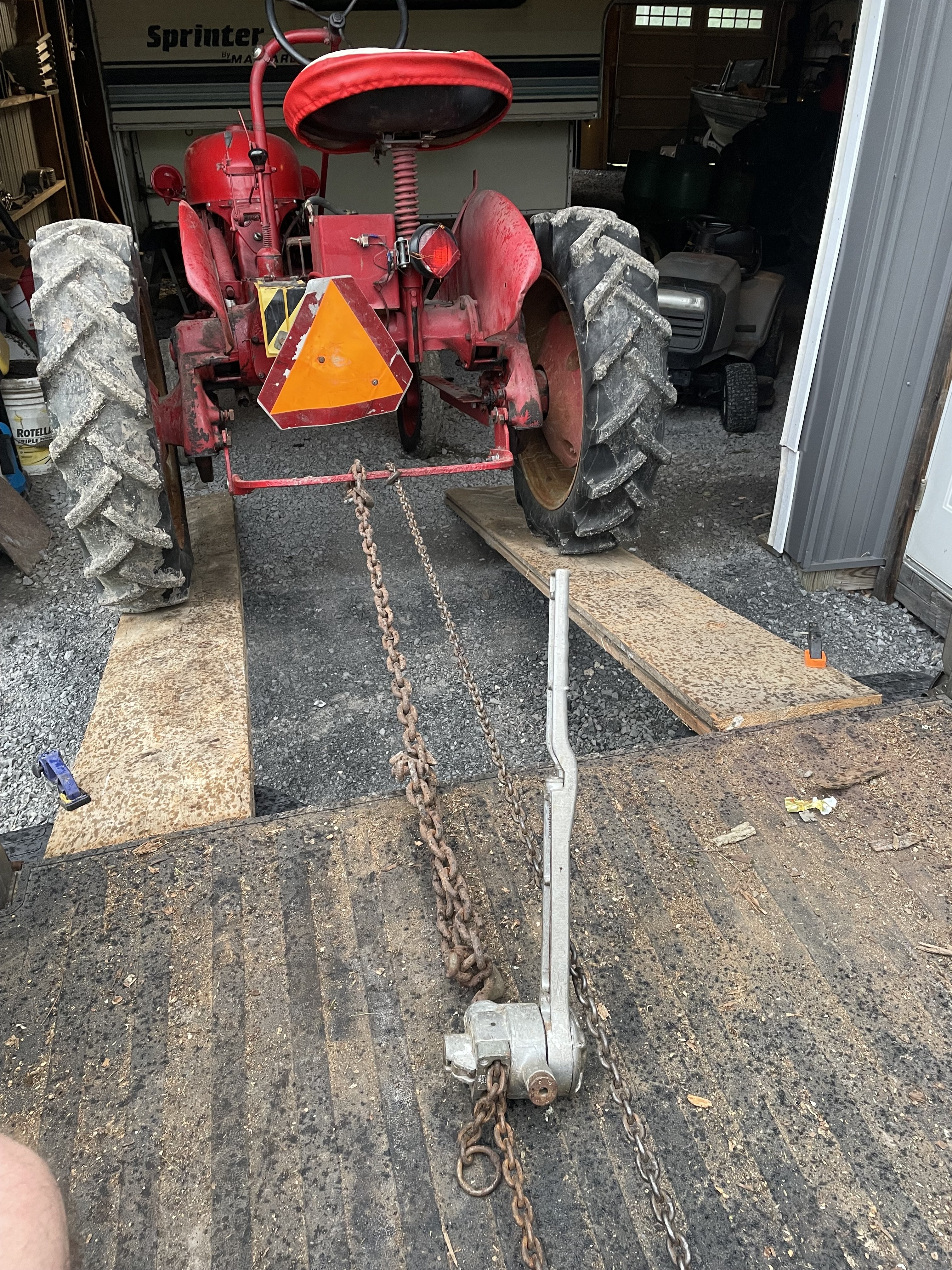

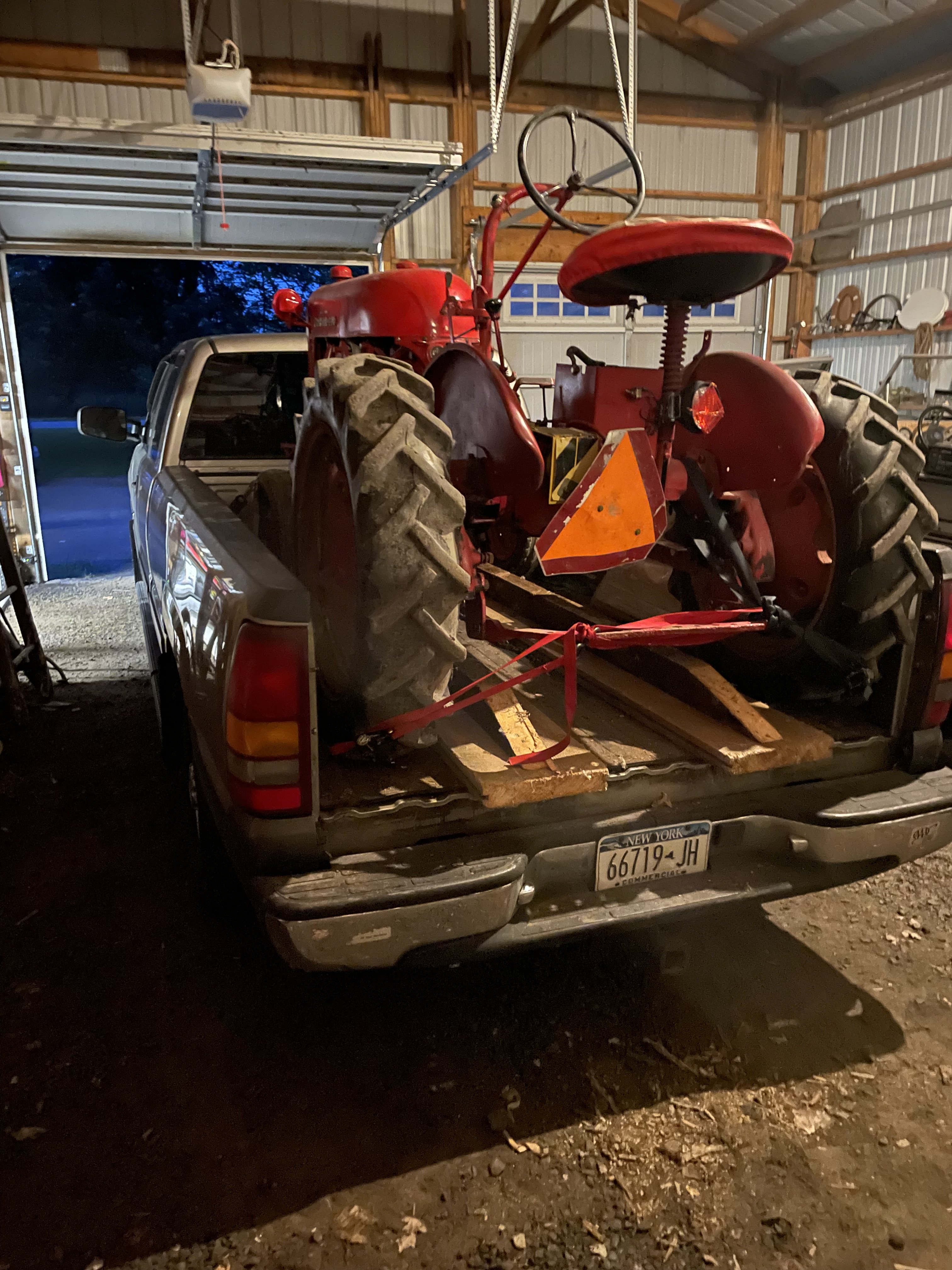

I finally got around to loading the dead Cub onto my truck after work yesterday. It sure is much easier loading a live Cub than a dead one. Now I’m ready to haul it off to my buddy’s shop. He’s the best Farmall guy in the county.
The loading took longer than it should have after my first “false start”, because the back wheels wouldn’t fit between the trucks wheel wells. The 3/4 ton CM puller, that I recently got from a garage sale item swap, worked very good for this pull. Way better than my old come-a-long.’
