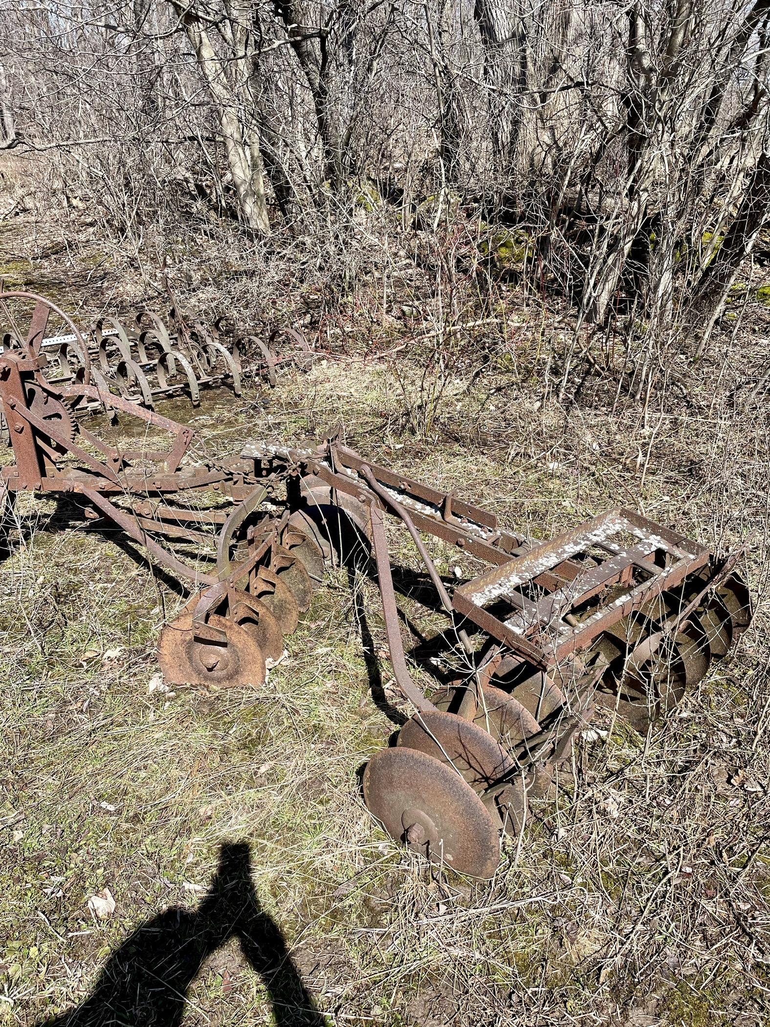

I did some work over at my parents place today. The first pictures is the (6) ft pull-type disk and the (2) section drag that I plan on using over there with the Cub.
The last picture is a big ash tree (about 30” diameter at the base) that fell down across one of the woods trails. It split into (2) sections about 15 ft up. I cleared enough of it to get a truck through the trail. The two top sections are hung up and I plan on dragging them down with the Cub after the ground dries up a bit.

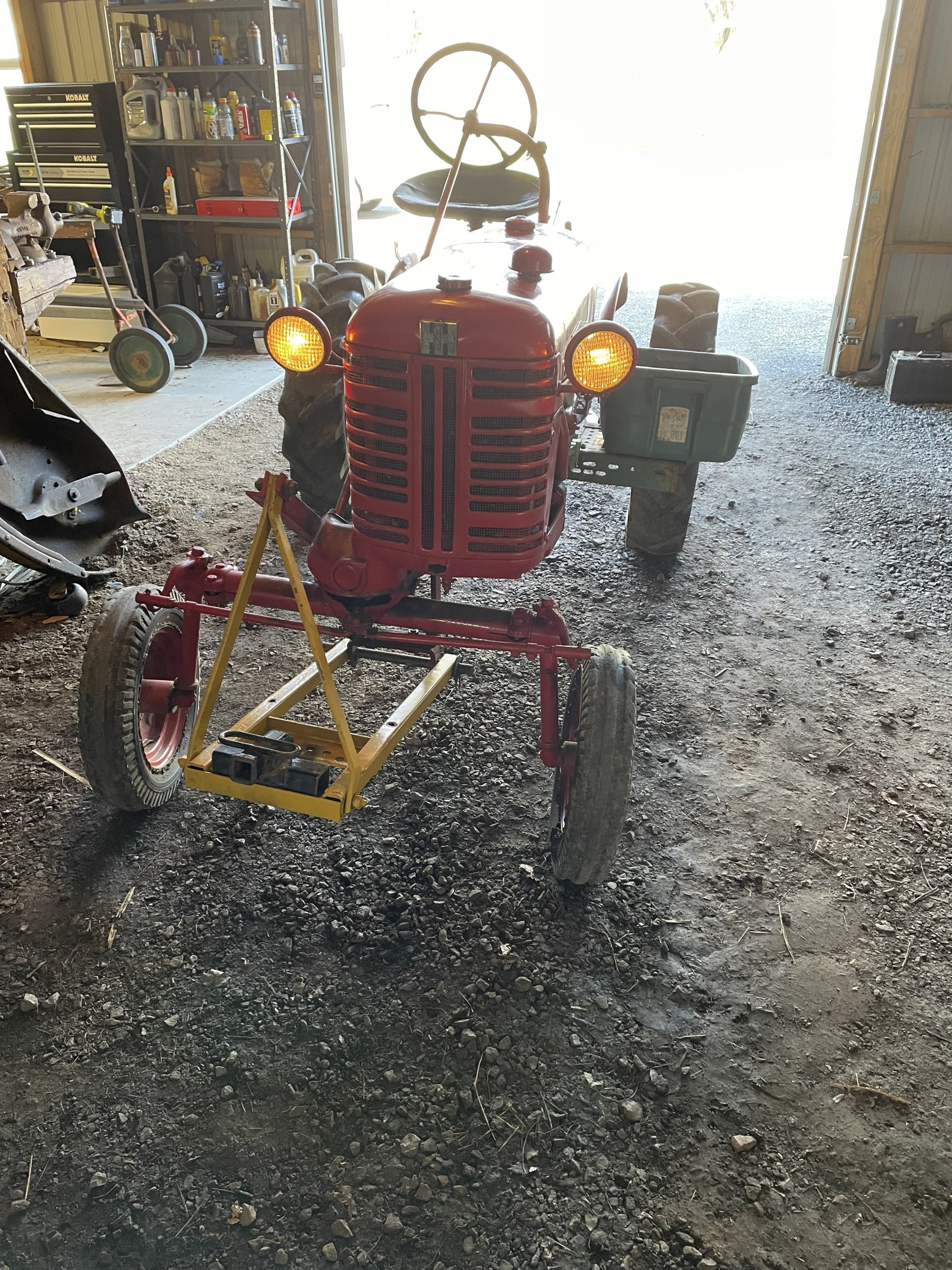

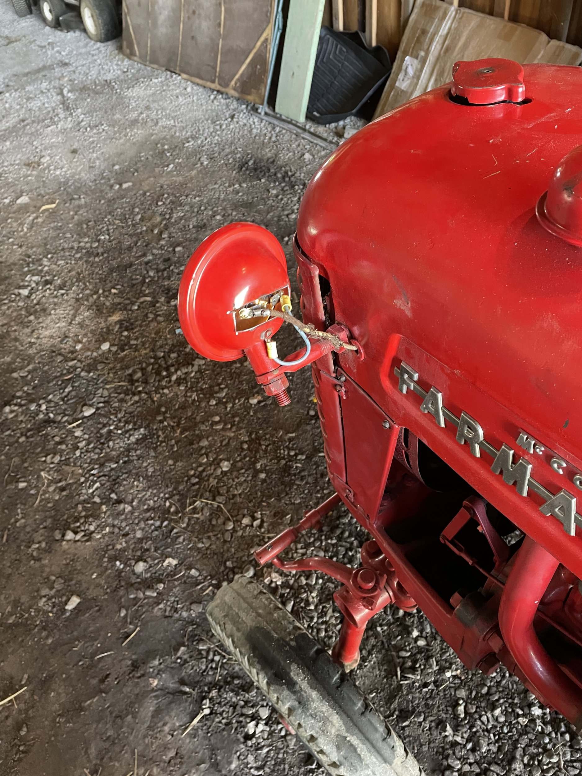

The new $ 7 ea 6 volt 25 watt sealed beam lights that I bought on e-bay arrived and I installed them today. Unfortunately, I had to modify (cut part of the back out), the oem fixtures to make them fit. I imagine that others, that cost more than $ 40 ea., Would not have needed the fixture mods. I might have forked over the extra dough for those if this tractor was a shower and not a user.
The e-bay seller claimed they are guaranteed to last as long as the originals. I guess I’ll find out about that. It’s pretty neat that they have a bright and dim setting that works, just like cars have.
I also put a separate switch on the rear light so that I can turn that off , when it’s not needed, and reduce the load on my battery and generator.

I drove the Cub around a bit after sunset last night, to see how the new headlights worked. They worked very well. The “dim” setting provided just enough light to see ok, and the “bright” setting provides plenty of light for snow-plowing with the front blade.
I’m not sure how the factory “high-low” beam switch works, because it only seems to effect the two new headlights, and not the rear work light. That seems to be equally bright at both settings. I wonder if it cuts the amperage flow in half or something like that. The 25 watt headlights got pretty warm to the touch on the high setting. That should work well for keeping the sleet off of them in the winter unlike modern LED’s which are bright but nearly useless in that respect.
I am going to make a couple more minor changes to the lights before next winter, to get it ready for snow plowing. First, I am going to pick up a small pack of black Flex-seal tape, to cover the openings that I had to enlarge on the back of the headlight fixtures. That will keep most of the rain and sleet out of them, and eliminate the distracting glare coming thru, that I noticed last night.
I’m also going to make a clip-on, clear-yellow lens cover for the rear work-light. I’ve got to get out on the road to get to our house driveway, and I plow the neighbors on both sides. I’d feel a little safer, from road traffic in the dark, with a yellow light on back.
