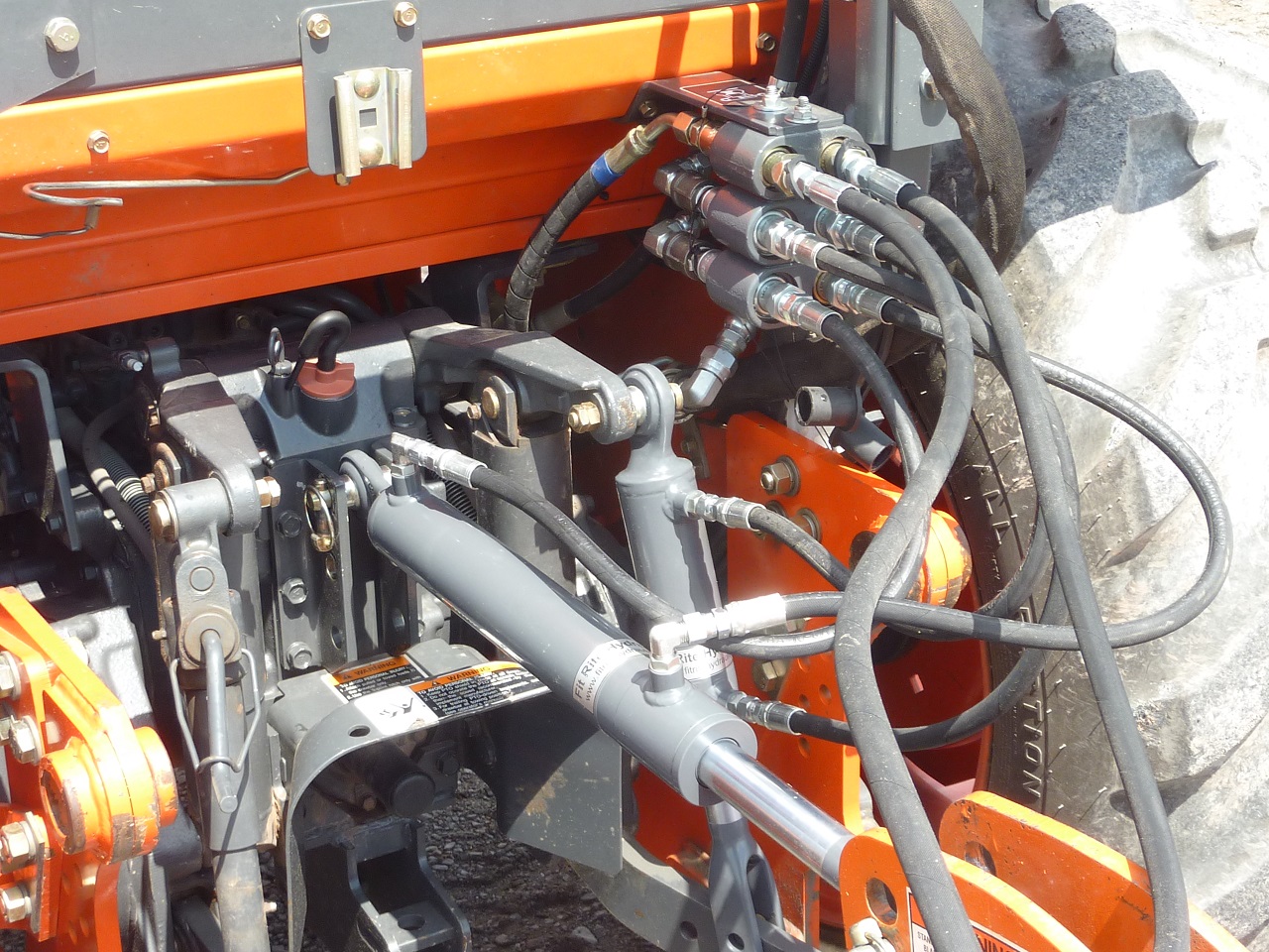

My first thing to get done is adding 3 rear remotes. I understand kubota has a kit for the 3430HSTC. Will have to price it out.
Want to be able to get a top n tilt installed along with being able to run a grapple in the future
I also added remotes to my 3430. I ordered one on the tractor when I bought it and added 2 more a few years later. At the time, 2011 I think, the dealer quoted me a price of $1200 for the parts. I thought that a bit high so I bought 2 OEM QR's to match the existing one and plumbed them up to a Prince 2 spool FEL valve. Then I ordered a T&T kit from Brian at Fit Rite and it worked perfectly. I highly recommend his work!
If you do get a Fit Rite kit and use OEM QR's, the setup will look like this on a L3430:
Looks good. Would I be able to run a third function from those remotes to the FEL for operating a grapple? (I know nothing about tractor hydraulics)

I also went with Kubota OEM remote hydraulic parts for the hydraulic block/hoses/valves/levers. FitRite for the Top&Tilt cylinders.

You can run a grapple off your rear remotes, a third function setup is easier, but very expensive. An alternative method is a diverter, Ken's Bolt on sells them as a kit.

Have to remove seat to install the tap, I posted pics on tbn somewhere. Wasn't hard, was my 1st time working with hydraulics. I order from messicks, around $1200 for 2 remotes.
At first, I used a rear remote for my grapple instead of a 3rd function valve. It worked ok but I got tired of moving my hand back and forth between the FEL joystick and the remote valve. Routing the hoses is also a pain. They tend to get in the way when disconnected. I quickly decided to spend the $800 to have the dealer install a W R Long 3rd function valve. The grapple operation is much smoother and can be operated with one hand.
Another tip on adding rear remotes. I suggest you add at least one with a float position. With the T&T kit, it comes in handy to use with the top link cylinder on implements like a mower or brush hog.
