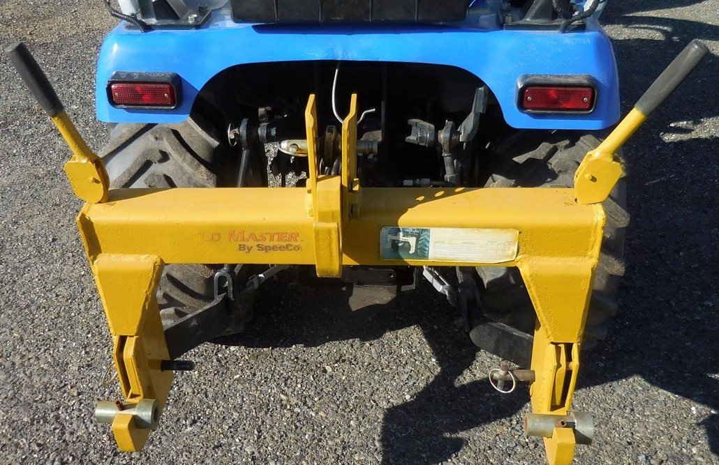

Since I purchased this tractor last year and repaired the transmission crack,
it was my first time to hook up the brush hog for major weed mowing.
Hope, this video helps someone who needs correct connecting and adjustments for the brush hog.
If you have any better method, please share your thoughts.
Thank
Jkk

Quick hitch.... Makes life much easier....
I used to have that quick hitch.
It could be for one implement only, not for all of the implements that I have unless modified all 3 point tractor implements.
It could be so complicated that I couldn't do that.
It was given to my friend unfortunately
Jkk

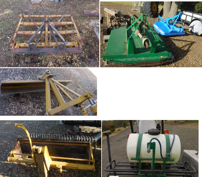

Jkk
The point of a quick hitch is all implements fit a "standard" hookup.... If implement does not fit correctly its the fault of manufacturer not building implement to standard....
For each implement that does not fit correctly you modify it once and be done, hook up is always the same.... With several different implements of different dimensions you will struggle ever time you change implements...

Same experience here.....bought the same quick hitch many years ago when my tractor was my primary equipment and I had to change implements alot - could not get it to work with any of them; it actually made it more complicated if I recall. Ended up never using it. It sits in my junk pile today still......
Does it? Really? I have gotten pretty good at changing implements. Having a flat spot to do it makes all the difference and I set the larger attachments on wood blocks so I have more vertical space to line up the arms. I don’t know if the extra weight and moving the implement farther back is worth it unless you need to change attachments multiple times every day, especially on a small tractor.

There are no true standards on 3 pt implements. Quick hitches are a modern thing and most older implement’s do not work without modifying them. That being said most modern implements are junk and the old stuff will be around forever
/ Brush(bush) hog connecting to the compact tractor. #13
When I park mine, I set the front corners on a 4x4 and the back corners on a 6x6. It makes the hook-up much faster and the 3 point quick-hitch is much easier for me.
/ Brush(bush) hog connecting to the compact tractor. #14
Pat’s Easy Change - best add on ever.
