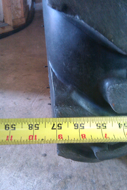

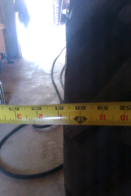

   / Brush Cutter for Jinma #13
Not sure where you got your info Greg but my rears are 61 wide and the fronts are 57
Chris.

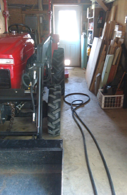

   / Brush Cutter for Jinma #14
Last pic is my tractor, 60" bucket, and my 72" Caroni finish mower.
Chris.

Imagine that, the manual is wrong. I know as a current owner they are much wide than you say.
I have done nothing other than set it to wide stance. There must be some changes since you had yours but you can clearly see my 2003 Jinma 284 is every bit of 5' wide as it sets.
You can clearly see that there is no more than 4-5" on each side of my rear tires and my 6' (72") Caroni Finish Mower. You can also see that the 5' wide bucket on my FEL is the same width as my rears and my fronts are slightly narrower.
Chris

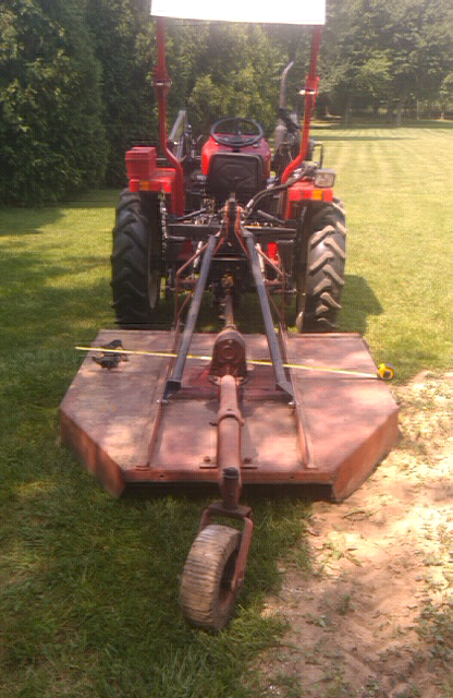

   / Brush Cutter for Jinma #20
On my way to bush hog with my 5' (60") Ford cutter.
Cutter is actually 64 wide.
Chris
