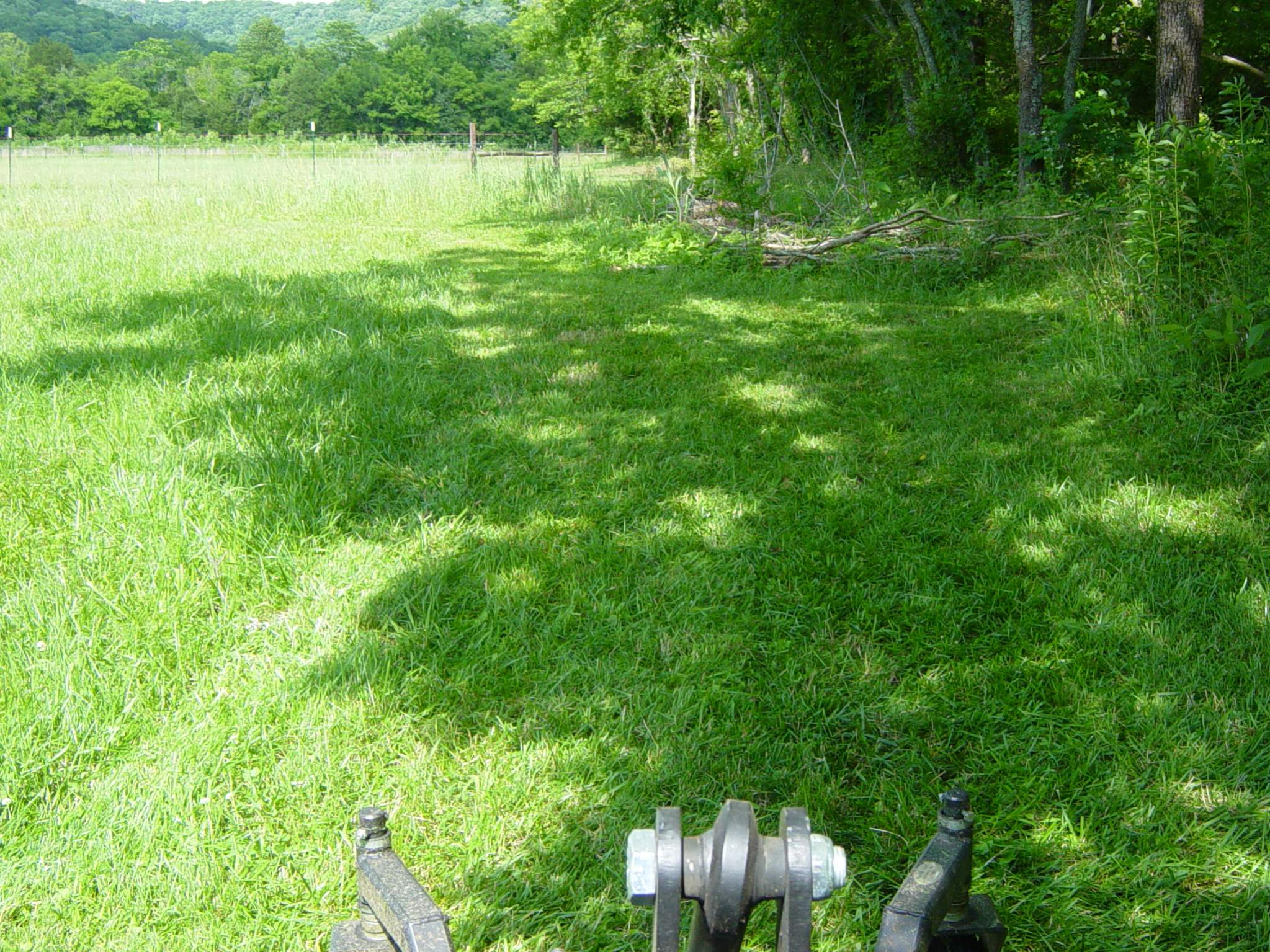

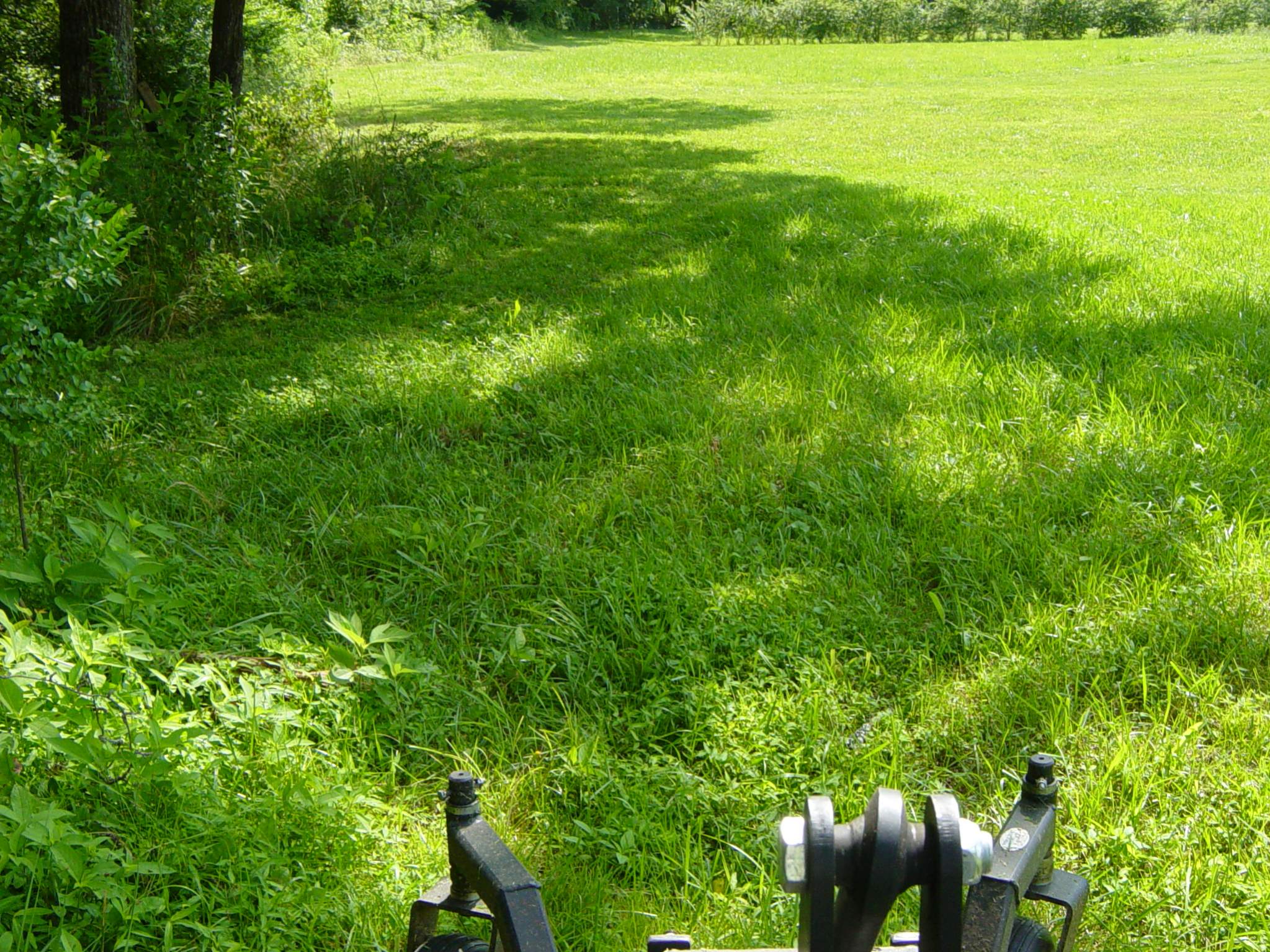

Twas me that bought the disc kit. As described above: a large disc with 6 smaller rigid blades do the cutting. I use it to cut thick grass/hay and as a finish mower. The "finish" will not win you awards in the neighborhood-best-lawn contest but gets the job done when I don't feel like dragging out the reel mower for the "nice" grass around the house.
Two 3/8" bolts hold each blade to the disc. I put grade 8 in the rear hole
and crap grade in the front hole. On the occaision I hit a rock, the light grade bolt sheers off. I replace and keep on cutting.
I have not had the need to switch back to the brush blades. We only have about 4 acres that are mowed...we keep 1.5 cut on a regular basis and cut the remaining amount twice per year. There's no heavy brush. Works fine.
Warning! The disc kit turns so smoothly there is virtually no vibration...when you shut down, and still have ear muffs on, you can't hear it turning. It takes about 45sec for the disc to stop turning. Look for stopped blades before checking for sheered bolts!!!:eek:

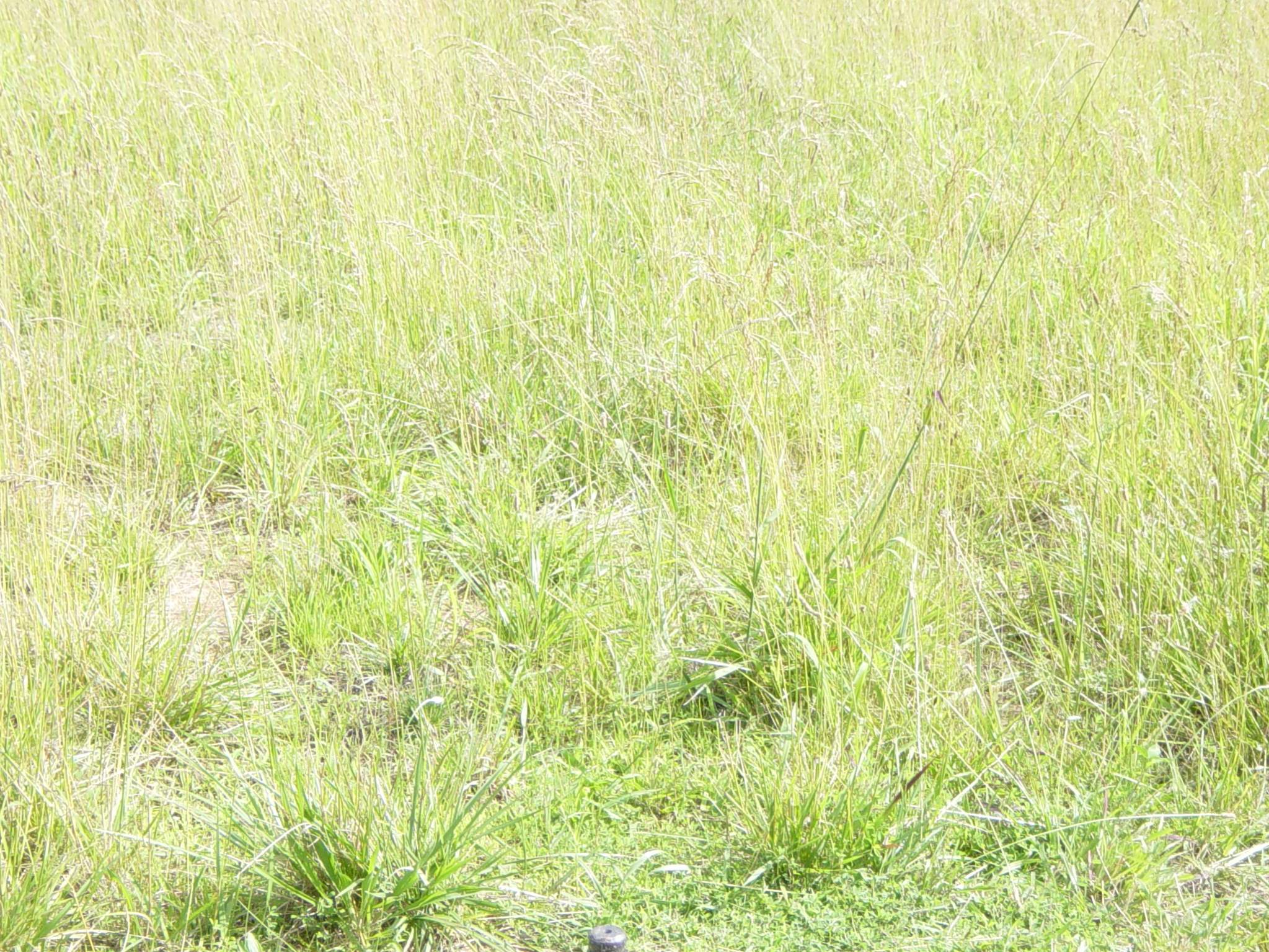

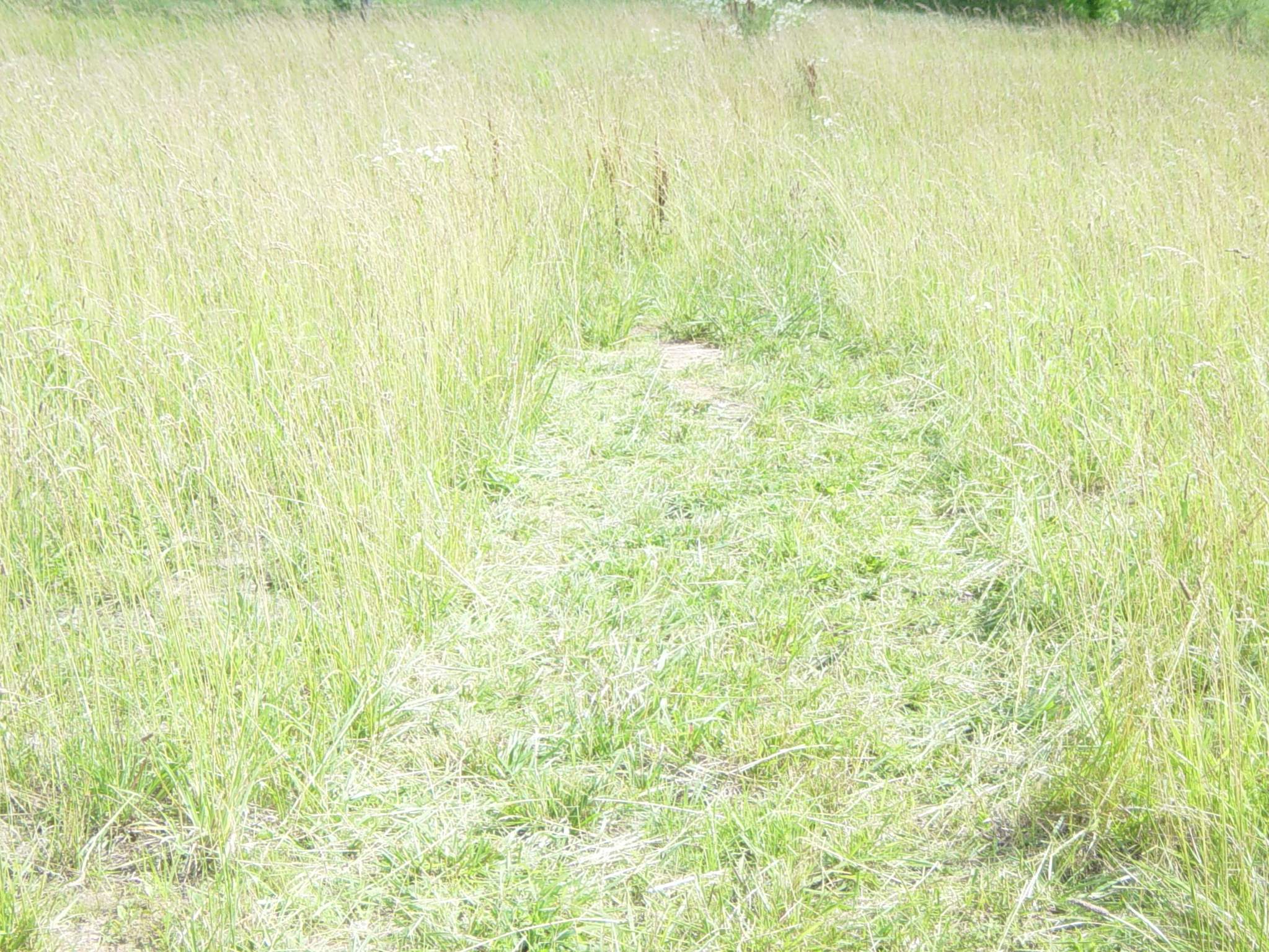

It cuts "thick" grass better. I guess because of the smaller blades (about 6" long) are whirling around at fantastagorical speeds.
Was it worth it?....I have not thought it as a waste of money. Yes, I would purchase again. Keep in mind it is truly something between a brush cutter and finish mower. It can do both jobs but not at extremes. I wouldn't brush cut woody material thicker than .5 or .75 inch. I'm saying that "just because" I don't know the upper limit of that thing! And don't want to find out!

Here are a few pics of some before and after shots...
