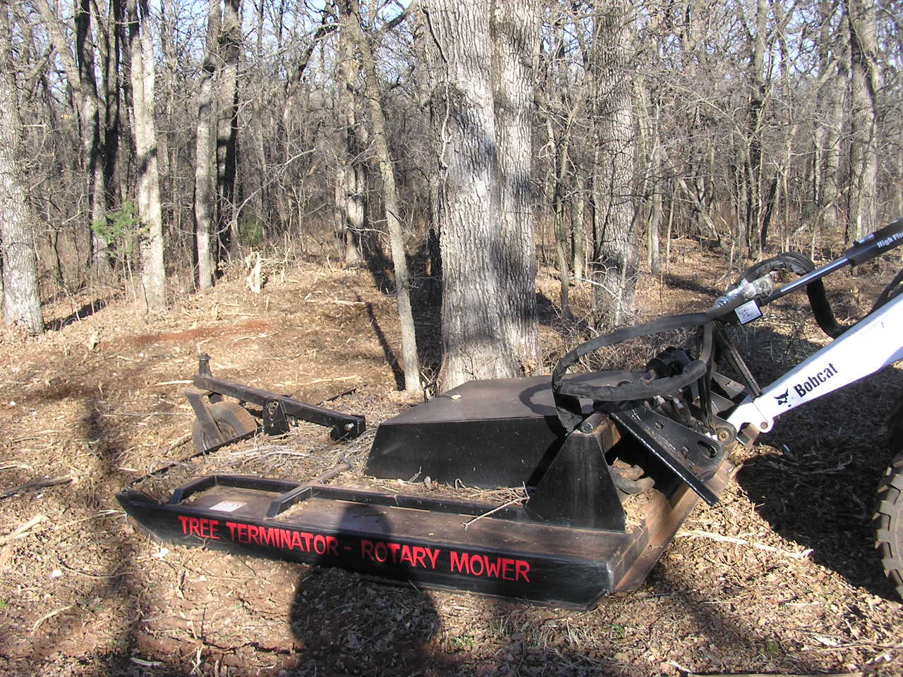

If you will never need a high flow attachment like a forestry mulcher, consider building a smaller lower flow version of the PTO driven Land Pride unit that Dave posted.
Our 7' brush hog rarely reaches the bypass pressure. When it does I slow down or stop and let it speed up again.
Note the cushion valve built in to the motor and 3/4" hoses:
