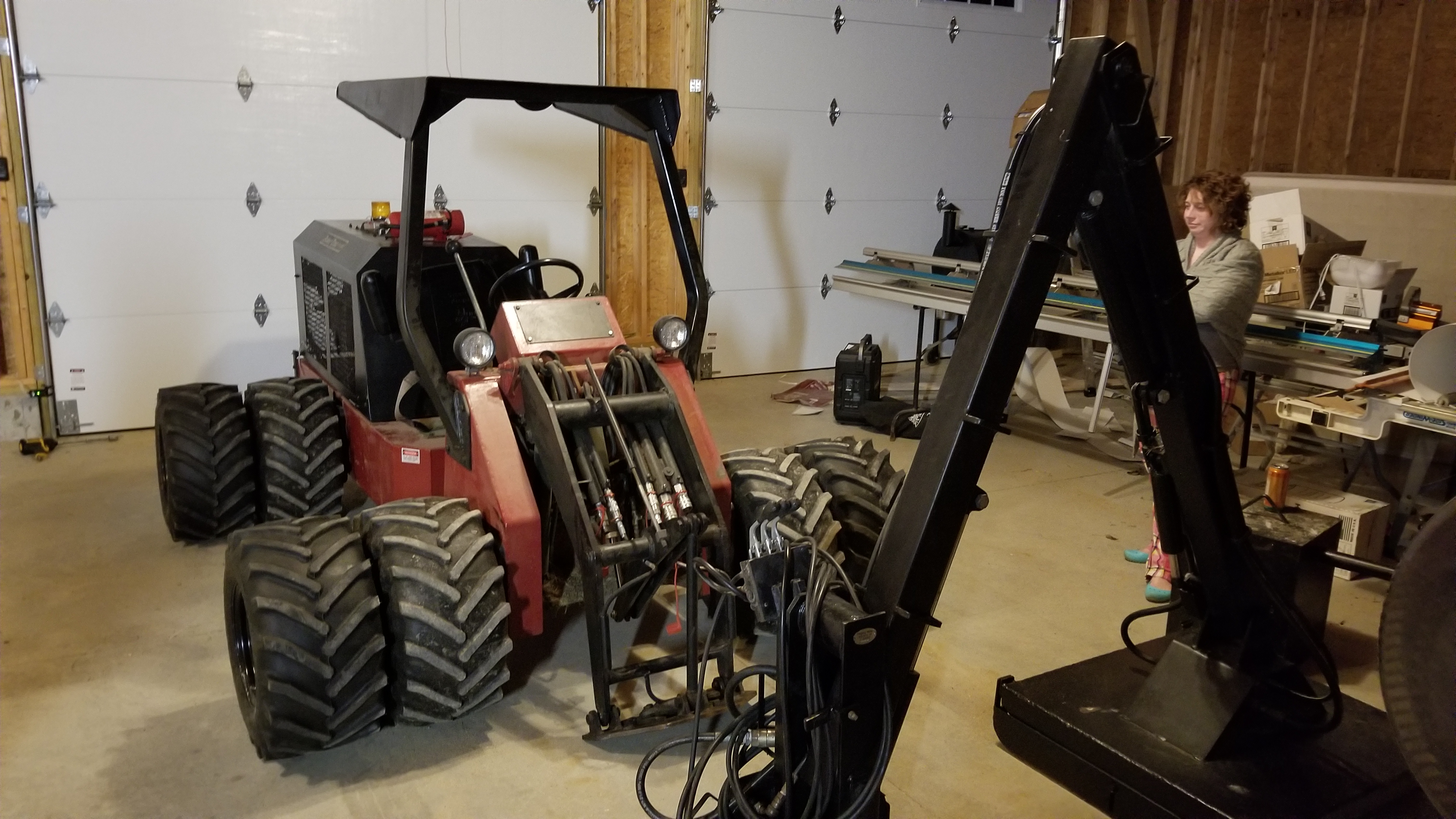

Now I have this for the front of my PT. Haven't used it yet....

Well you got the machine to drive it too. Yes a boom mower would be fantastic...but too many dollars considering the task at hand. And bet they are, ask you said, a son of a gun to get attached.

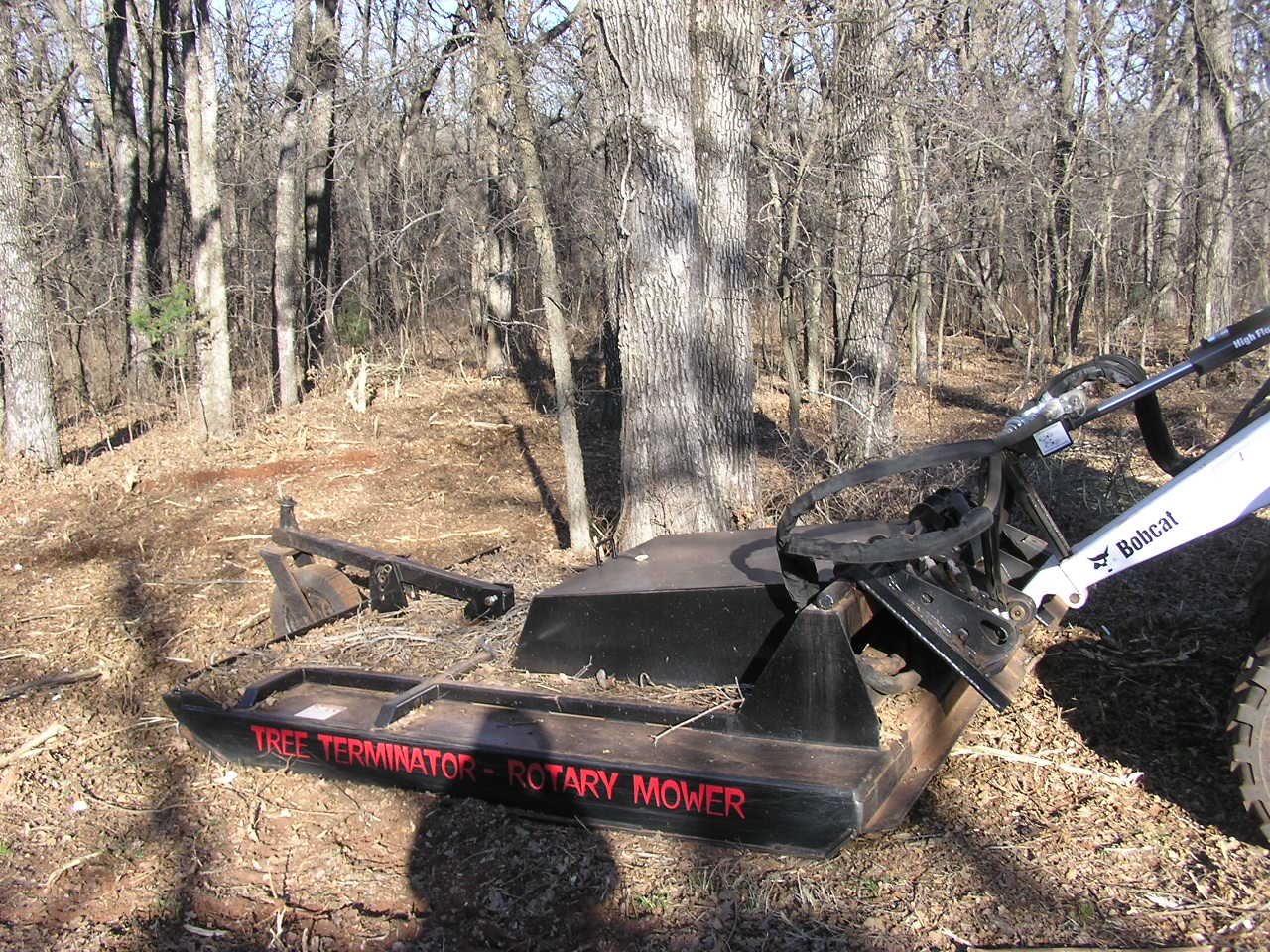

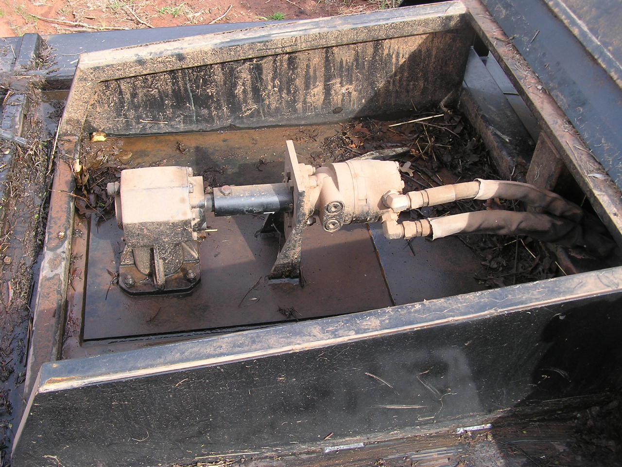

If you will never need a high flow attachment like a forestry mulcher, consider building a smaller lower flow version of the PTO driven Land Pride unit that Dave posted.
Our 7' brush hog rarely reaches the bypass pressure. When it does I slow down or stop and let it speed up again.
Note the cushion valve built in to the motor and 3/4" hoses:
What motor is on that setup ? What gpm does your telehandler run attachments?
