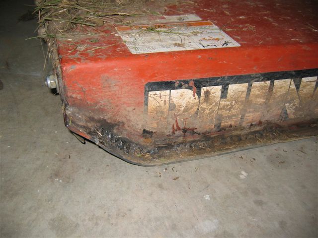

Well I finally got around to fixing my brush hog. Here is the picture. I hadn't welded in 33 years and some of them aren't pretty, but hopefully it'll hold. I got a piece of 3/16 strips about 48" long at Tractor Supply and used 6013 1/8 rods on a Honda EW171 DC welder/generator that I rented for $60 a day.
My next problem is that I lost my tool for changing out wheels on my angle grinder and it wasn't doing a very good job grinding although I used it to cut the steel.
I replaced a 3" section on the other side of the 'hog also. We'll see how it goes.

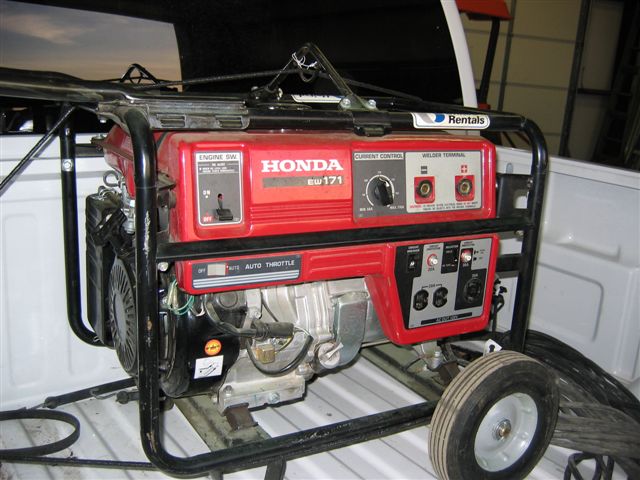

Here is the welder I used. Boy did it run good! I used mostly about 110 amps, dropped down to 80 for a place where the runner has been worn down real thin.

The only thing I changed was the position of the tail wheel. I believe I raised it thereby making the back end of the cutter lower. The only problem I have now is sometimes the rear end picks up on even ground, leaving the grass not cut well. Not really that often, but in a few spots.
   / Brush Hog damage #18
If the rear end picks up, then you need more slack in the top link so the rear wheel controls the height of the rear of the deck. But not enough slack that the rear of the deck can't be lifted with the 3pt arms, and not enough that the front of the deck hits the PTO shaft. Somewhere in between is the 'happy' place to be. /forums/images/graemlins/grin.gif

A recent thread, How Much Slack Do You Give Your BrushHog? tries to tackle this question. 3PH height and toplink length offer a large range of possible adjustments. The "right" adjustment for one stretch of terrain can be wrong moments later as terrain changes. Of course, the 3PH is easy to adjust "on the fly", but a manual toplink makes you choose an adjustment that is OK most the time, but lifts over grass sometimes (toplink too short) or risks deck-to-PTO shaft contact (toplink too long) sometimes.
Anyway, what I learned was the the right adjustment is a dynamic thing and that anywhere in the full range of 3PH and toplink motion can be useful and right in certain situations. An hydraulic toplink is marvelous, but requires you to be alert and keep the adjustment appropriate. A manual toplink adjusted so the deck can raise toward the PTO shaft, but will not contact will allow moderately good terrain following and not risk equipment damage.
I agree with beenthere. Good work on your welding project. Happy BrushHogging!
