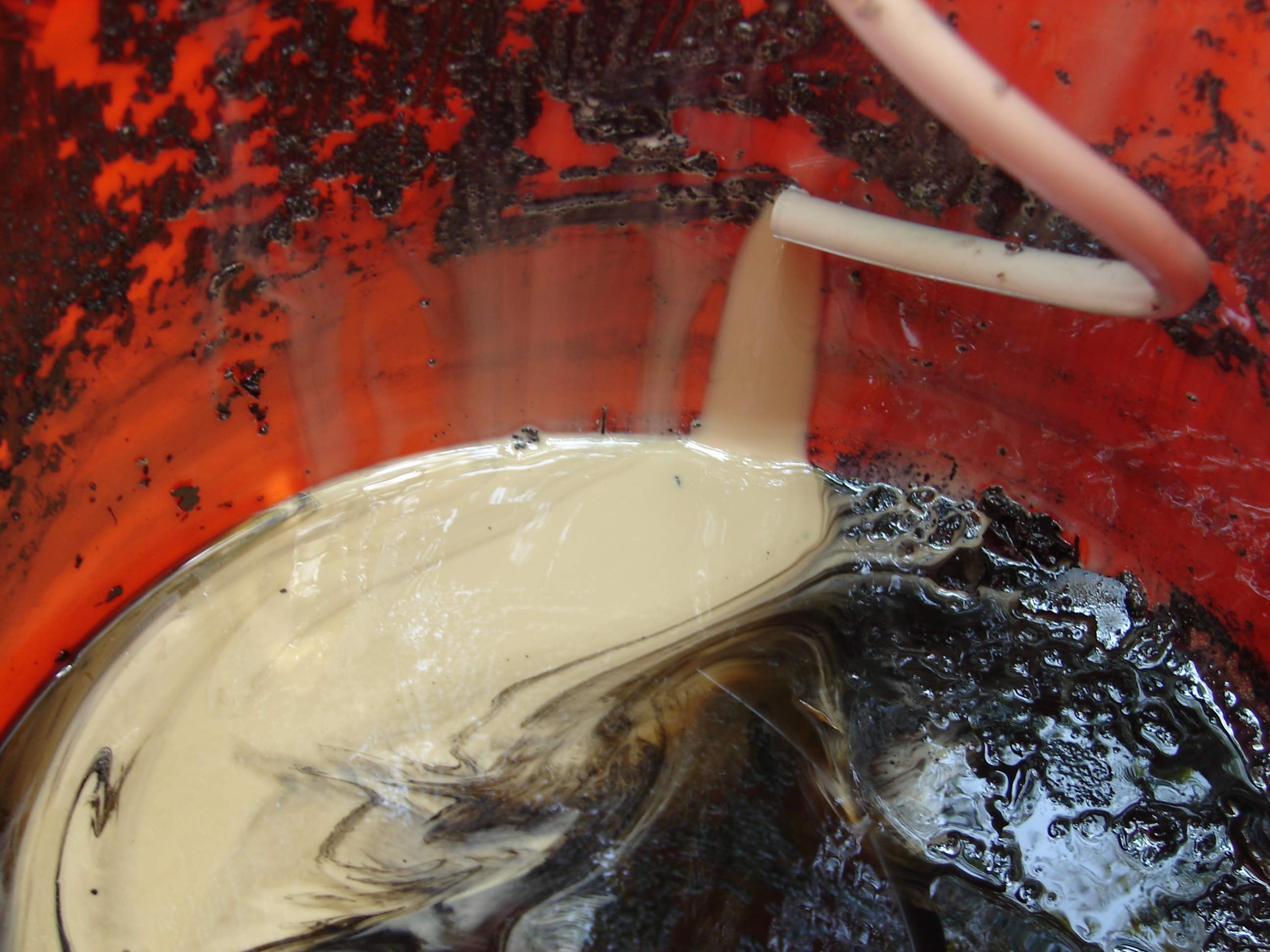

Here is a picture of the gear box fluid that I siphoned out. Looks like melted ice cream. The dark, oil-colored sludge was in the bucket from my last Kubota oil change.
This look like anything legit?
I drained out a quart of the stuff and put in a new quart of 80W-90. I could not get all of the old, cream-colored stuff out, so some is mixed in with the new, oil colored gear lube. Anything I should watch out for now?
Water/moisture contamination. Make sure that the filler plug is secure. If you wash the mower off with hose or pressure washer be careful not to hit the shaft seal or gearbox breather which could get water in there. Next time you change the oil, if you find something like this you can flush the gearbox out with diesel fuel or kerosene.
   / Brush hog gearbox...oil or grease? #25
many times the filler plug has a breather cap.. so over years of use and heat cycles, condensation can make it in.
yep.. that milkshake was water emulsion for sure..
