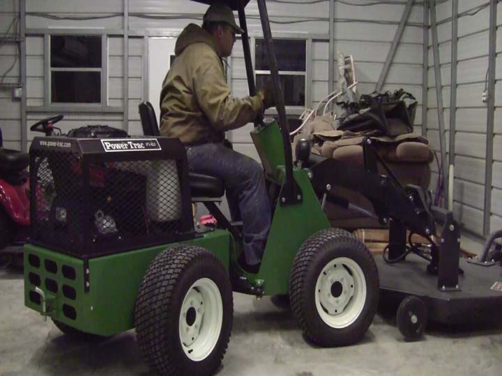

Other than the PT label which had PT's serial number/model number then there were no other info on the motor.
I'm no hydraulic expert but could somebody extrapolate the motor size given the 425s 8 GPM PTO if we also new the RPM's which the mower turns?
I tried to count the revolutions but lost count after .001 seconds! :laughing:
Jim
You can do this if it is a direct drive situation. If you are talking about hyd motor pulleys and belt setup, you can still do it but must know all the particulars, pulley size, blade shaft rpm, etc. It's almost like reverse engineering.
Say I want a 48 in brush hog blade shaft to turn at 1000 rpm, and I have 8 GPM supply. The displacement of the hyd motor that will allow that is 1.85 cu in. I use the tech help section of Surplus Hydraulics, calculator section, hydraulic motor speed and torque. Knowing two things, fill in the boxes will compute the third.

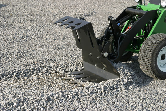

Have you seen this product? Watch the video
http://www.ratchetrake.com/
You can mount the Ratchet Rake on just about any bucket, except the 4 in 1 bucket.
   / Brush hog hyd motor #18
Once you break surface tension, you will have wheel spin. Yes, if you double the displacement, you will increase the torque. You will have a better chance of spinning tires with the increased force. Although that gives more power, and reduced speed. You need more weight to keep surface tension. Just add some weight.
If the rear wheels are spinning , add weight to the back. If the front wheels are spinning, put a load in the bucket and that will help.
Ratchet Rake, LLC - Tractor attachment, Bucket attachment, Loader, Skid loader, Kubota, Skid steer, Landscape rake, Brush remover, York Rake, Harley Rake, Rock Rake, Tractor rake attachment, Construction attachment, New Holland, Bobcat, Fire safety,
Thanks JJ. That is an interesting device. I have a small bucket with teeth and the utility grapple that I was hopping to use to pop out small saplings and brush. My brush mower attachment will handle this but will leave 2-4 inch stumps that will injure short legged dogs and probably me. The grapple shown below should work. I guess I need to add weight to the rear of the PT-425. The rear of the tub is vented, so probably the only way to proceed is to replace the standard hitch with a 2" receiver and have something built to carry weights.
