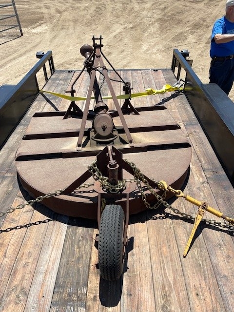

Things I'm still wanting to do to it. Add skid plates 2x2 angle to the skirts.
Add chain to the front opening. Can anybody recommend a size and spacing for the chain? Replace broken grease fittings and grease. After testing - if warranted... paint
PICS TOMORROW

Lol. Life and work are getting in the way.
Also gathering materials to improve on the deck. Extending the front edge 4" so the blades don't stick out past the front of the deck anymore and adding a chain guard. I'd like to make this experimental mower conversion as safe as I can. Will post progress when it is made.
Went from making my own chain guard to buying a manufactured 5 ft curtain. Meanwhile we can extend and patch the deck so it completely covers the blades...something this 1950s beast never did :oops:
Thanks for asking

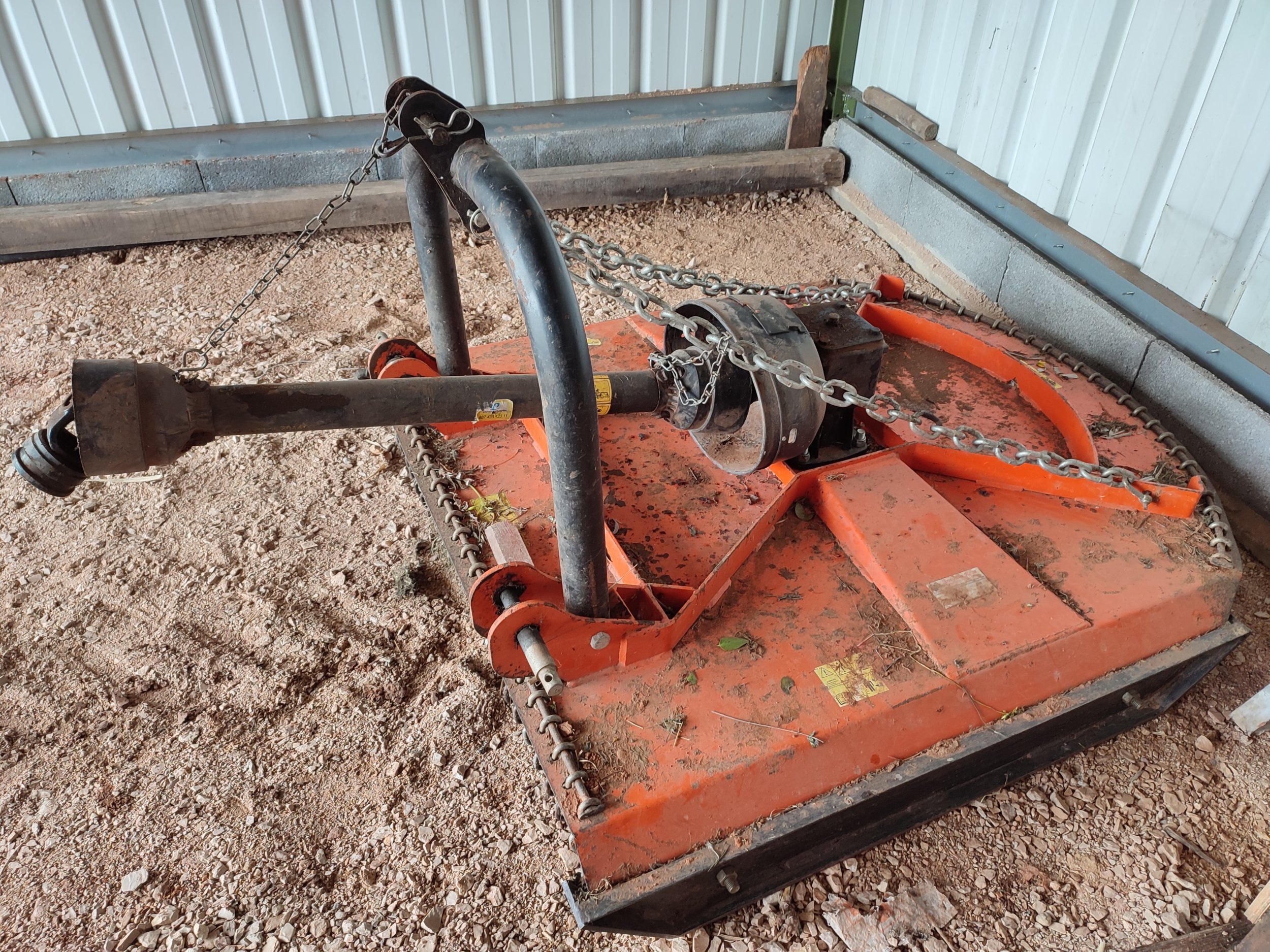

Here is a picture of mine back in 2019. Around 200-ish hours on this set of chain. I run mine very close to the ground, so it tends to dig a lot and wear out faster. I would say 400 to 500 hours per set of chains is a good time frame, but depends on a lot things.
You can see how thin the chain gets on the end that see all the work. You can also see the cracked link I keep talking about. This how these chains wear out. The link gets so thin that eventually it breaks. People will often run them till they get 1 to 2 links shorter before they get a new set, basically reducing the cutting width till it's a bit too much.
I still haven't bought a new set, even though it's less than €30.

And another,

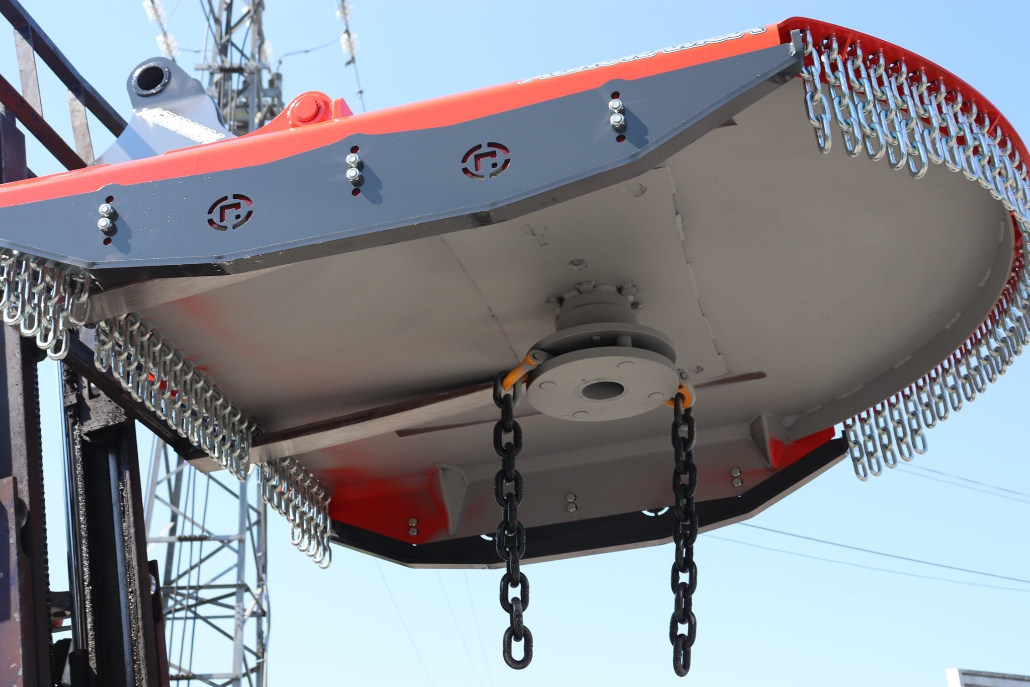

For anyone interested, here is one of these cutters working:
Also, how one of these mowers look underneath and on the top:
View attachment 809784 View attachment 809785
Those little chains 'round the edges are 'new to me' and an interesting feature. I also noticed the lack of a wheel on the back. I'd assumed 'they all had one.' Live and learn. Thanks for sharing the video ;)
