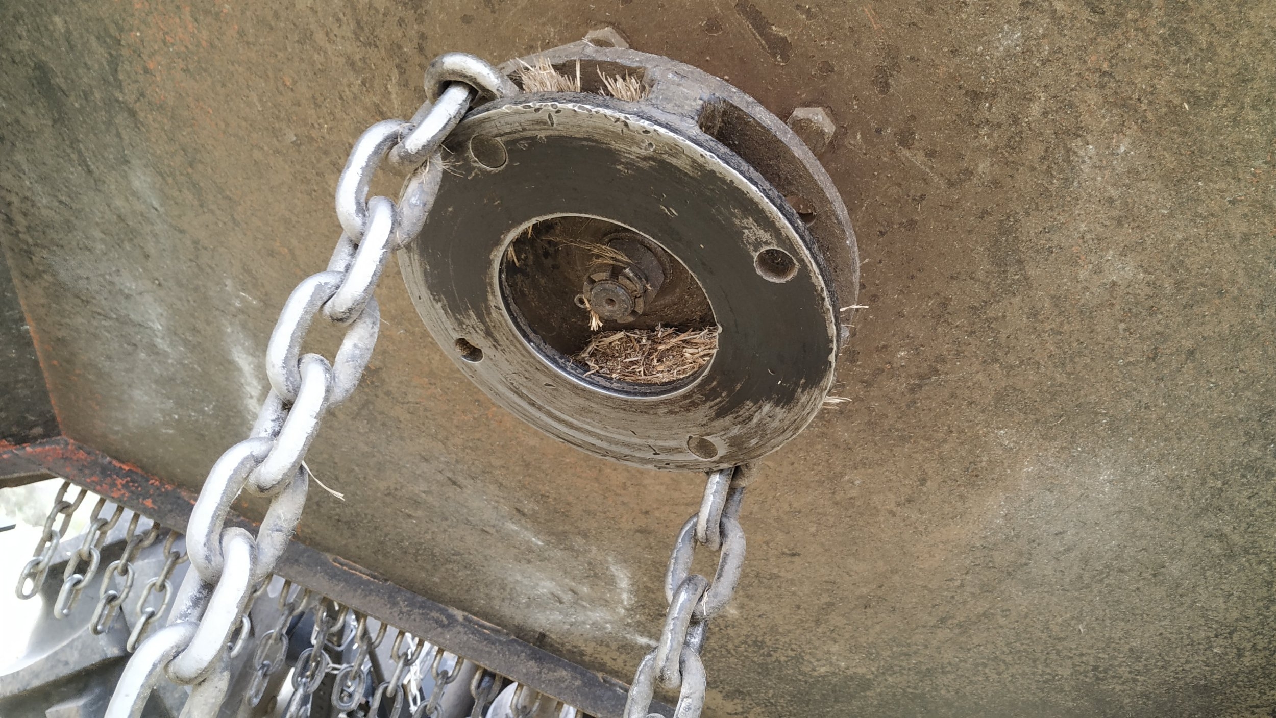

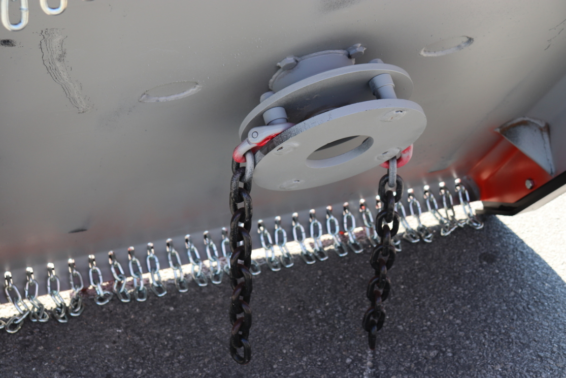

The odds of your round flywheel assembly throwing the chain out of the mower deck are significantly lower than in a design where there are rotating arms that could sling a broken chain outwards.
Did you fabricate yours or did you buy this assembly somewhere?
/ Brush Hog mods #22
I bought mine. €650 in 2017. Just couldn't beat that price if I were to buy the materials, gearbox, PTO shaft, etc.
I've made one before for the Kubota B7000 I had. That one I used blades because of the low HP available.

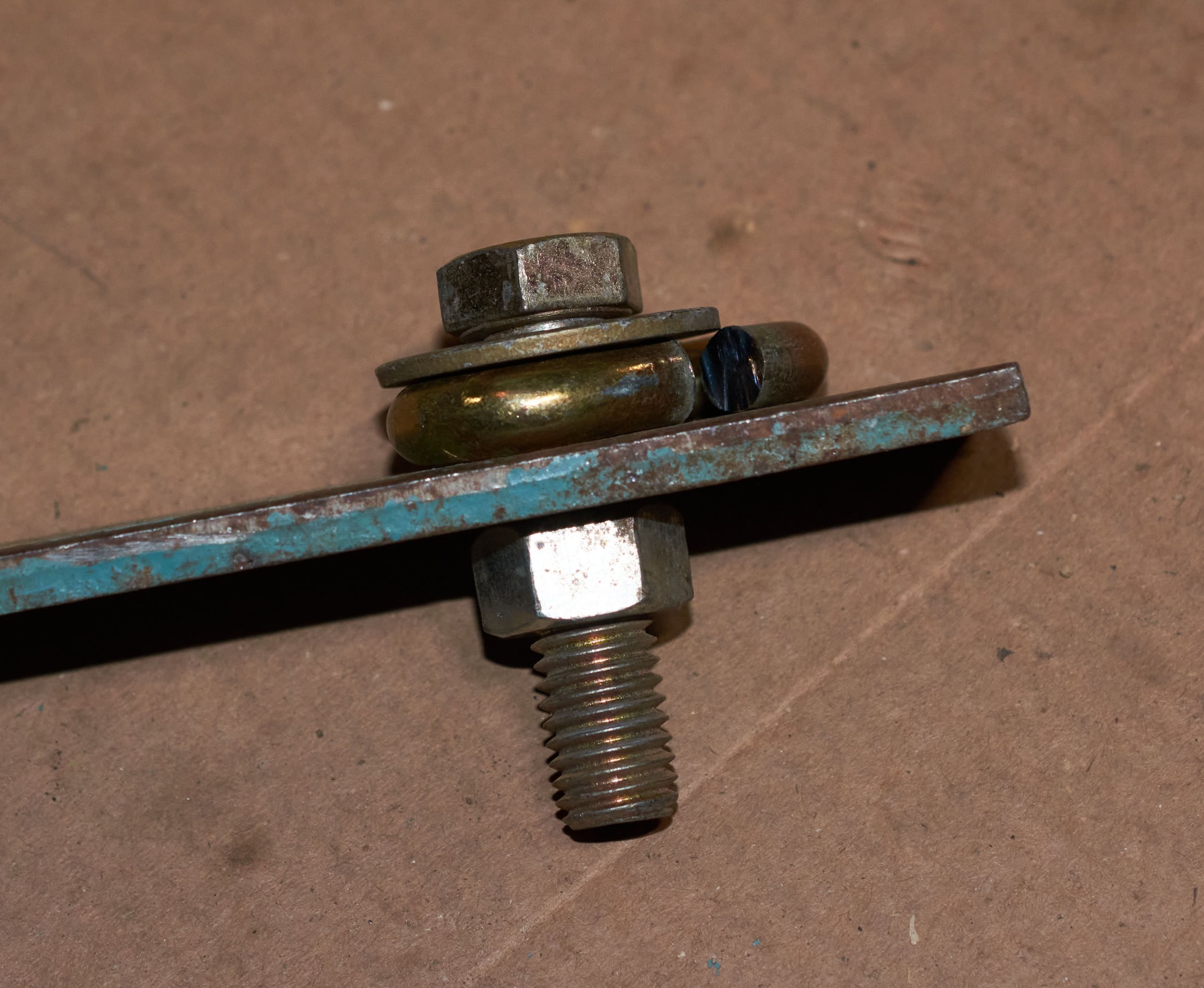

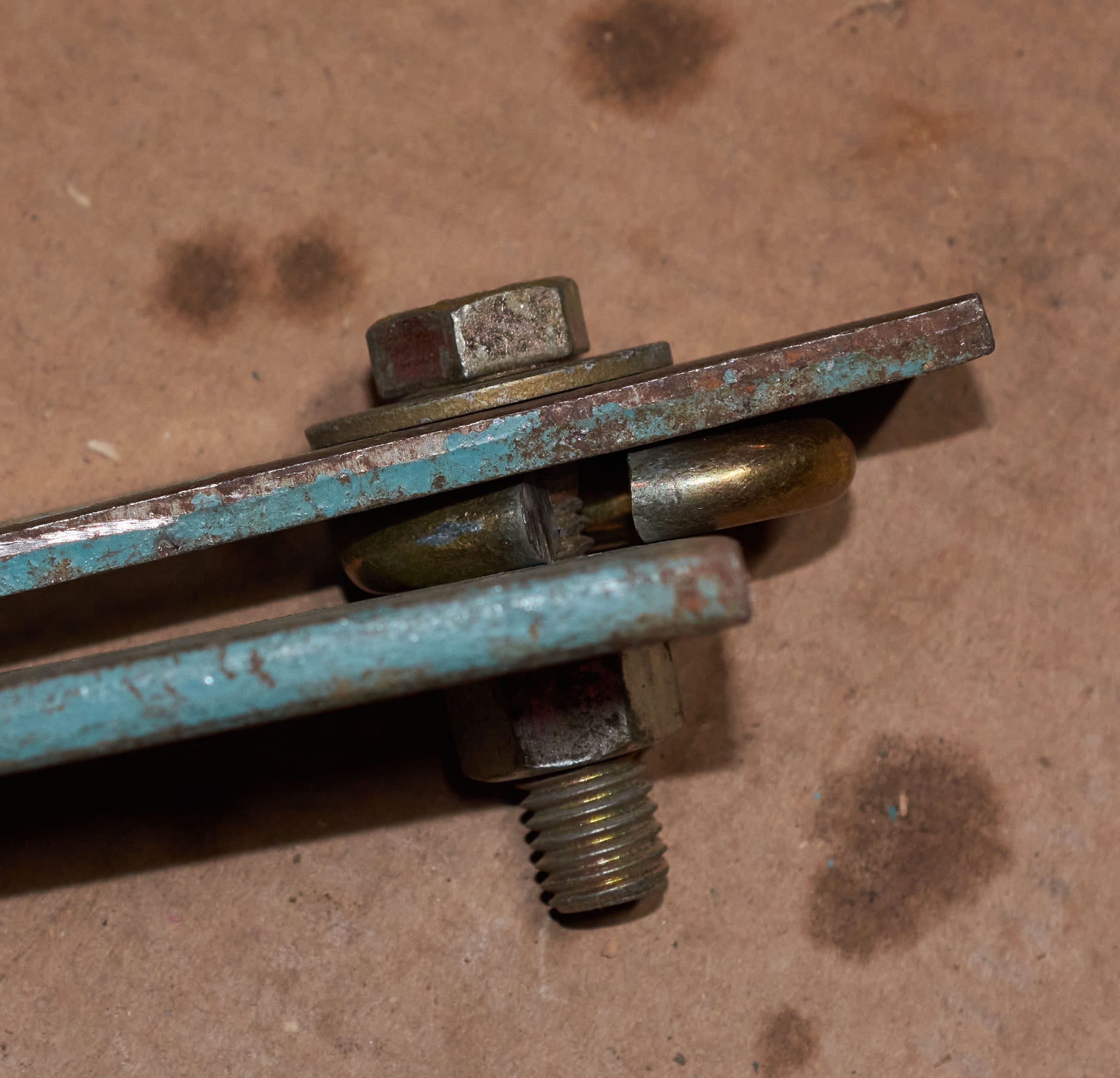

The Blades should NOT have been welded on. They are designed to pivot on the bolt that isn't there if they hit something. Personally I would have kept it as found.
/ Brush Hog mods
#40
WE DID NOT weld the blades on. We FOUND the nuts welded on so we could not remove the blades without cutting the pivot bolts which we found unnecessary for our immediate needs. The Blades still rotate.
I hope this helps
