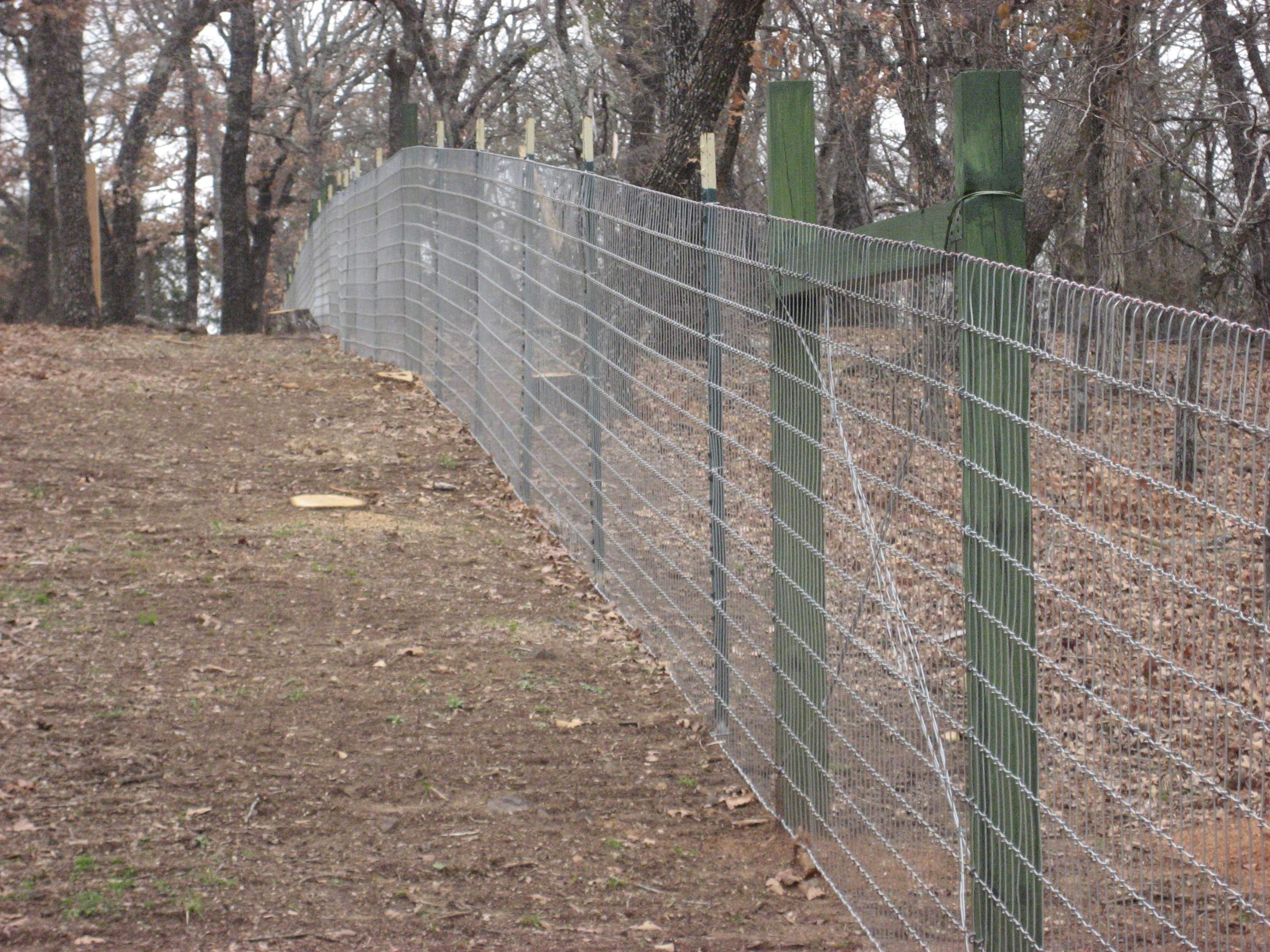

Both the pilot bit and the flight cutting edges probaby need to be sharpened fairly frequently. If they are too worn, they need to be replaced.

What about just adding some weight out on the end of the boom? I'd make it easily removeable in case you have trouble lifting a stuck bit out of the hole.

The bit shown is double fluted. It has about twice as many cutting spirals as mine, and the pitch is flatter in order to accommodate the number of spirals. A single flute spiral is angled more toward the ground, less flat. It might bite better for you. Kinda like a fine threaded screw vs. coarse threaded: fine thread holds better, but is harder to start.
You can buy replacement tips and cutting blades at TSC. But yours looks new, so I doubt that is the problem here, unless it was improperly installed. Still wouldn't hurt to sharpen the cutting blade.

I have a cheapo Fleet Farm PHD single flute model. The only problem I have had is if grass wraps around the starting bit I can not get it to even start digging. Other than that it digs fast no matter if its clay or black dirt.

Actually I do sharpen my blades (wings/edges) often on the grinder. That was the first thing I noticed had gotten dull and worn to the sides. But, sharpening doesn't seem to last long. Then I thought maybe the blades were too worn down (short in length) so I bought new replacement Blades and a new End Tip (on the pilot bit) which was easy to replace. It seemed like it worked at first, but maybe I was hitting softer clay. After a while, again round and round but not down.
"Thavil", regarding the action of my PHD when drilling clay, I do try bringing it up and then down quickly to get more force and bite while keeping the auger in the hole. But that too helps very little with my clay. As a side note, found this good video clip (and other clips) on Everything Attachments:

"skyco", also thought about adding weights to the boom. I'd have to rig something, but what a hassle for each hole. The Down Force Hydraulic Attachment adds 550 lbs of force. Imagine adding 300 lbs of weight manually each time? At one point being frustrated, I jumped off the seat (tilted it to keep the engine going) and tried to push and hang my weight on the boom. Then thought what the _ am I doing? Not too smart.
"Gittyup"' that really makes sense!! Mine with more cutting spirals and the flatter pitch doesn't help grab as much as a single flute spiral-steeper pitch would. (fyi the picture was taken when I first got the tractor new).
I will check out getting a new Single Flute Spiral Auger first, because it's much cheaper than the Down Force Hydraulic Attachment. Just finished this project (1600' of fencing) but will have another project in a few months at another property. Need to check the soil before I spend more $ on a new Auger and/or Hydraulics. Hopefully No Clay, cause that would solve the problem!
