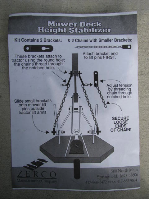

Does the Jinma 284 have functioning Position Control? If Jinma has Position Control do you know how to set it?
If tractor does not have Position Control ZERCO CHECK CHAINS are an option. Zercos have been around since the Ford 9N, 60 years, for holding up the front of implements, especially rotary cutters.
Coincidentally, your Jinma has almost the same horsepower and weight as the 1939 Ford 9N, although that has nothing to do with whether the Jinma does/does not have Position Control on the 3-Pt. I always see Jinmas described as "basic", so I am asking, rather than assuming.
Search T-B-N for ZERCO.
There are 16 threads covering check chain/ limit chain situations and hardware.

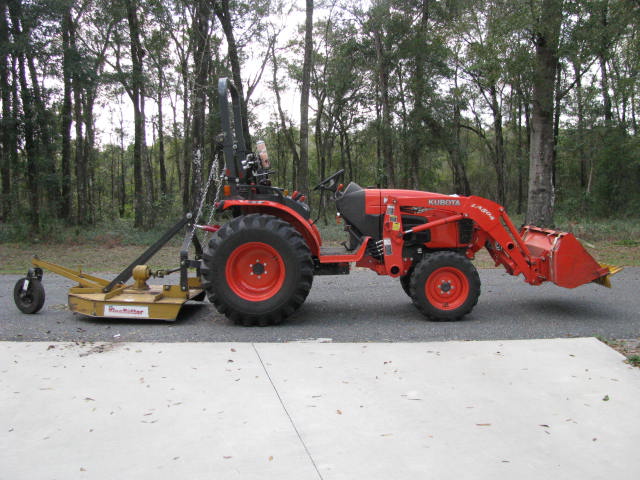

This the small bush hog that came with my B7500. It has chains built into it, between the top link hookup and the frame. It might not work in a bigger mower, but it keeps the back from digging in going over rough ground.

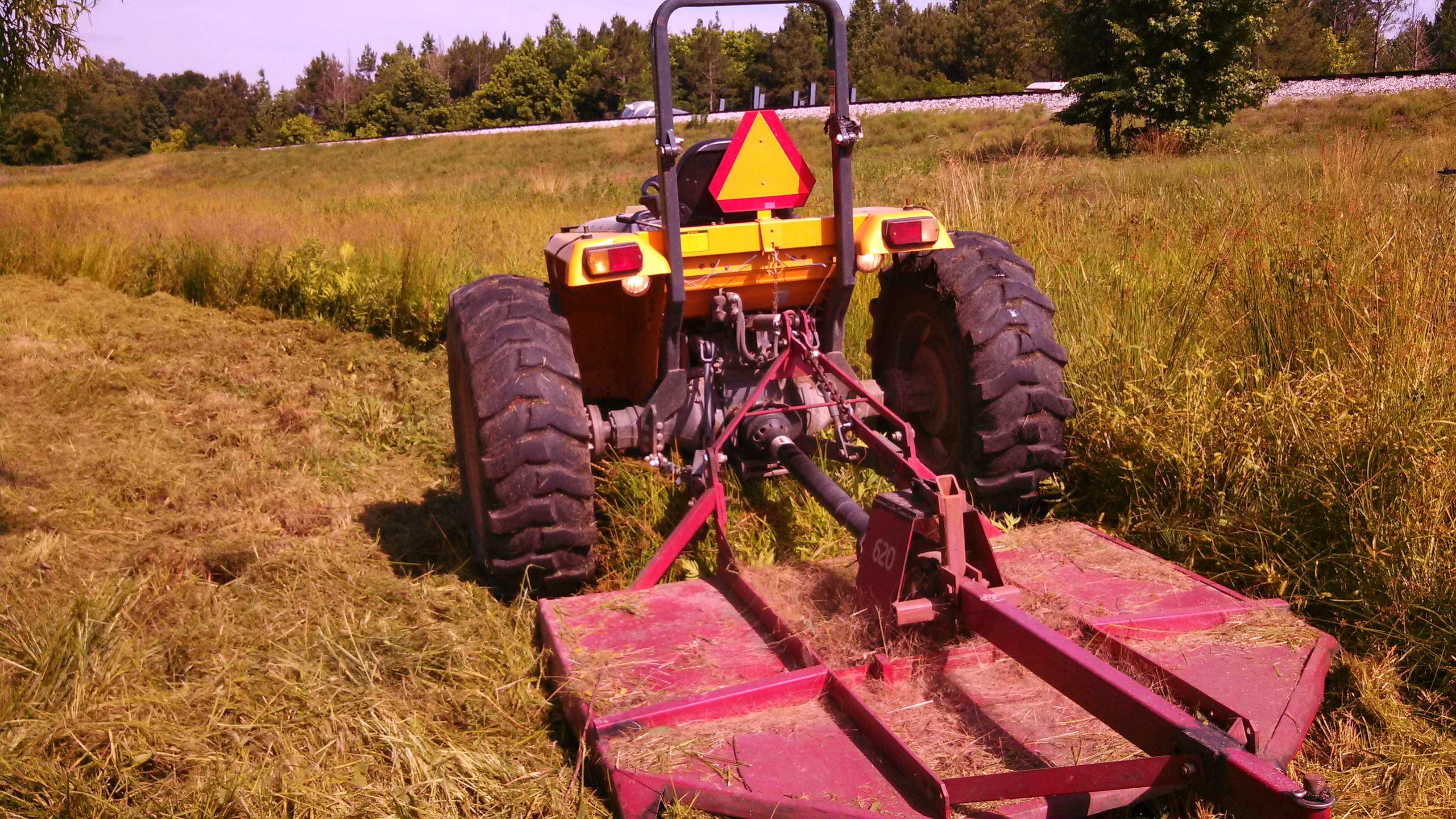

My cutter came from the factory with a chain as the link between the TPH toplink and the rear of the deck. Since my tractor does not have position control, I installed the Poor Man's Position Control (PMPC) to set the front height to avoid gouging and maintain a consistent cut. Works like a charm. The PMPC came from my scrap pile...as TBNer Renze says "free scrap is a good investment".
