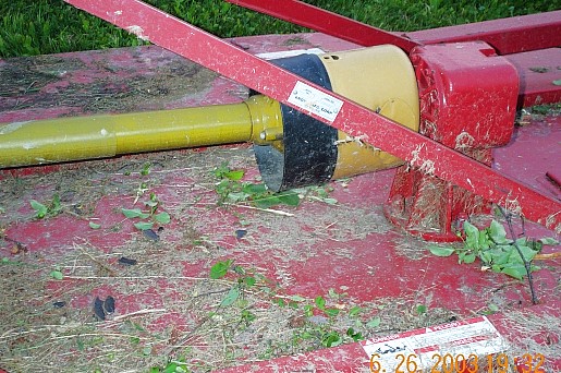

Well, I did a number of "tree" removal tonight...
One secret of success is don't get carried away, while "grinding" these things up with the brush hog... you must let the "slip clutch" assembly "cool down" after each tree.
On my present cutter, I have a 4-plate clutch assy... but tonight I was just about done and figured I would do this last little cluster of trees that have been in the middle of this one field for the past few years...
I cut 3" material all the time... so tonight I tried it again... but there were 9 - 3" trunks in a cluster... /forums/images/graemlins/shocked.gif
now I have a 3-plate slip clutch... the 4th one burned up in a puff of smoke... and that cluster of trees is now laughing at me... /forums/images/graemlins/wink.gif
(note the little black pieces of clutch material on the deck)
   / Brush Hogging Basics... #54
Re: Brush Hogging Basics... Tree Removal
Could be worse John. It could have been a gear box, or about 50 shere bolts. /forums/images/graemlins/grin.gif

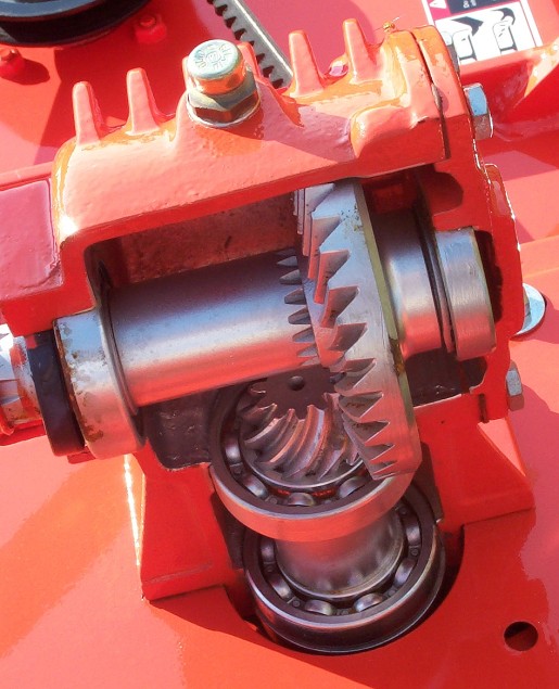

Re: Brush Hogging Basics... Befco Gearbox Cutaway
Befco Finish Mower Gearbox
Keep an eye on this mfr... excellent quality implements...

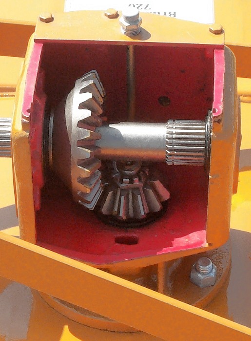

Re: Brush Hogging Basics... Woods Gearbox Cutaway
Woods 720 Gearbox

Great pictures! Now this is what we should see before making that equipment decision.. I wonder what they'd look like after 1000 hours of work?
