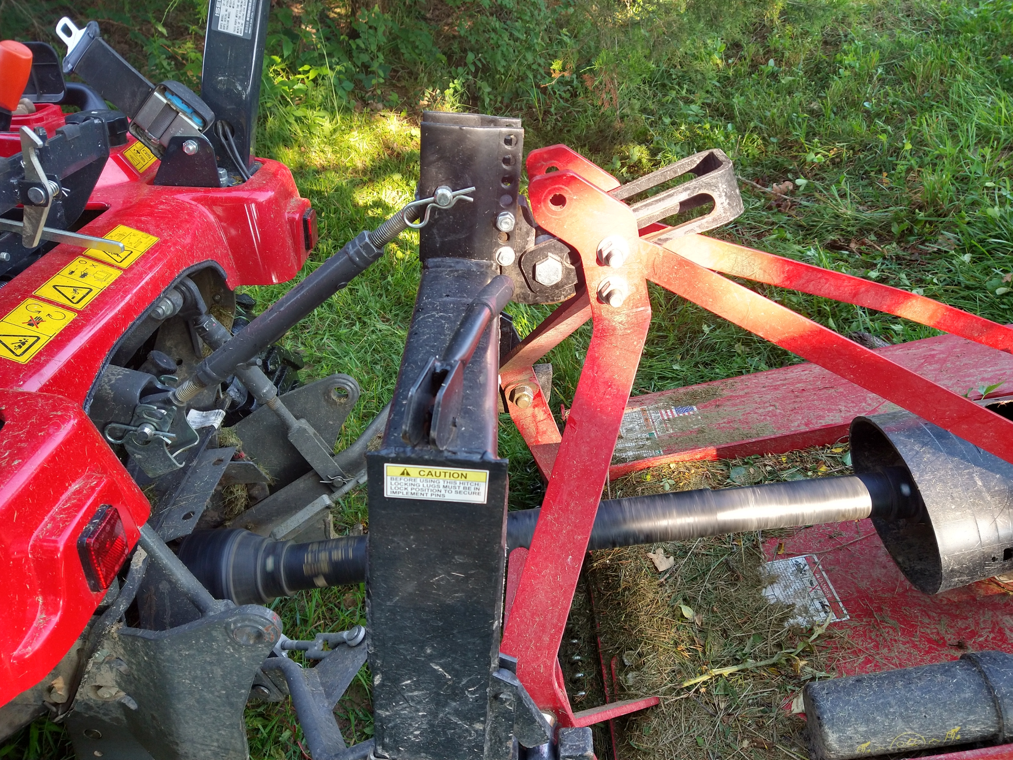

I don't have Woods, but ... Both my Bush Hog rotary cutters came with what I call a "floppy link" it has an oblong slot that allows the top link to float to some extent, very helpful for such a long attachment that you would prefer to stay on the ground, but also not jamb up into the back of your tractor ...
I got the optional front chains, and slip clutch ... Don't know if others have blades that have "lift" but both mine did!
It's 8' long!
Kinked up as tight as it will go, as I back down into a valley ... At this point the three point can raise a small bit ...
Topping a hill, like this, can cause the tail wheel to come off the ground ...

Have an SQ600 5 foot, has a floppy link also. Makes big difference on uneven ground keeping tail wheel planted on ground

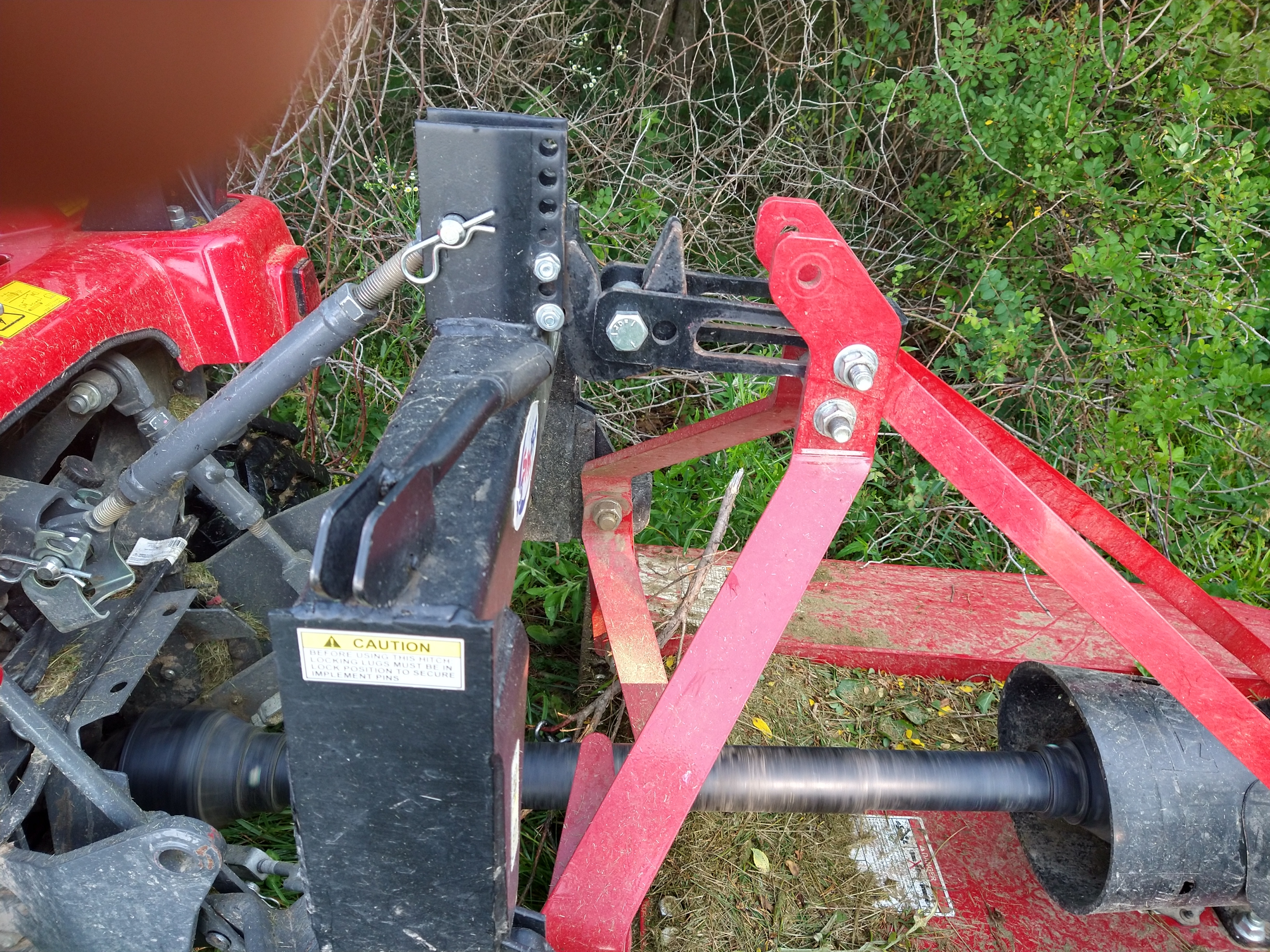

I always wanted a Woods brand cutter so I got a BB72.30. It has a system that functions like the “floppy link” on the Bush Hog above. Mine has a slip clutch and chain shields as well. Makes a very clean cut, like a finish mower - if the weeds are not crazy tall. The other thing is it has a cover instead of the hole in the deck like the one above to access the blades, and most important it uses pins instead of massive bolts to hold the blades on - that way to change them you only need to torque a small bolt to 40 foot pounds rather than the ridiculous 600 foot pounds on the big ones.
