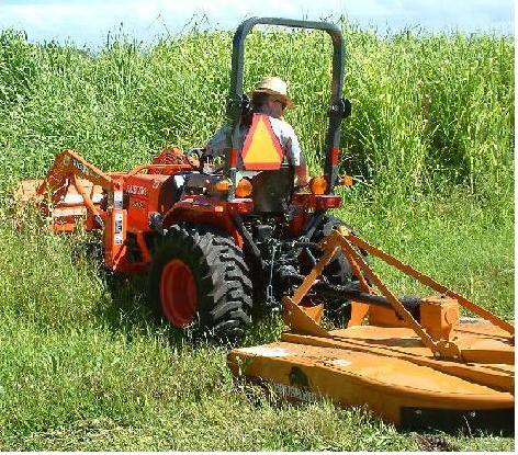

The attachment shows how I spent the better part of 2 weeks last summer. It's called guinea grass, and was 12' high in areas. And very dense.
It was slow going, but I have found that anything my tractor can drive through, the 60" Woods standard brush hog can cut.
   / brush hogging - how high is too high? #20
Pretty impressive picture!
How many acres did you have to do?
My first use of a cutter was through tall stuff like that...and you're right...slow going!
