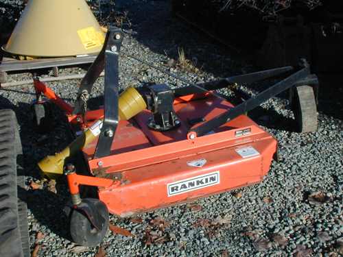

I like Highbeam's setup that MrSteve posted. It's a slick setup since you can adjust the height of the front wheels.
http://www.tractorbynet.com/forums/attachment.php?attachmentid=53888&d=1145462448
I also like IslandTractor's idea of mounting the wheels directly to the sides of the RC. I would think this would be a simple way of preventing the frame dig-in and you could probably do it without welding anything (for those without welders). Definitely post some pictures if you decide to do it and let us know if it works.

I have purchased the chain, turnbuckle and connectors and will put one together this weekend. The potential problem I see with my BushHog 480 Squealer is that there is no place outboard of the pins to attach the chain to the mower in a way that does not leave the chain interfering or at least rubbing against the 3PT arms. So, I won't have great "leverage" but it may still be perfectly adequate, we'll see.
I had thought carefully about using wheels which would not need adjustment if you attach them directly to the front sides of the mower in such a way that they extend below the mower just a couple of inches. A 10" pneumatic wheel, a 5/8 x 5 inch bolt and some washers as well as a block of wood as a spacer is all that would be necessary (and a 5/8 drill). Downside of the wheel set up would be that the wheels 1) stick out 4 inches and are outside the wheelbase of the tractor so could get hung up on obstructions, 2) they prevent you from dropping the mower to it's very lowest settings, and 3) they would take the weight of the hog when it is off the tractor so for storage you'd need to block the hog up to avoid that.
In the end I've decided to give the check chains a try first as it seems the simplest to do. KISS.

Yep, but they shouldn't be touching unless the deck is tilted and if it is tilted then only one wheel would be on the ground. It would be fixed rather than pivoting so it could scuff a bit but again only if the deck was trying to plow (which is what we're trying to prevent).

Doesn't look like you are accomplishing anything then, with a fixed wheel.. what's the difference in the deck plowing.. or thew wheel plowing.. If it was a caster wheel.. at least it could spin and not plow.

Well, a fixed wheel might scuff a bit in a tight turn but wouldn't really plow.
However, here is my update on the check chains: I installed check chains today. Due to the configuration of the Bush Hog 480 Squealer mower and the geometry of the 3pt arms on the CK20, I could not install chains as far outboard as I had wanted. In fact I had to install them essentially directly under the pins. Nevertheless, I did put the chains on and used a turnbuckle to tighten them to the point that they were carrying some of the weight. I then tried out the mower set at 4 on position control which puts the skids on the mower sides about one inch off the ground. I made three sharp turns at mowing speed (low gear) and plowed on two of the three turns. Not good.
I could raise the mower but that is what I did without check chains to prevent plowing and that gives me a minimum cut height of about 5 inches which is a bit more than I wanted. I did the mowing at dusk and did not get photos so I'll try to get some tomorrow AM to show my check chain set up.
I have been very happy with the Bush Hog as a brush hog which was its initial purpose. I was hoping to use it to maintain the area after clearing but unless I can conquer this plowing issue I am going to move on to plan B which involves a Caroni flail mower. I need to make a lot of turns around bushes, trees and rocks on a gently sloping former pasture so it may just require a different mower style.
