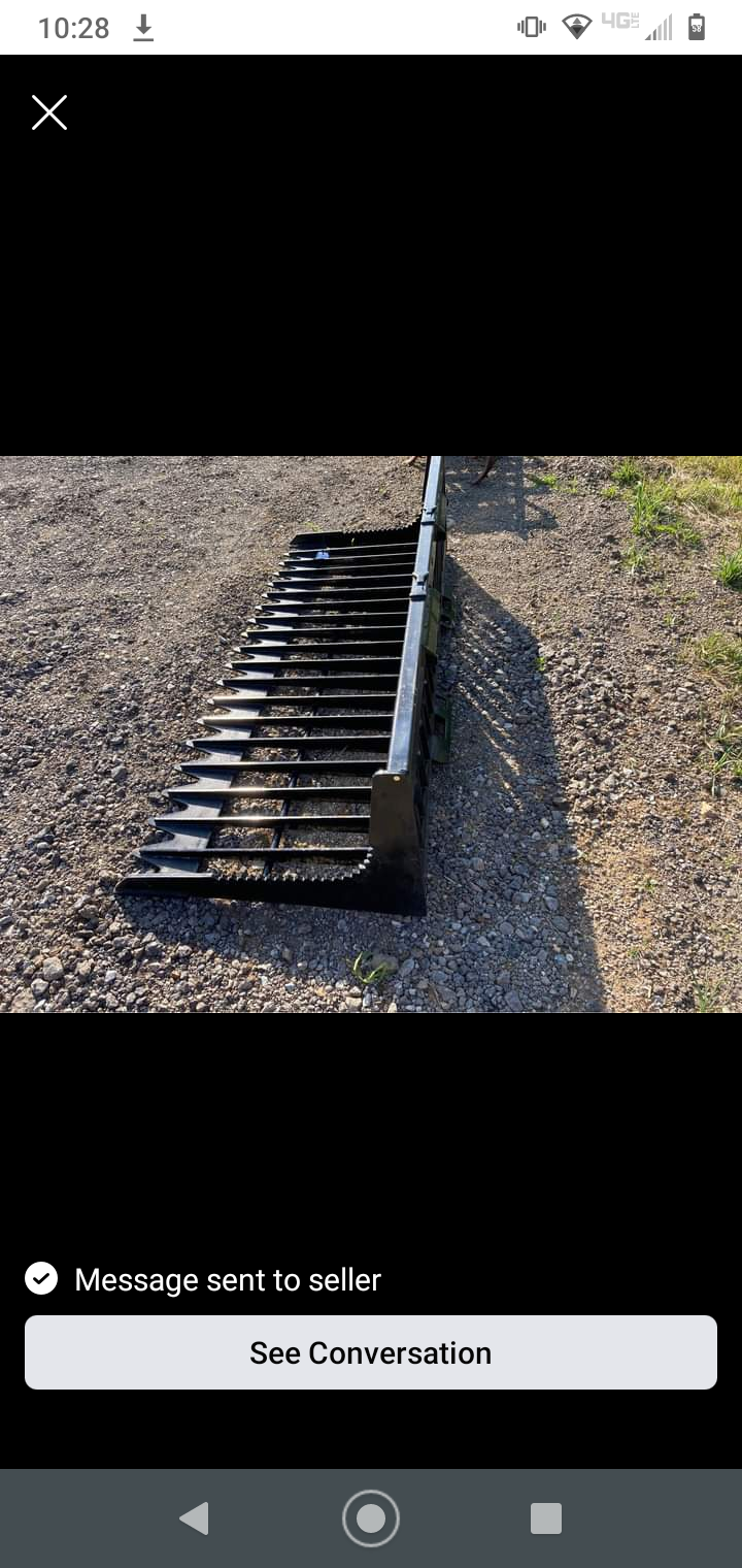

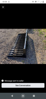

Hey guys, does anyone know of a debri/brush bucket for a compact tractor? I was going to install a third function and do a grapple but that's really overkill and i don't have the time to do it. I just want something with a low profile side but would allow me to scoop up logs/brush. I saw there are brush forks and clamp ons to buckets but it seems that will damage my main bucket. Attached is a picture of what I'm looking for.
Thank you!

with forks will work. Split firewood, go with rock bucket
/ Brush/Rock bucket? #3
Try googling "brush bucket or rock bucket". I'll bet there are dozens of after market bucket manufacturers - one has to make something like what you want.
A quick search, I found - Tomahawk attachments, Titan attachments, MDS manufacturing.
/ Brush/Rock bucket? #4
Round tines pick up less dirt than box tines.
I suggest 24" length.
/ Brush/Rock bucket? #6
I sold mine. It was a typical skid steer rock bucket, 72". Don't get one of those unless you really have a strong loader. Mine was great for hauling brush, tree limbs. Could really pile a lot. Absolutely would not separate rocks from dirt though which was primary reason i wanted it. Tractor hydraulics just too slow and start jostling that much weight extended out like that and you quickly see it will beat the crap out of the tractor. An oversize pallet on pallet forks would be almost as good without the expense.

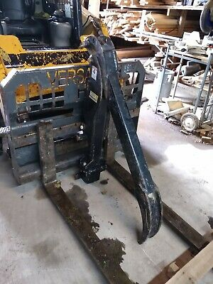

This what I am after (without the oil leak lol)
Great for boulders, logs, large brush, broken hay bales, etc
