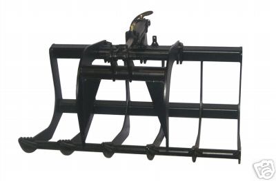

I've been looking for a grapple for my Bobcat CT335 tractor and came across these grapples made by ANBO for compact tractors. ANBO Manufacturing - Rock, Root & Tree Grapple GR-M I was wondering if anyone out there has had any experience with these units. I noticed that their weight is quite a bit less than most similar units I've found, but construction wise they seem very similar to others.
You need to think about whether you want a clamshell or standard root grapple style. Anbo's are clamshell. They seem to be optimized for driving into brush as far as I can tell. The standard root grapple is distinguished most easily by the fact that it can carry a load even if the upper jaw is open. Clamshell grapples cannot hold anything if the upper jaw is open. The clamshells are also typically made with identical width upper and lower jaws while standard grapples have either one or two top jaws and they are usually not the full width.
Most companies make one or the other style but WRLong has both types. I think they call their clamshell a RBG or something like that and the standard type is called the OBG or something like that. Easy to see the differences when they are compared.
One other point, the clamshells are almost always more expensive.

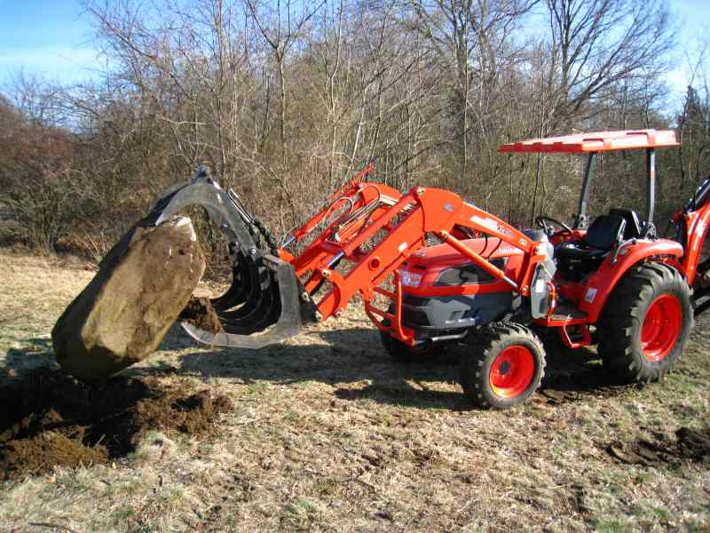

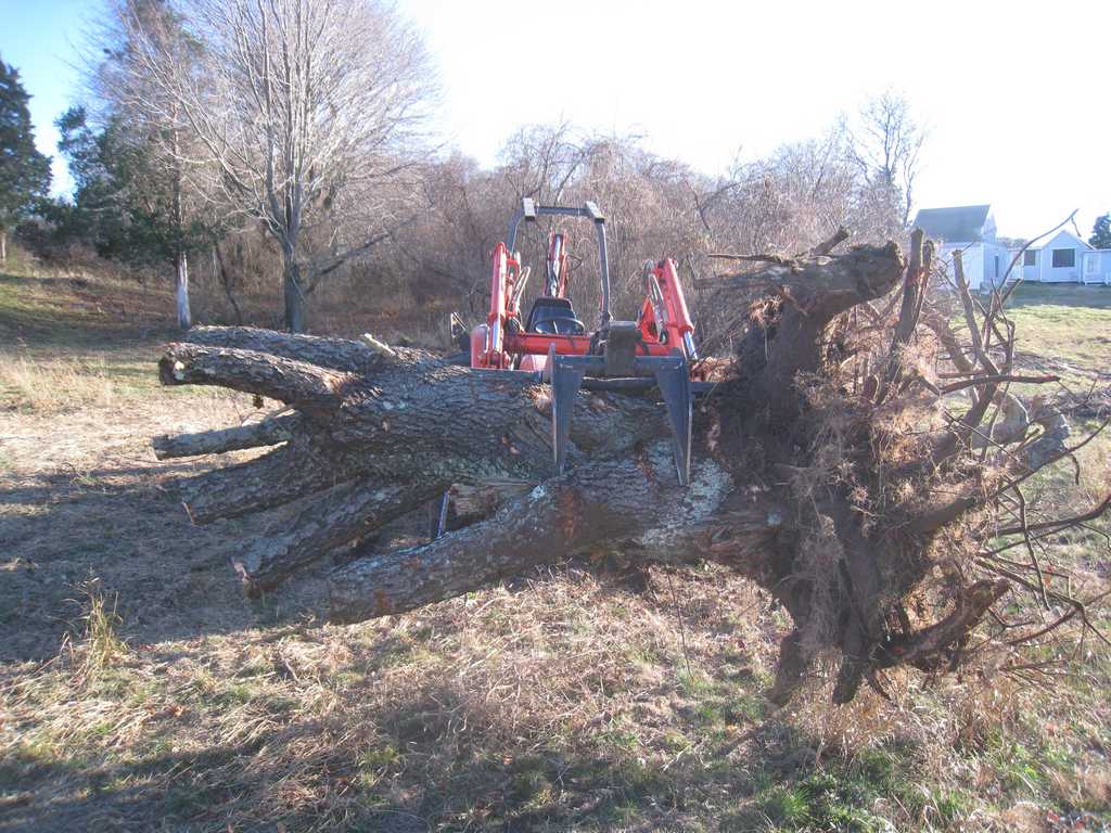

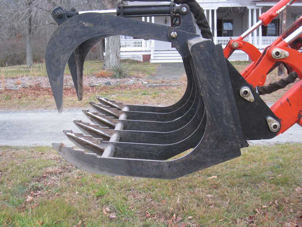

My grapple cost me $500. It weighs 280lbs and is constructed of 3/8 inch mild steel. It is no longer made as the owner of Millonzi died and they went out of business. Five years later it is going strong after doing LOTS of work and being mounted far more than either my standard bucket or 4n1.

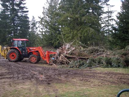

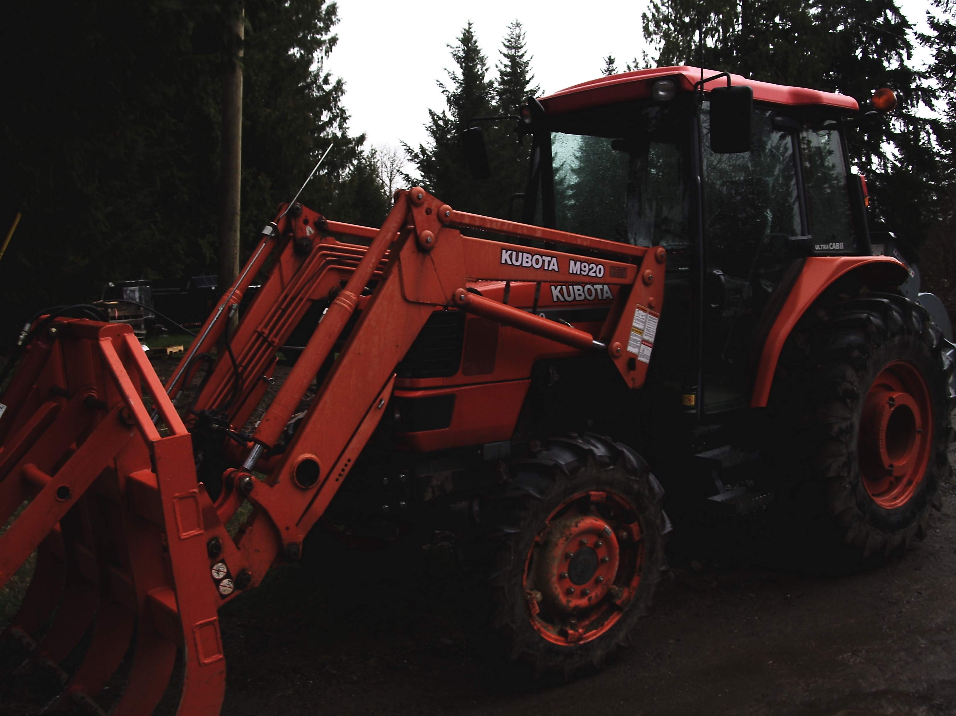

Hi
Here is a picture of a grapple that I built for my M6800 Kubota I used plain 1/2 inch plate and had the steel supplier cut it out from a pattern I supplied. I would guess that I have about $1200 into it. Mind you the sand blasting and painting was done for free. I must confess that it was not my design. I looked at ones on the internet tractor suppliers and sort of extrapolated the grapple size to the tractor size and then built my own. I used hard surfacing rod and built up the tips so they wouldn't wear to badly. So far it has worked beyond my wildest dreams and has been in use for about 3 years.
   / Brush & Root Grapple #26
Yeah, that's a beauty!
   / Brush & Root Grapple #28
Thank you all for the compliments. There was a lot of head scratching and some bad words but in the end it was all worth it.
