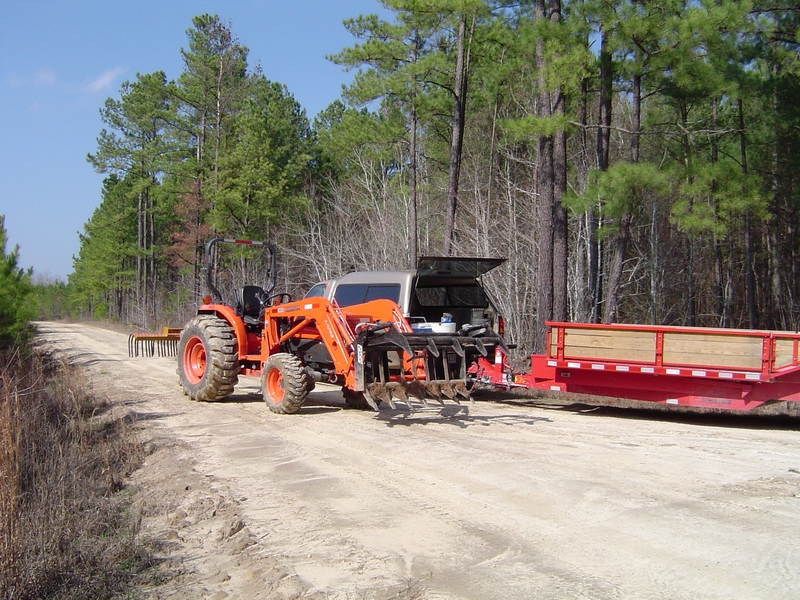

Everyone likes whatever grapple they get. I see that as a reason to get the lightest cheapest grapple you can find as it will do the job and give you the most net lift capacity as well as impacting your wallet less.
My grapple cost me $500. It weighs 280lbs and is constructed of 3/8 inch mild steel. It is no longer made as the owner of Millonzi died and they went out of business. Five years later it is going strong after doing LOTS of work and being mounted far more than either my standard bucket or 4n1.
