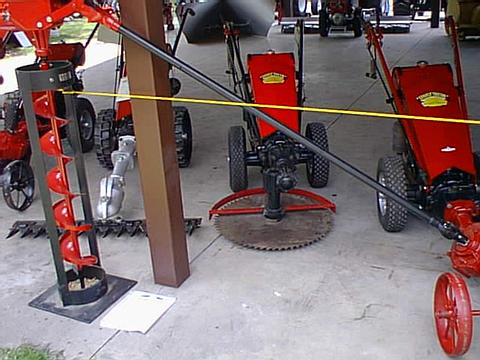

This is the way Gravely used to deal with brush. Note the attention to safety in design /w3tcompact/icons/crazy.gif. You don't have to ask whether you can still find something like this on the show room floor.

That is a pretty serious looking weed trimmer(to say the least)I never seen a Gravely with one of those.I would say it could wade through about anything.Gravely tractors are tough.A lot of people had those when I was a boy.

bigpete....where did that photo come from?! Is that your gear? Man, we have been a gravely dealer for over 50 years, and those models are in incredible condition! Love the photo. Saved it, gonna show da boss, he'll love it!

Isn't that what the Gremans used in WW-II?
NASTY LOOKING!!!
