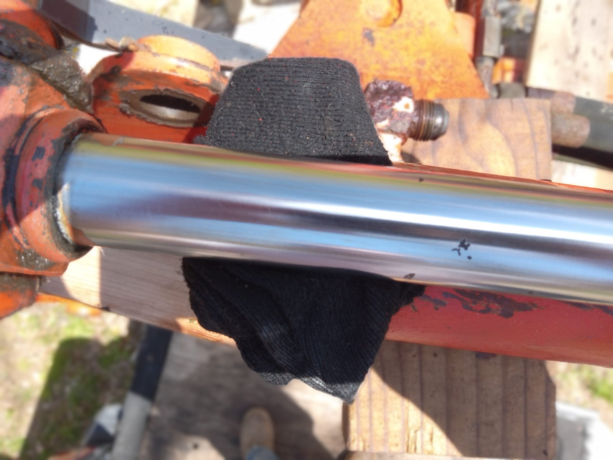

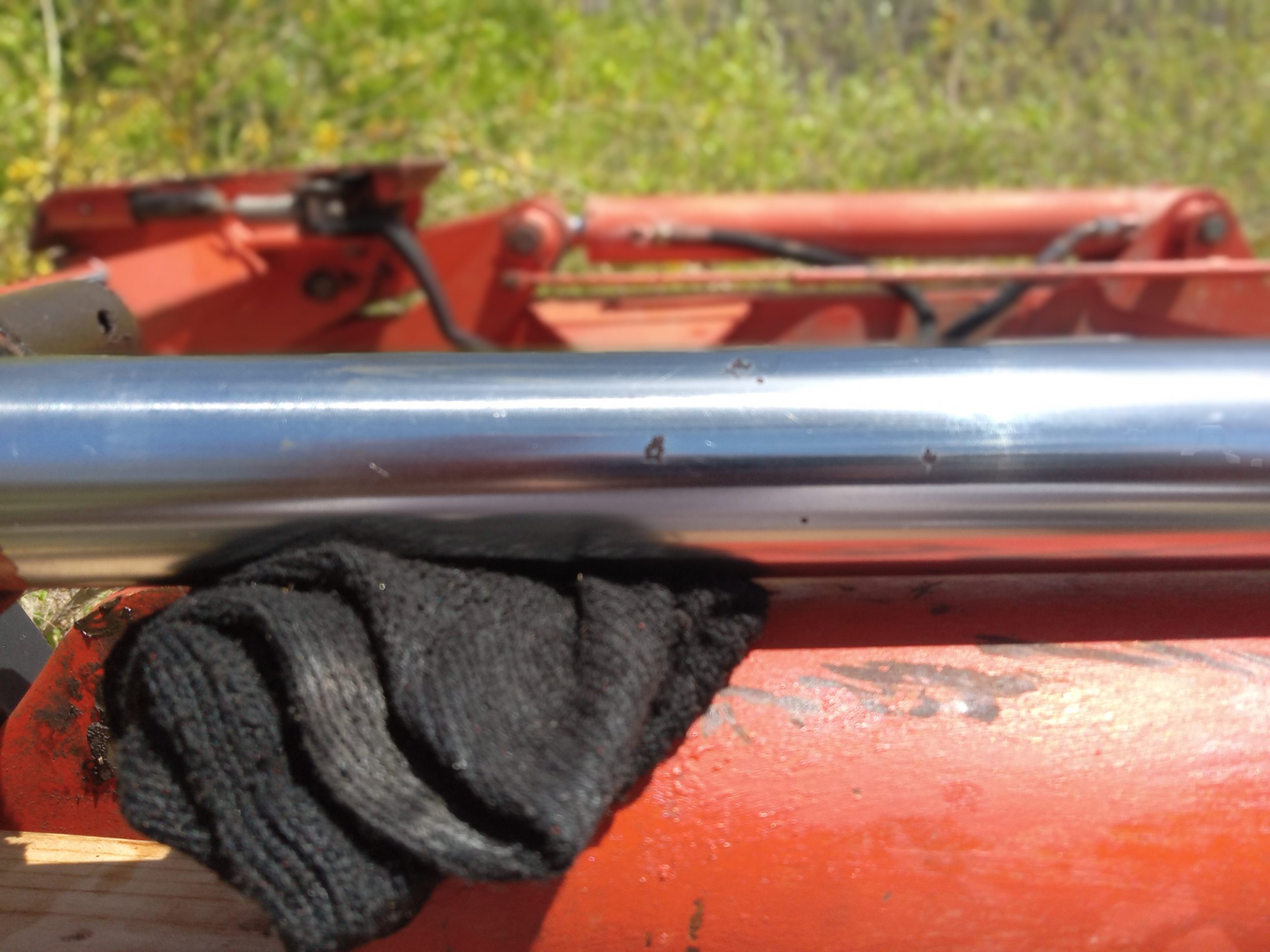

Im working on it today. This is what I think caused the leak. What should I do just sand ti a little to get rid of the sharp edges?

I stoned it just a little. I would think there is a better way.
   / Bucket/boom cylinder packing #19
That's about all you can do to save the seals. But it's still gonna leak everytime that passes the gland. Or worse if it's under pressure with the bad spot right at the gland.
Long term is have a rod made for it.
Just had one done on my 334 mini ex. Was about $300 from a local shop....but probably alot larger than yours.
Hopefully you can find a good shop local if you don't like the results of your stoning/sanding
#20
I didn't know you could have a rod made. I'll look into it. For now it's back together so I can do some work around here. It it's probably going to ruin the seals right up
