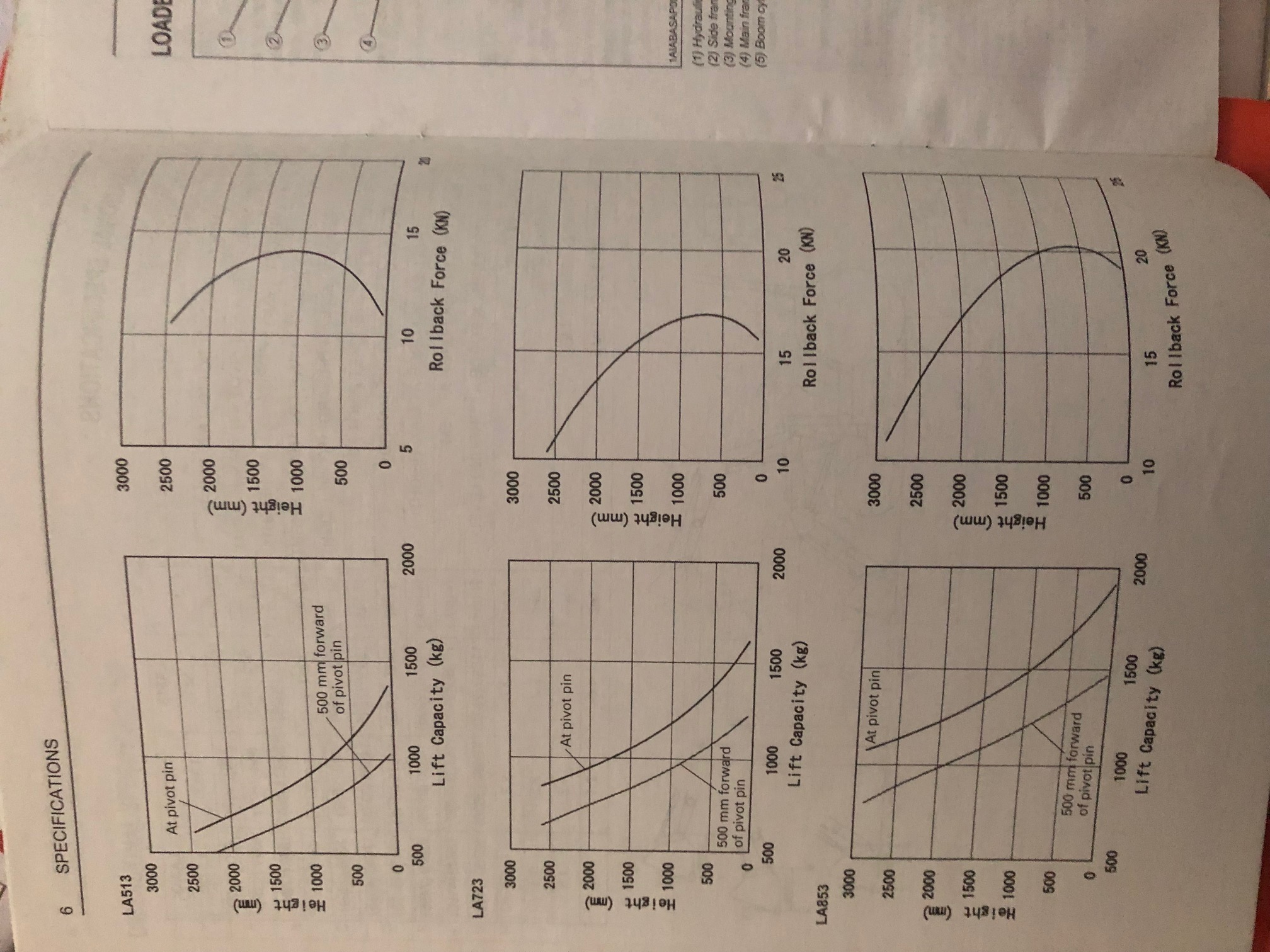

Can't speak for the FEL manuals for the B2650, but other FEL operator manuals included lift curves that might provide the information your looking for.
Perhaps someone with a B2650 FEL operator manual could snap a picture of the pages and post for you. (Assuming the curves are still published)
Example from my Grand L series tractor shown below for reference.
