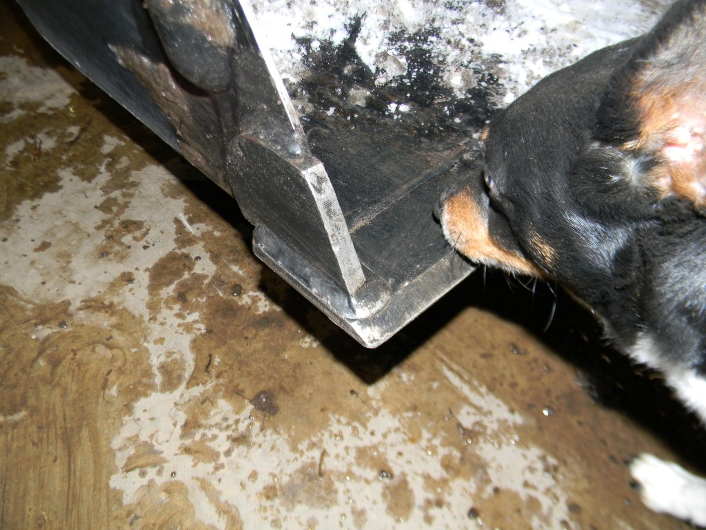

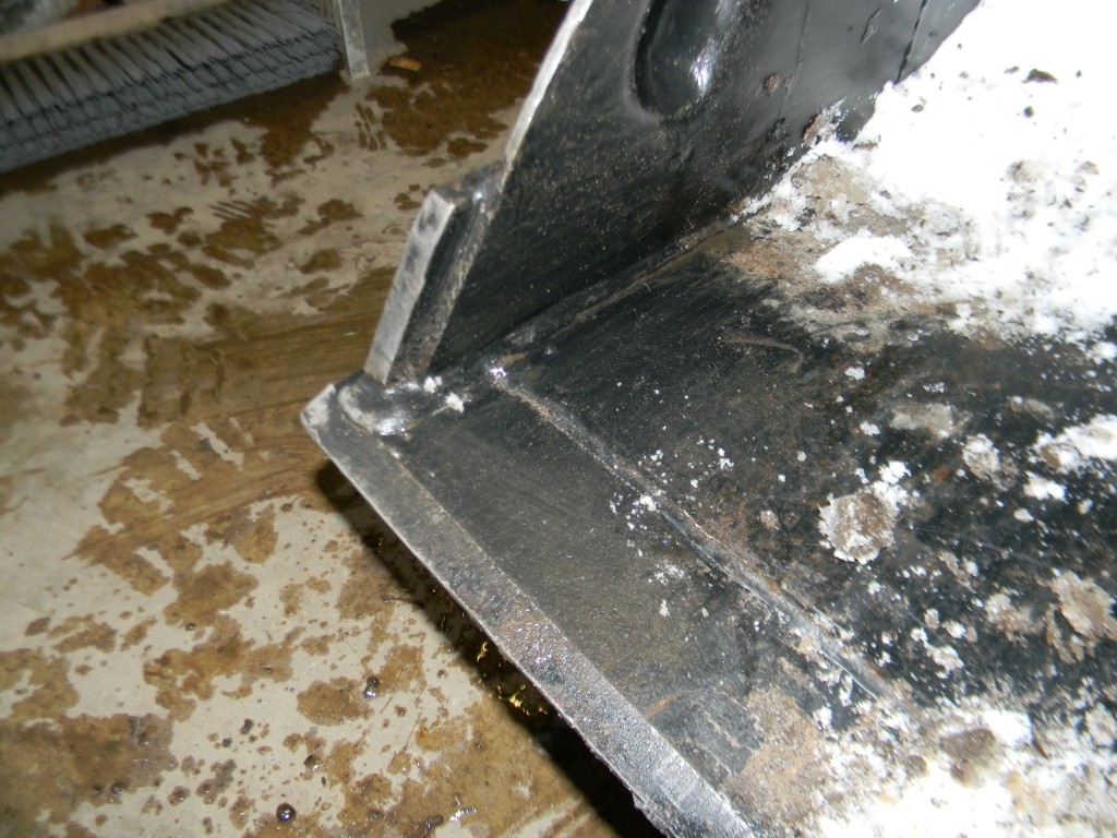

Replace your cutting edge flat across. No need to heat and bend up the ends. You can weld or bolt the new edge onto the existing edge. Measure the new edge the full width of your bucket and cut off the excess. A torch or cut off wheel will do the job. The upright pieces are for a wear edge when running the bucket along a curb. You can leave those alone. I would weld or bolt the new edge under the original.
Yeah...Uhhh No! Do it right. This is a shade tree hack job. The sides are supposed to fold up. A decent cutting torch head will do all the heating you need to bend the edges up. NEVER cut the side off, as that is a critical point for cutting when you are digging. Cut the old one out and weld it in if it is what I think it is.
   / Bucket Cutting Edge--Need Advice Regarding Replacement #12
This is a simple repair. Wash/Cut the welds off with a cutting torch or plasma cutter. Get a sledge hammer to knock the remaining welds off along with the cutting edge. Cut it into pieces if necessary. Check on the underside too for welds.
Nothing wrong with welding it fully. Grind the old part of the bucket, hammer it where needed to get the cutting edge to sit flat as possible. Clamp it on with several deep F style clamps and rig some thick flat bar to hold it on either side back to the bucket to keep it lined up if the clamps aren't deep enough. Tack it up on each end, then the middle, leaving the cutting edges flat on the ends first. Then weld it in. Skip weld if you want, but weld the whole edge up. A lot of dirt can get shoved into those cracks, not to mention water/ice and other materials and debris...so a relatively smooth continuous weld is preferred. When finished, take your torch and heat up the area, not a pin point area, but a wider area and pound it up into position. Clamp it while it is still hot, then weld it all the way. Repeat on the other side, and you are done. That's a nice little project that shouldn't take too long and is a gravy welding and cutting job.
   / Bucket Cutting Edge--Need Advice Regarding Replacement #13
Been a shade tree mechanic all my life and proud of it but I'm not a hack. After the OP said he needed to remove his old edge so his Piranha bar will fit, I would agree he needs to remove it. I still think heating and bending the edges up would remove the cutting edge blade hardness.
Or he should have bought a replacement cutting edge that has the wrap up ends from the factory.
Since he didn't, I would replace the wrapped up edges with the cut offs from the new blade and weld them on. Just my opinion.

I've welded many of those things on. That is how it is done. It is how it is supposed to be done. The cutting edge is supposed to be heated and wrapped around. Think about it...what you recommend is literally, by definition a "hack" job. You are hacking it up into pieces and rewelding it, contrary to factory procedure and intended functionality. This is simply how the factory does it. (wrapping the ends).
I've never seen a "wrapped end". That is why the cutting edges are sold longer than the bucket width.
But think about it, from another perspective. You are heating the bar up anyway by cutting it, and then again by welding it. What's the difference? I mean no insult, but what you recommended is completely contrary to how a professional would do it, and the end result saves no time or effort.
   / Bucket Cutting Edge--Need Advice Regarding Replacement #15
The factory cutting edge on my bucket is flat. It does not wrap up the sides. The side pieces are welded to the bucket and to the cutting edge. From what I see in the OP's first post, to me it didn't look like his ends are wrapped up the sides.
I know some companies do sell cutting edges the are already wrapped up on the ends but not all buckets are built that way. I too have replaced many cutting edges and have never ran across one that was wrapped up the sides from the factory. They were always separate pieces.

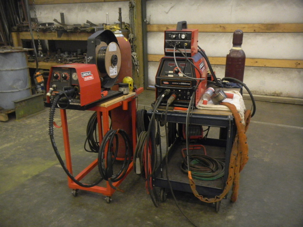

I've read where the welders with plasma and high frequency Tig welders have problems. I don't know anything about Everlast multi-process welders. I have a Lincoln V350-Pro multi-process welder.
