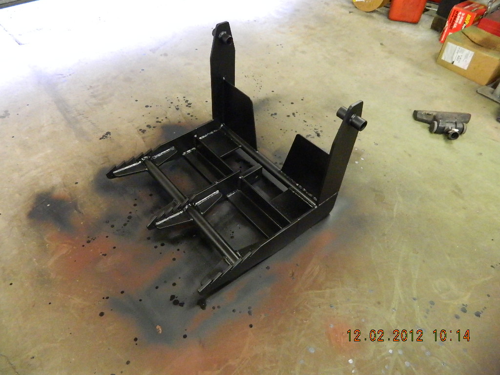

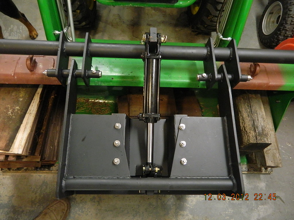

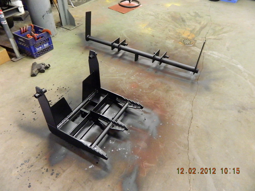

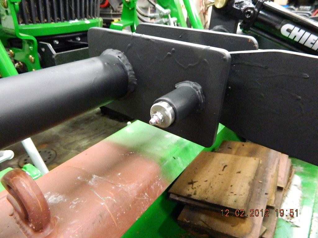

   / Bucket Grapple Project Deere 2320
#23

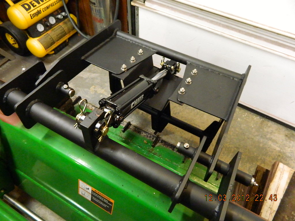

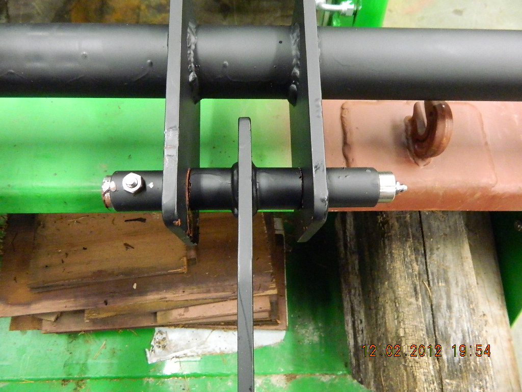

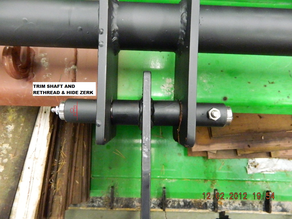

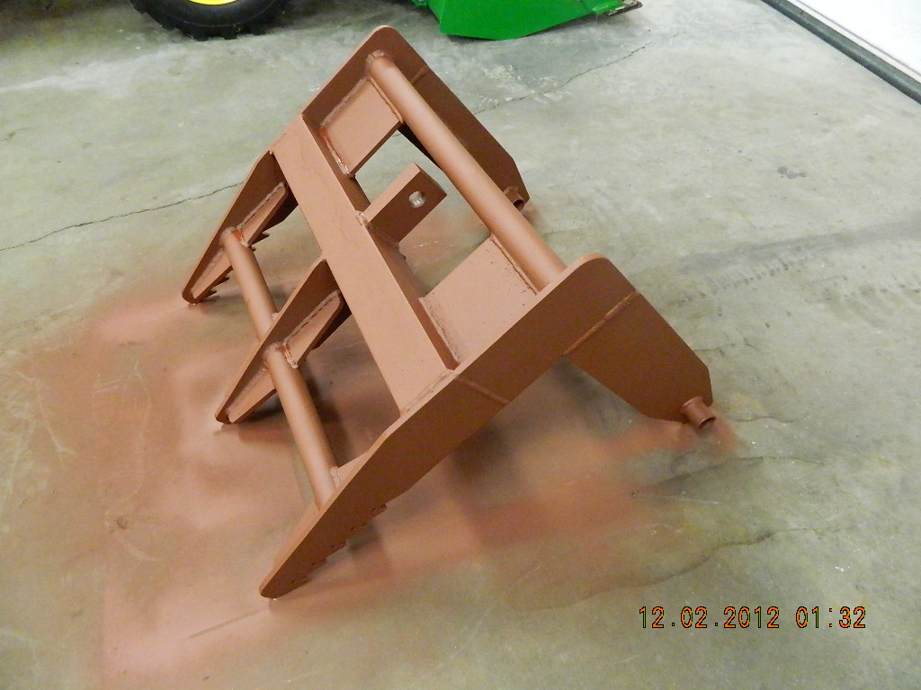

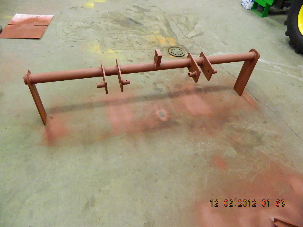

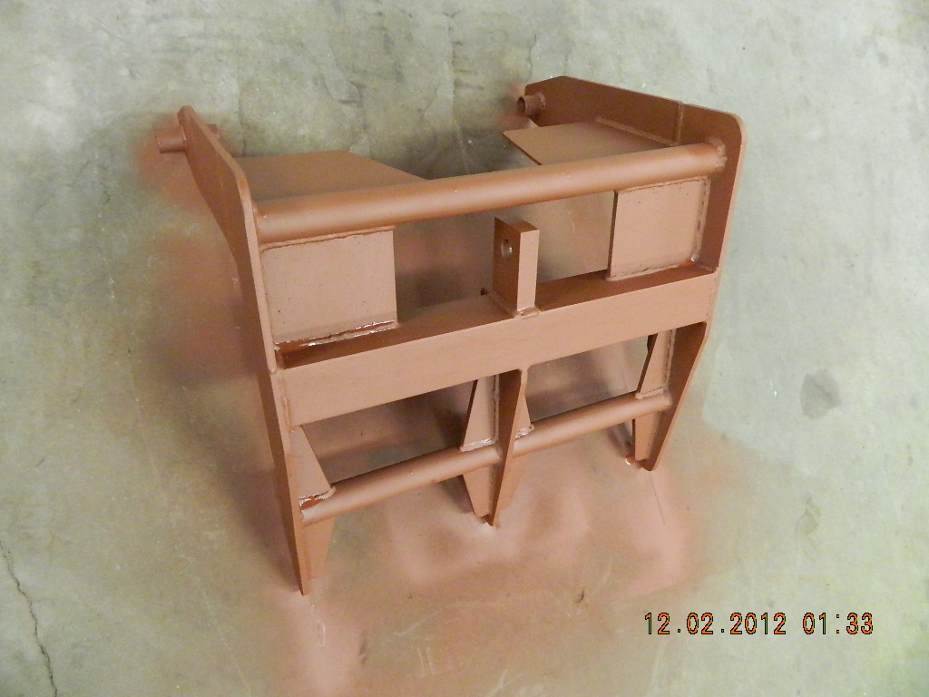

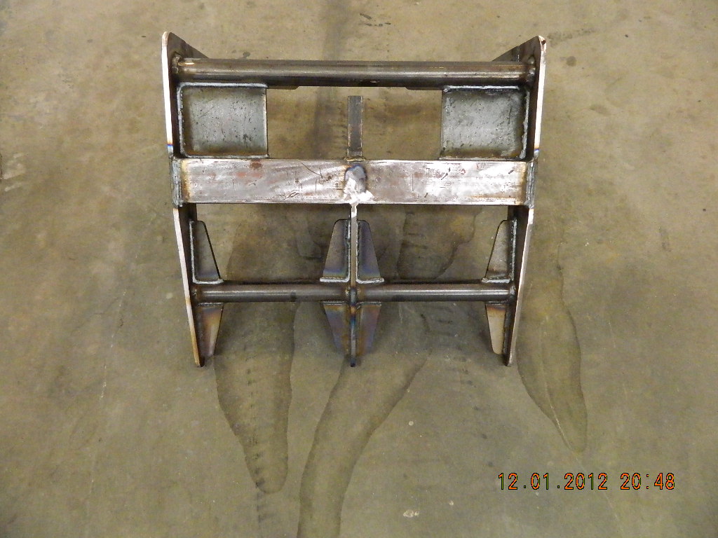

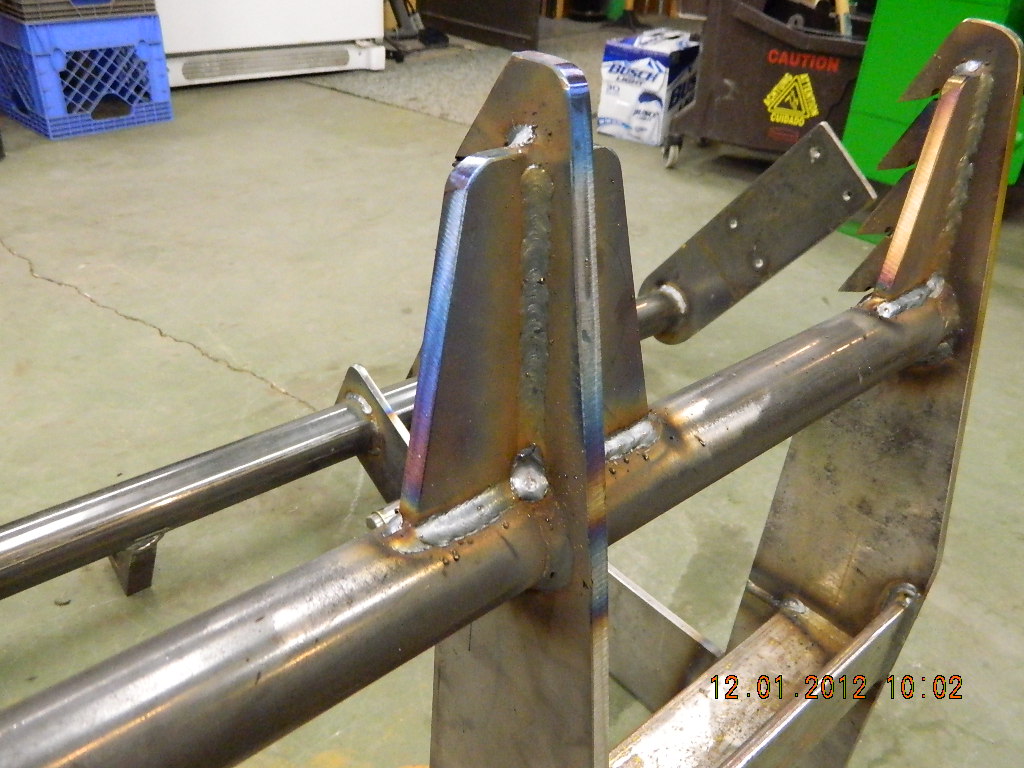

I finished one of the greasable pivot pins.
It is protected from damage now.
new tractor 583.JPGnew tractor 584.JPGnew tractor 585.JPGnew tractor 586.JPGnew tractor 587.JPGnew tractor 588.JPGnew tractor 589.JPG
   / Bucket Grapple Project Deere 2320 #24
Wow, nice work!
#25
Thanks !
I showed the wrong side/view of the pin in my photo's
